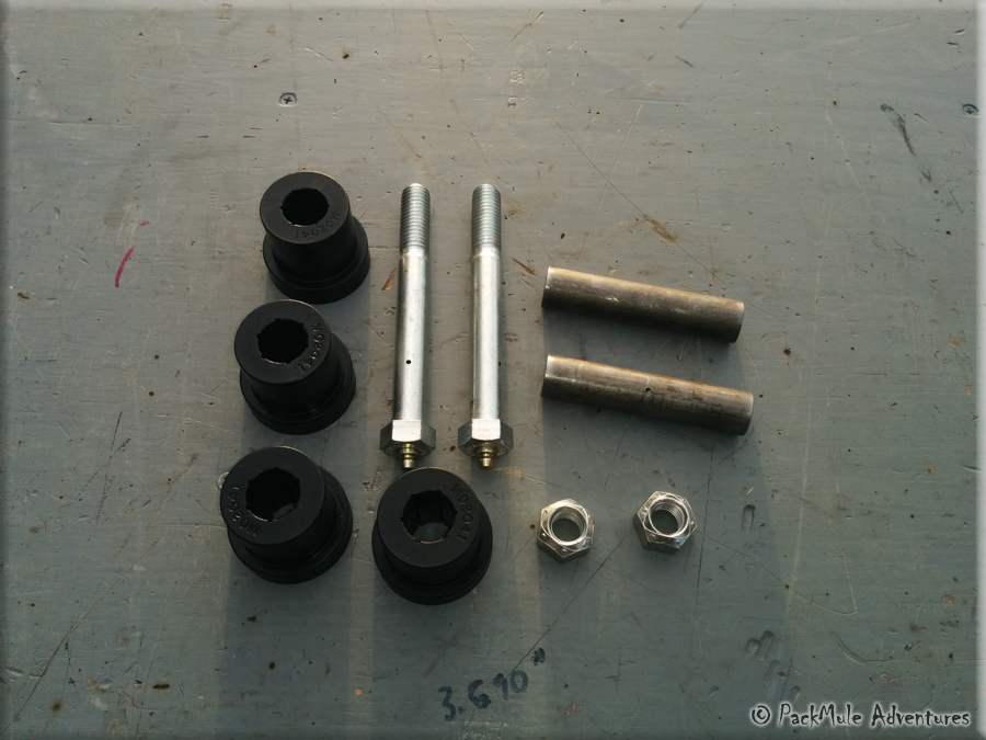

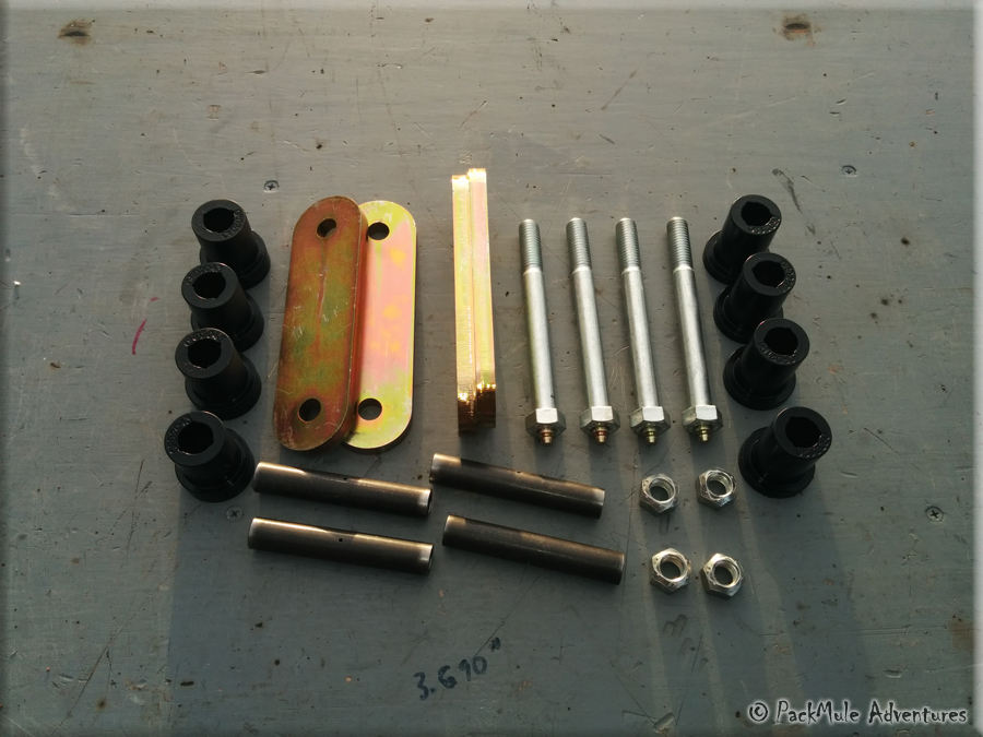

While you have the springs off.................. whats the inside measurement (width) of the front spring pockets?
I've been told it should be 3.5 but I keep hearing that the 88 and up are different.
I actually measure 3.5"+ but I would call it 3.5" If you want exact it was like 3-5/8" on the inside.

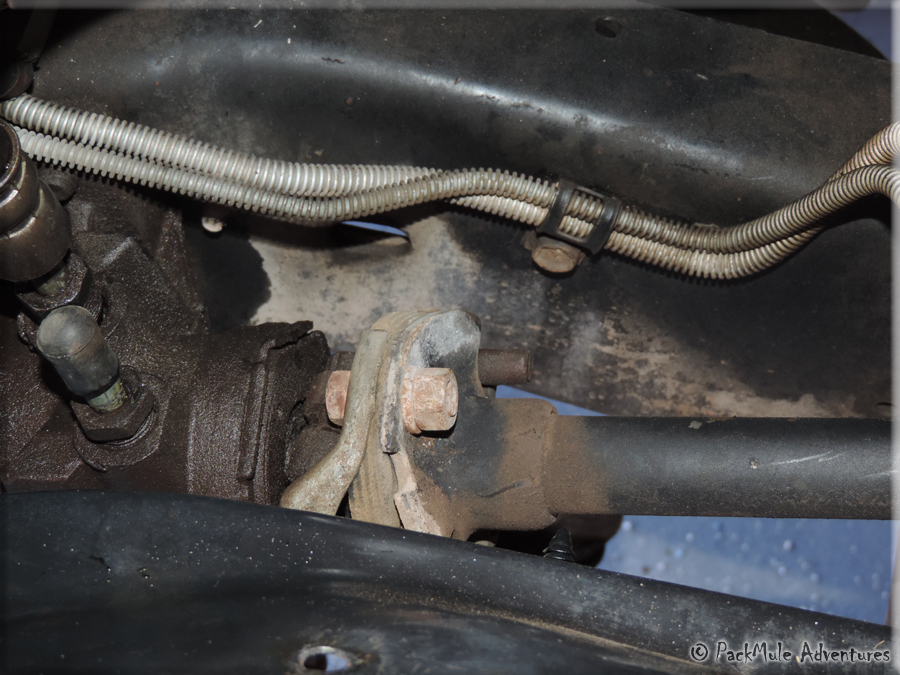

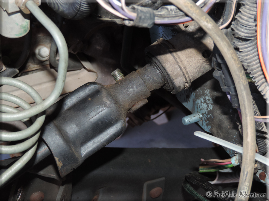

Removed the steering shaft this afternoon. Looks like the XJ shaft I have might be for the 97+ XJs I am stopping by my friends XJ shop tomorrow anyways so I will see if I can verify which is which.

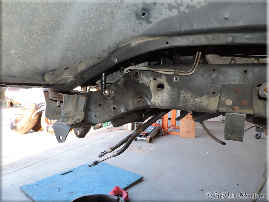

Gear box is out. I hope to starter cleaning the frame up for the weld in kit tomorrow.

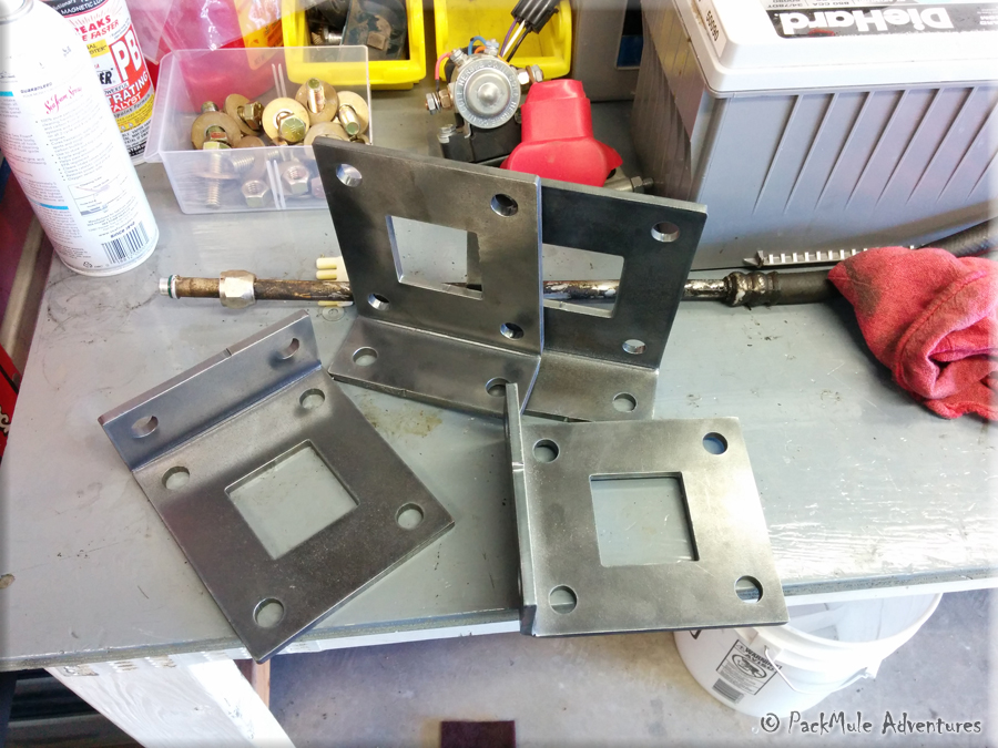

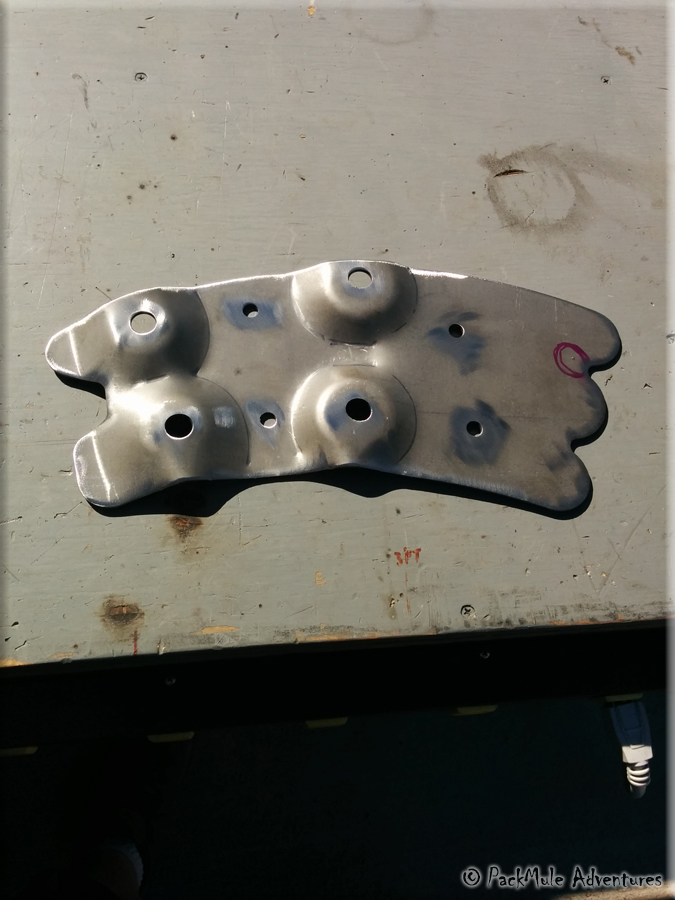

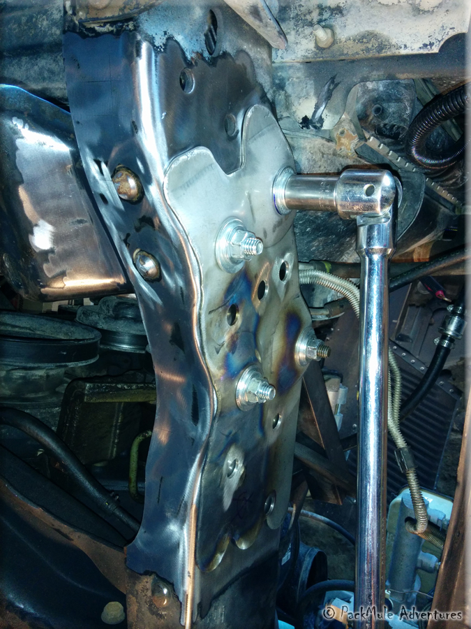

To the manufactures of this weld in plate. Would it kill you to take 30 seconds to deburr the edges left over from the stamping process? I think I lost about a pint of blood from a fountain gash.:whistle:
Plate kit can be found here

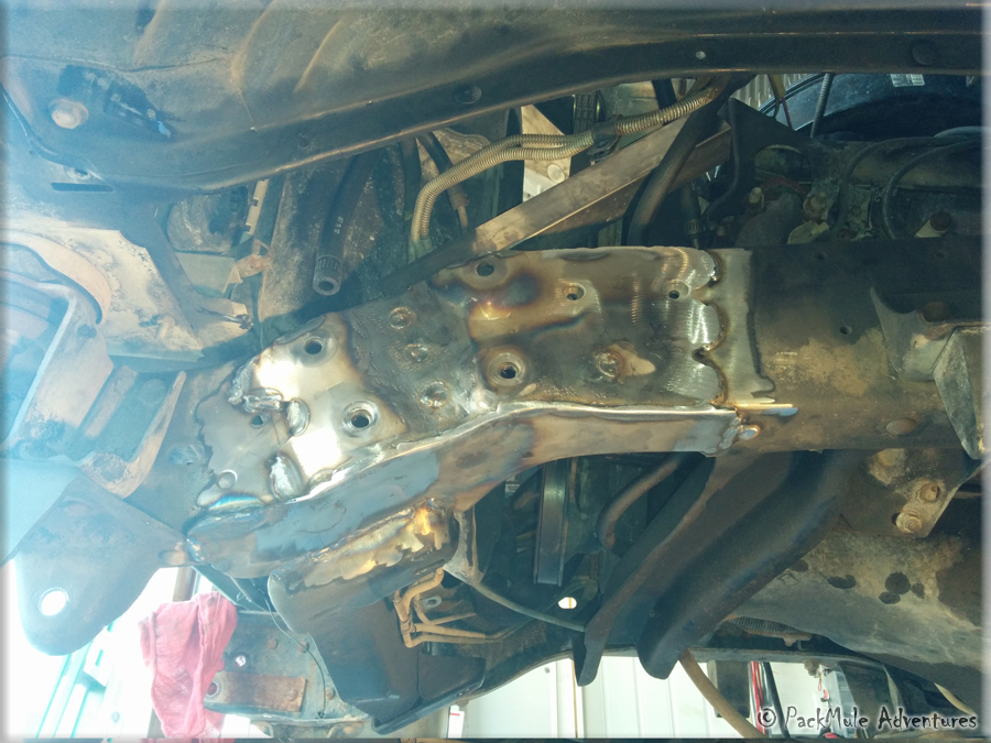

First step in beating it into submission

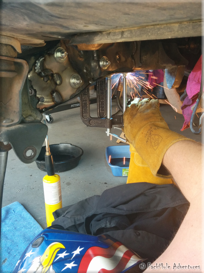

I am pretty sure others have done it but I used 4 bolts to pull the plate down while heating it up. plus I also knew the holes would still line up.

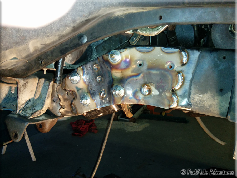

Side Plate welded in

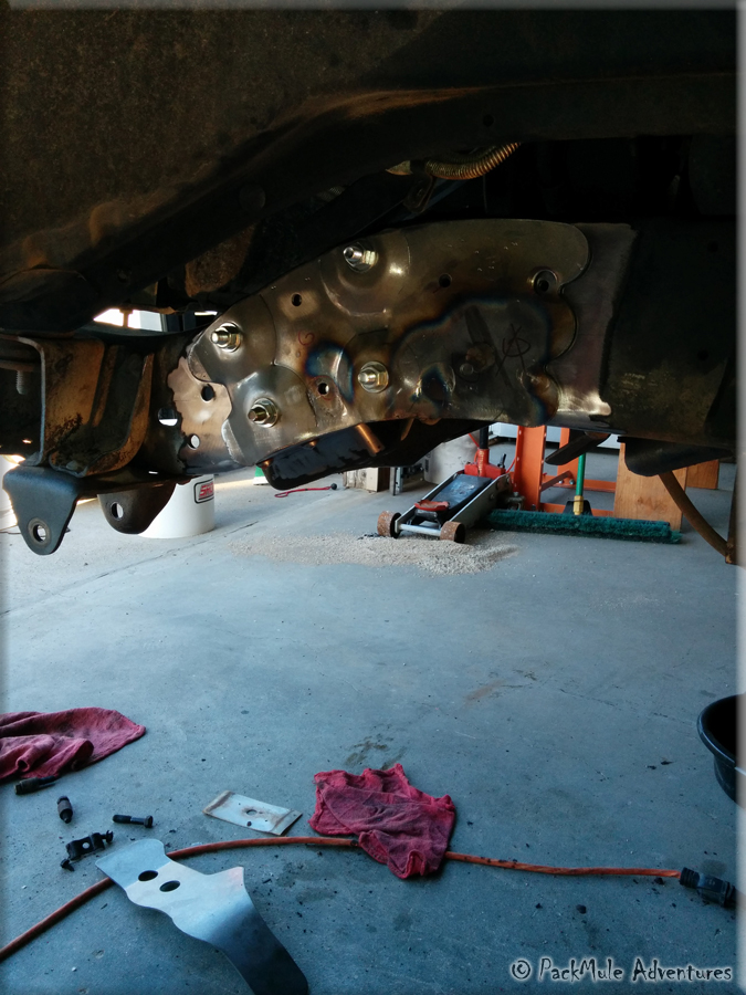

Wife likes to catch in the process.
Bottom plate all welded up. This part of the project is done.
mine was a little rough around the edges, sorry to hear you cut ourself. looks like you got it burned in pretty well.

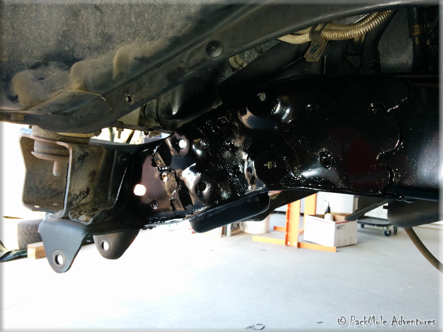

Nice coating of epoxy paint on the frame
