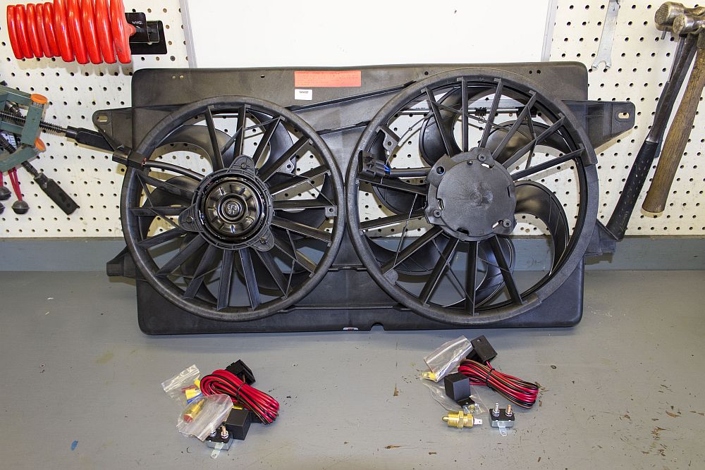

  5. nutt7
    nutt7 1/2 ton status Premium Member
    Joined:
    Dec 30, 2010
    Posts:
    677
    Likes Received:
    156
    Location:
    Ahwatukee, AZ -> JBLM, WA
    Build(s):
    1
    I had to modify a mount I think. Pretty sure I drilled one hole but maybe not even that. I know there was a provision for moving whatever I moved...It took a couple minutes tops and I'm no fabricator.
    For the windstar fans, I originally had a guy weld brackets on my aluminum radiator that fit the windstar shroud mounts. The radiator took a dump so I made brackets out of 1/16 steel scrap and screwed them to the core support. Not enough time has passed to see how it'll hold up, but I might do another version. The shroud only got minor trimming to clear hoses. I have not filled in any of the gaps to seal it perfectly to the radiator but it cools fast for the PNW. Others on the forums did things more fancy but I like easy and effective. More recently, I grabbed the relay box and the low speed resistor from a windstar so I can run it in two speeds. On high it sucks a lot of amps and I have melted a relay or three. Low speed has been perfect although I haven't had to deal with it in AZ yet. The factory relay box has a 70a relay and a 30a relay. I was using two 30a relays.
