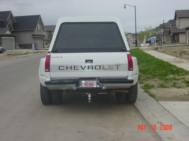

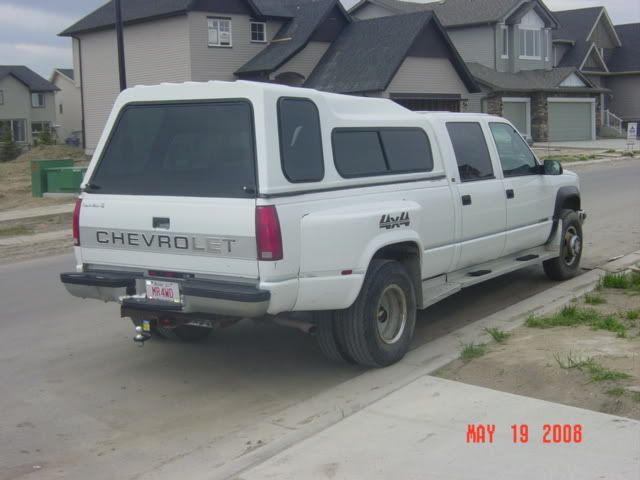

Meet the Albino Rhino........7' tall 7'6" wide of Chevy goodness......'cept for the bigblock :wink1:
The Ol' girl has to have a heart transplant. the 454 has to go.......I'm just waiting on the arrival of my 12 valve to get started...... its getting a disc brake converted D80 with new detroit trac-lock too...... debating on SAS front. I kind of like the IFS ride still. we'll see how it rides after the cummins conversion I guess. Airbag the rear D80. Power heated leather swap from newer Yukon or Suburban.

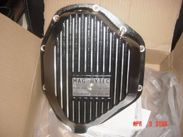

new diff cover for D80

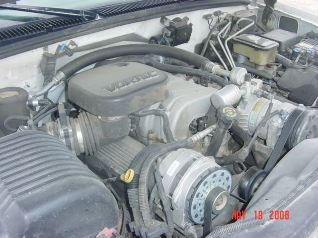

Vortec 454 will of course make its way into the Z-28

Well the 10mpg bigblock has bearly enough power to get out of its own way in the 7500lb truck. The sun has set on this bigblock's working days.
This is going to be my new DD/ tow rig so running to work on the highway needs the reliability & MPG. Easy power to be had if needed with a P7100 pump'd 12 valve too. Going to pull camper and quads eventually.

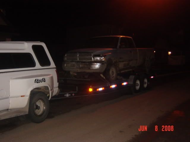

OK going to pickup the '95 Dodge 12v donor on June 7th. Ordered 6" RCD lift today. going to dual 37's on it.

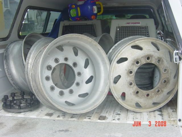

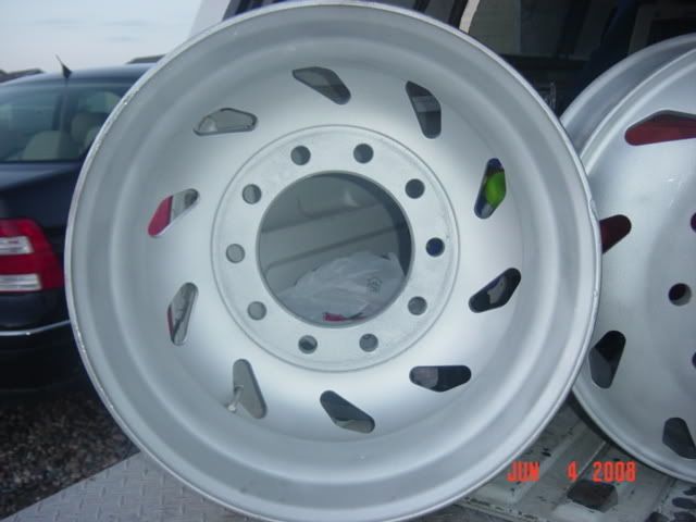

More junk.........picked up 6 Alcoas this AM. Went with Freightliner directionals. All in good shape but need a power polish in a pretty bad way. May not use the Toyos, may go with a true 255/70r22.5 , which is still a 36-37" tire.

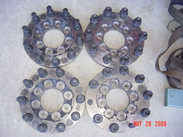

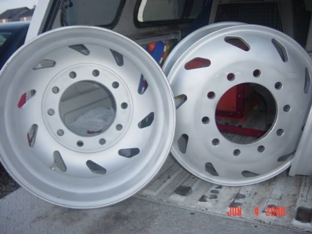

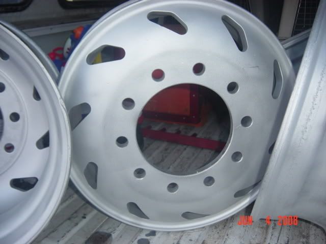

they're 22.5x8.25...... 7300lb load capacity each :p: I pressure washed all the crud off them today, going to soda blast them tommorrow morning. then we'll see just how much polishing power I'm going to need.
I've pretty much narrowed tires down to Yokohama 507s in a 255/75, they're not as agressive as I originally wanted but, I found a good price on them new so thats that. they're a load range H or something.
Those adapters are beef. My buddys dad has them on his 04 and when he put them on he said they musta weighed 80lb's each.
they're beefy....no way 80lbs of beef. but plenty soild.
maybe 50 at most. Ok I'll weight one at work tommorrow and get back to you.
OK scales are in........`1 rear adapter (thicker slightly, longer lugs) weighs exactly 32lbs with 10 lug nuts. 1 bare rims weighs 55 lbs.
