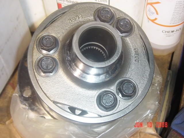

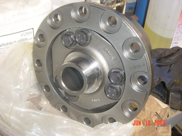

D80 Detroit True-Trac

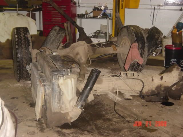

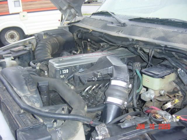

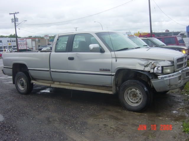

Are you using the Dodge intercooler? Just wondering how you were going to fab up a mount for it.

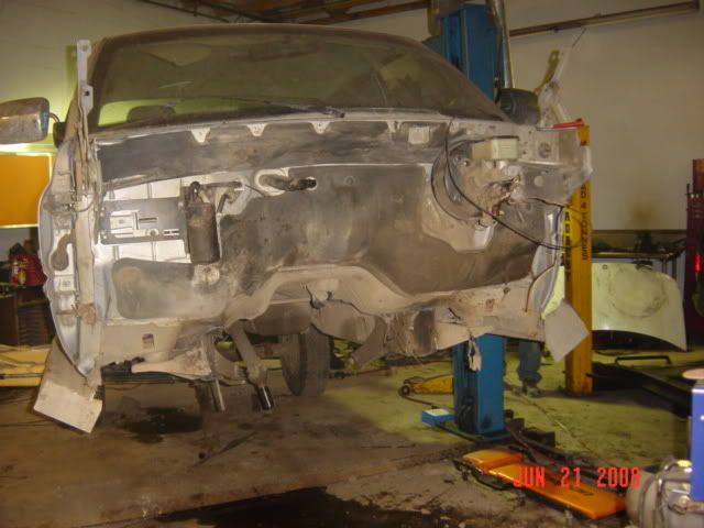

I'm using the Dodge rad, fan, intercooler, pipes, everything. I'll cut the rad support to suit. and weld back in supports where ever is needed.
OK I guess I didn't actually answer your question..............
the IC has 2 little cast pegs on each bottom corner, they have a little rubber boot/isolator that it sits on the rad support with. If you look close you can see them in the pic at the bottom on each side. and the 2 brackets on each side take a rubber isolated bolt.

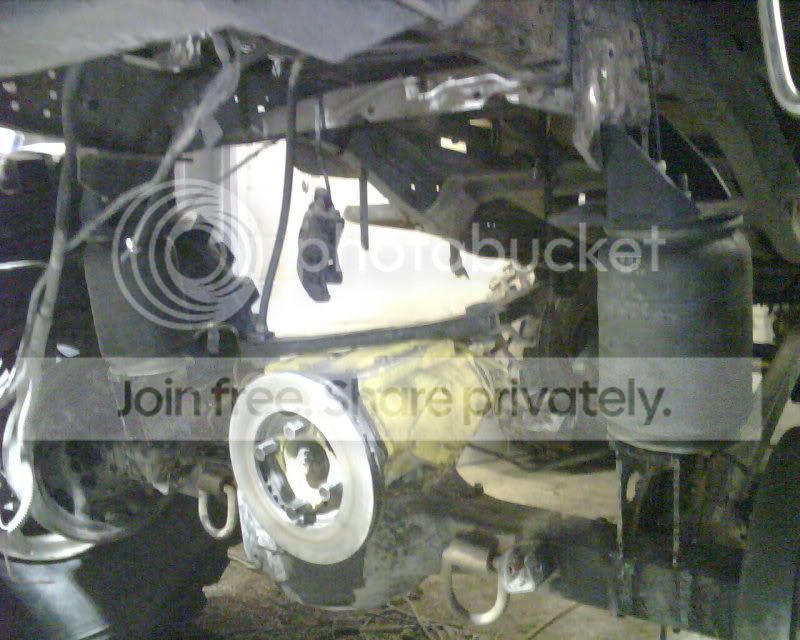

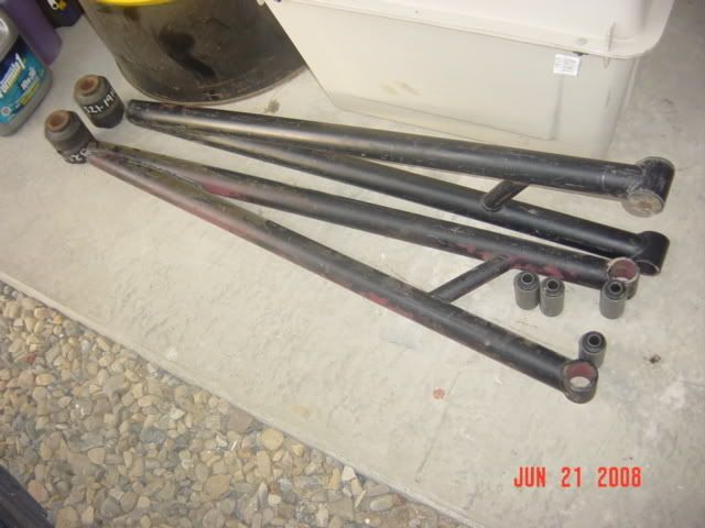

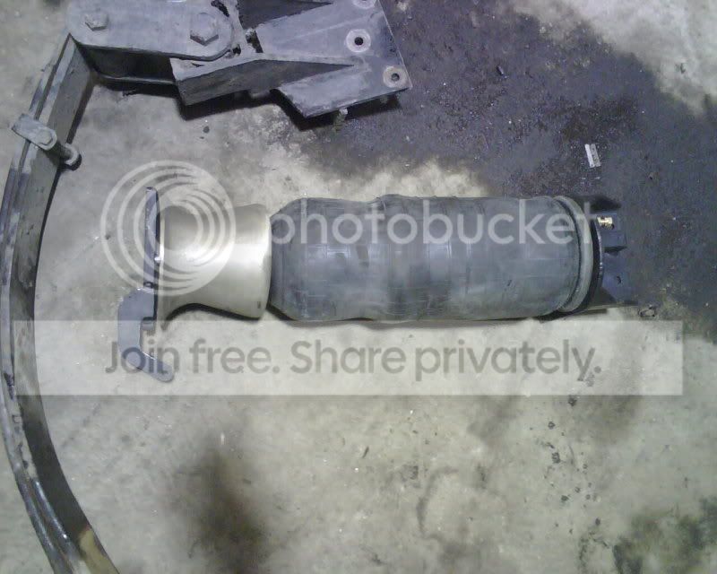

ok recent decision to airbag rear D80 when lift goes in. like a modifyed radius arm with panhard design. have access on a couple big firestone bags.
going to look like this with panhard. all bushing. no need for heims on links. 'cept will use heims on panhard.
Straight bags or are you going to use a 2-3 leaf soft pack in conjunction with the bags?
Bags like a big rig...not like a low rider. Not gonna take much air to attain ride height.
Rene
yes big truck bags. about 20psi will get close to ride height. which will be stupid easy to adjust for load, with remote schrader valve.
done like dinner.
Heres what they look like. not these exact 2 but identical. obviously the 1st pic the bag is over extended, 2nd pic is full collapse.
