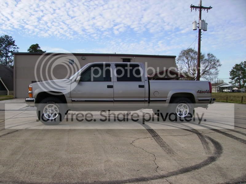

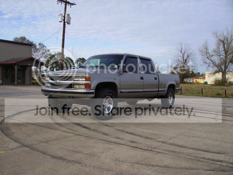

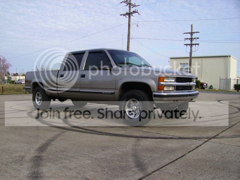

For those who aren't familiar with the truck in question here are a few pics for consideration...

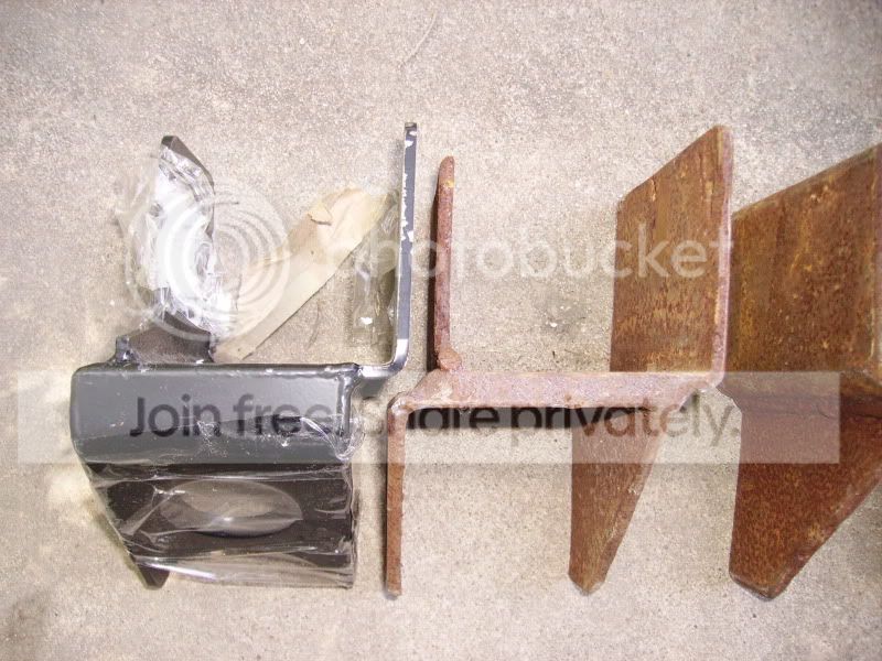

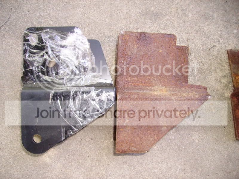

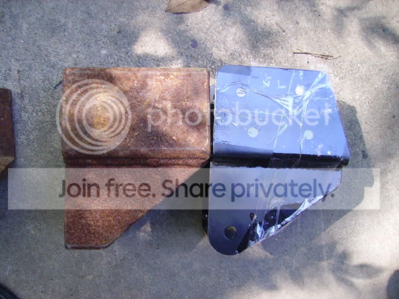

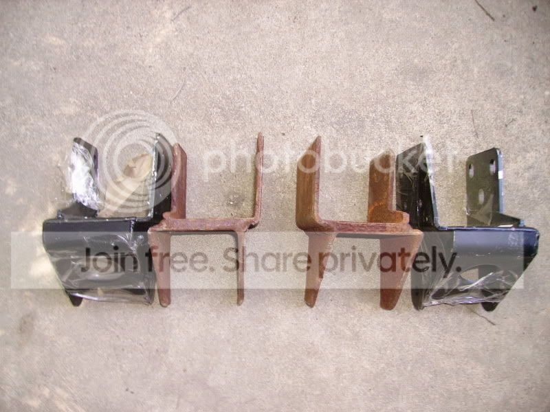

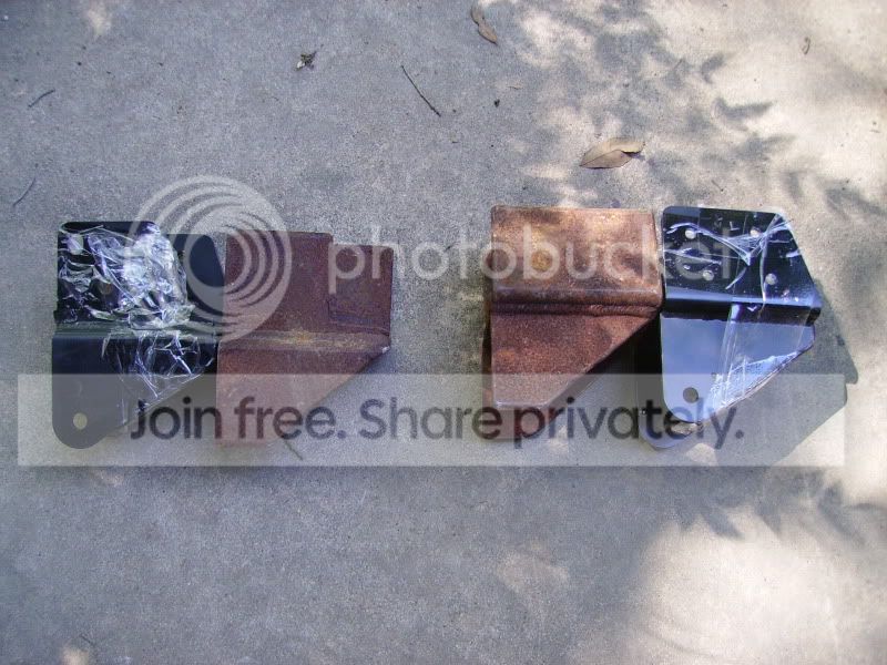

much thanks go out to Kelly for donating these front hangers... hope you enjoyed your beer! haha
all that needs to be done is a quick clean up, a few holes drilled and a coat of fresh black rattle can

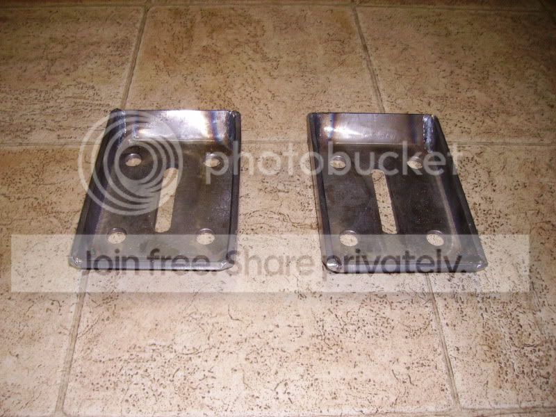

DIY4X 14ff U-bolt plates

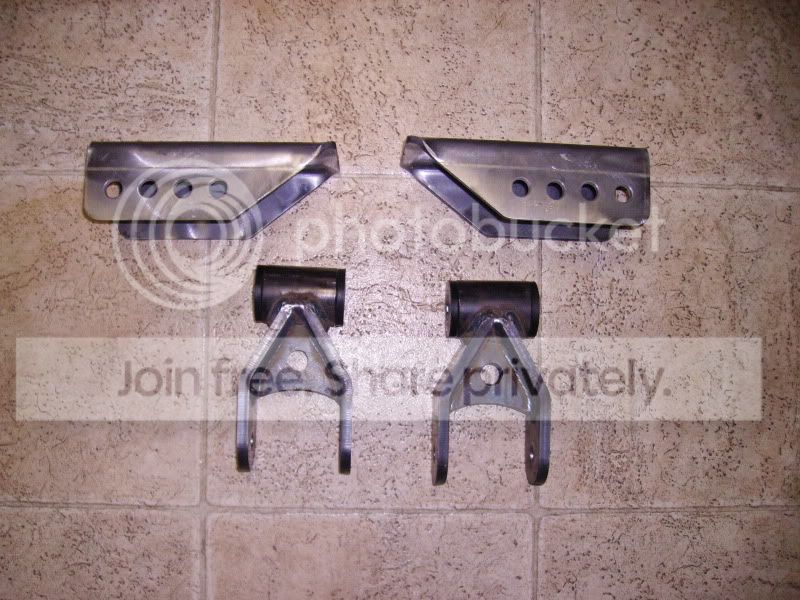

DIY4X multi position shackle brackets that prolly wont be used and 5" UDSR shackles

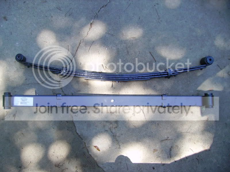

2"HD Tuff Country springs

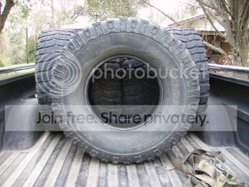

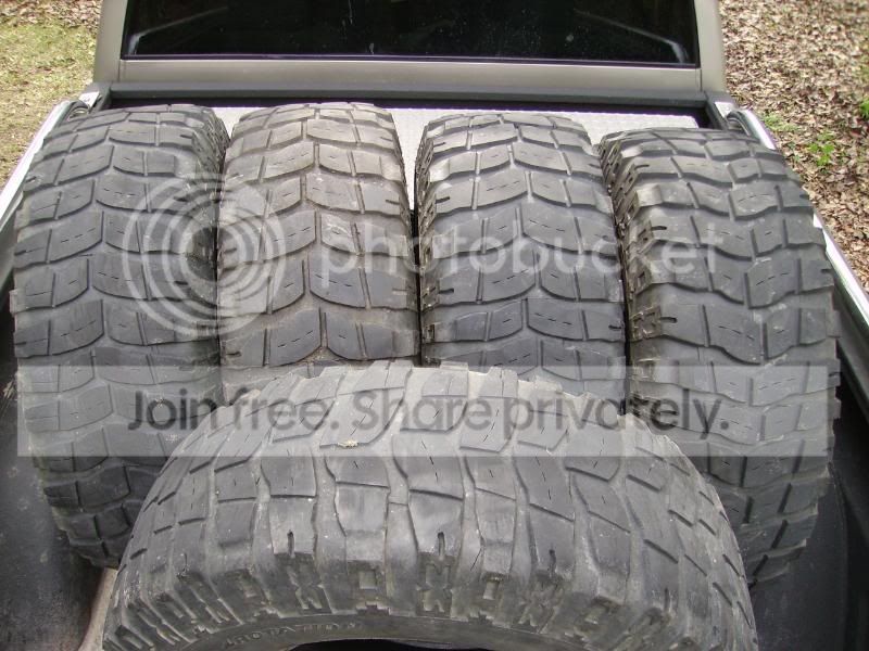

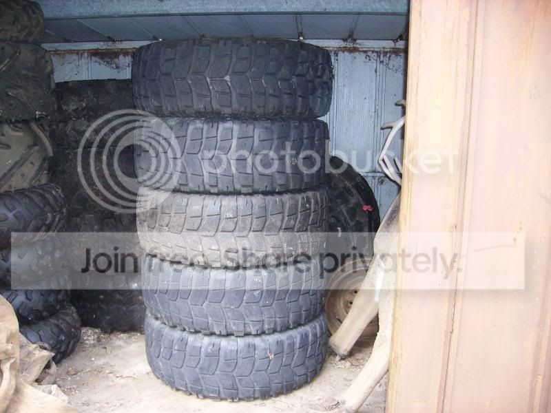

315/75R16 Xterrians... 5 in number

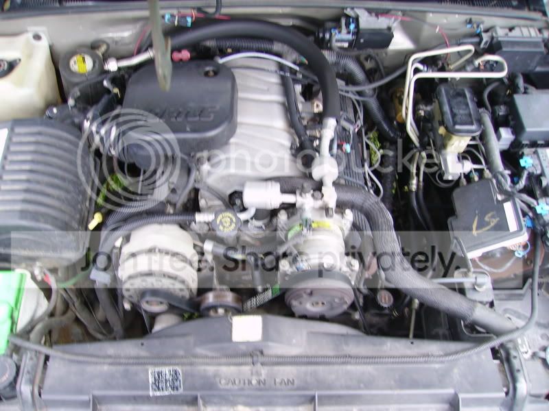

Or you could do one of those turbo under the bed setups. There is a 2003 1500 with a 6" and 35's in town. He had a procharger on it, blew the motor, then stuck the turbo under the bed setup. He loves it and he said it made a huge difference. Course I would modify the air cleaner setup. Pulls in too much dirt/dust.
