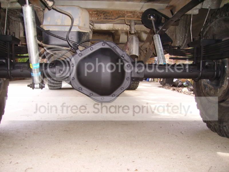

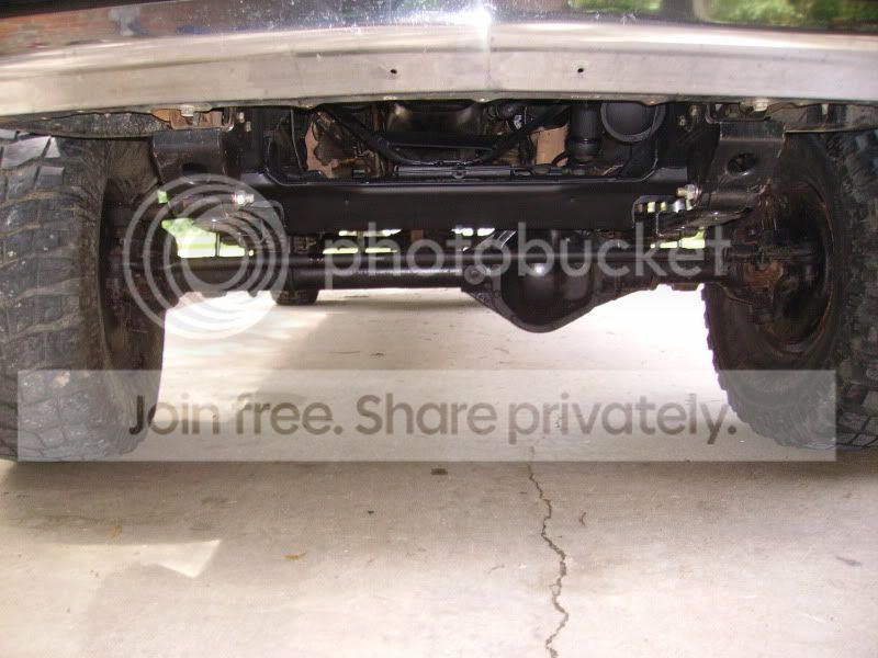

One question, is it just me or our your springs really close together? Seams that my springs are closer to the ends of the axle tubes. Is this due to the bends in the front of the frame? Or am I just seeing things?

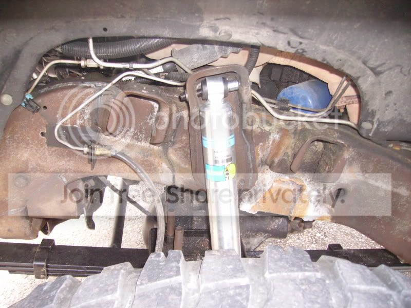

agreed... i think youll prolly have to have atleast 3" of lift for clearance issues. the hangers im using give 3" by them selves, i did some pretty good cuttin on my front lca crossmember and my springs are still close to hittin it. id say you could prolly get away with running some stock 73-87 front leafs
nah it must just be an optical illusion... its a 32.5" pad axle just like all chevy axles

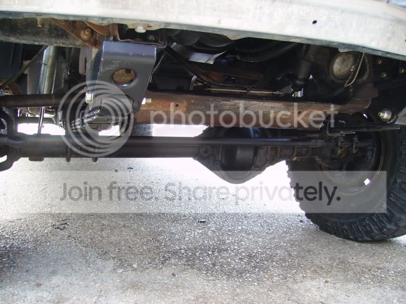

How is your handling? I ended up building a track bar because I had a lot of side to side motion. Also, did you address the front pinion angle? My axle was a low pinion D44 with 60 outers (FREE D60 rear and D44 front from a friend's yard). I cut off the "C's" and angled the pinion up 15 degrees to make the front shaft work.
ehh handling right now leaves a little to be desired, im def gonna put a panhard bar and sway bar in this sucker, and later on i wanna get some softer springs... i have a hi pinion 44 so i dont realy have any pinion angle issue, and my caster is perfect, not a touch of death wobble :D

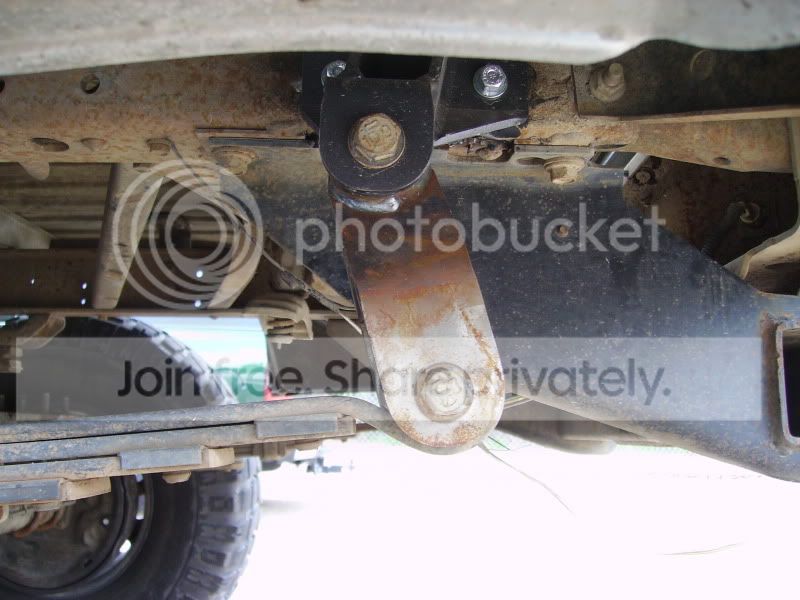

front shackle angle

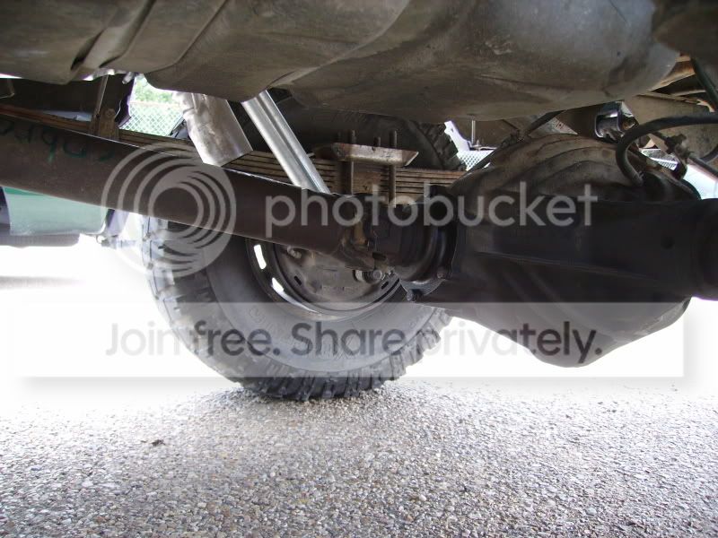

rear shackle angle
need to get my pinion down a bit... driveline vibe ftl

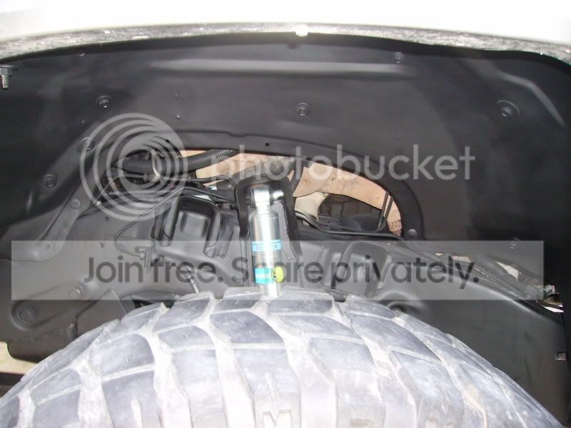

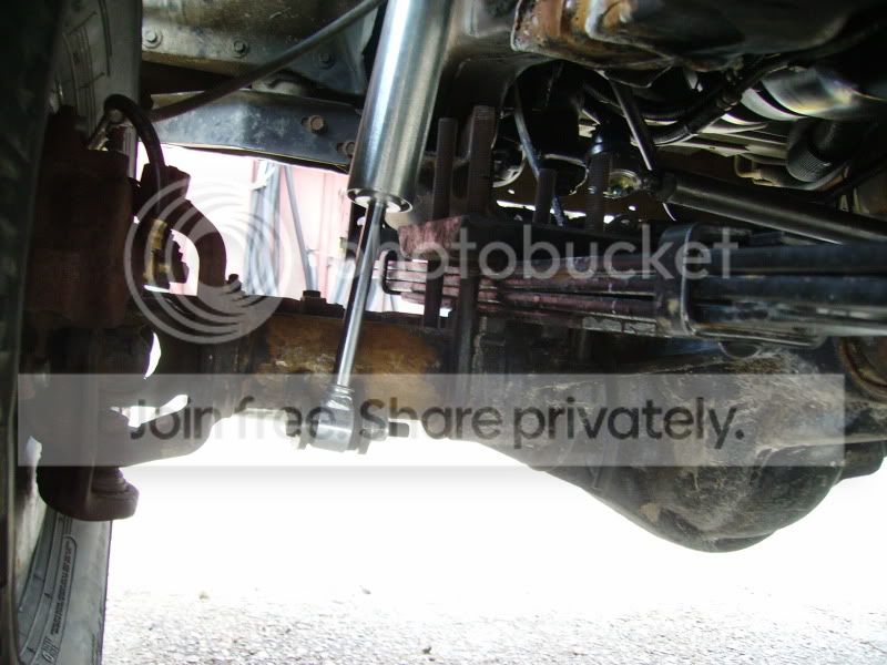

Yo front shocks are on upside down SON :D
:p:

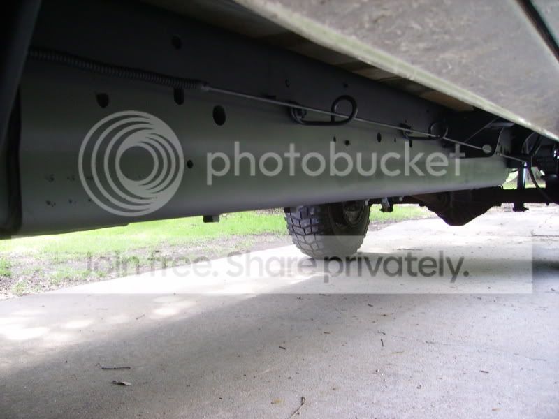

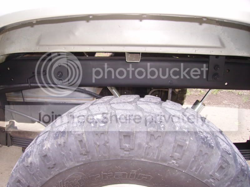

shoulda got pics with the whole frame down to bare metal... oh well
2 cans of rust tuff primer, 4 cans of rust tuff flat black and $40 bucks later here she is
