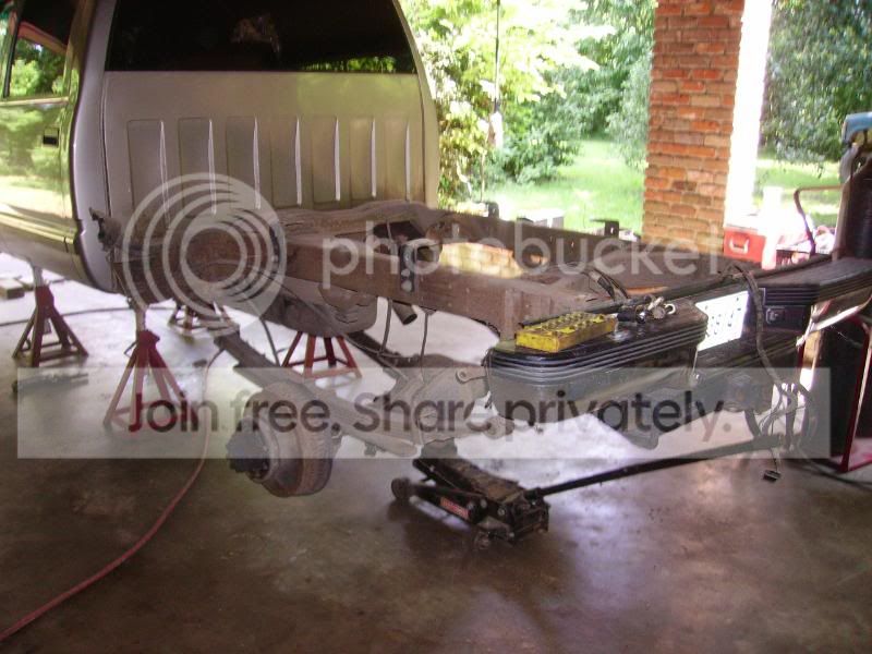

Project: SAS Tow Rig

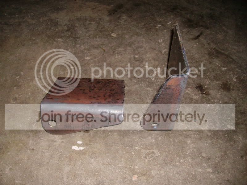

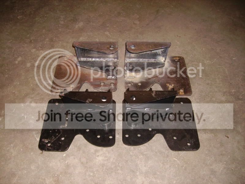

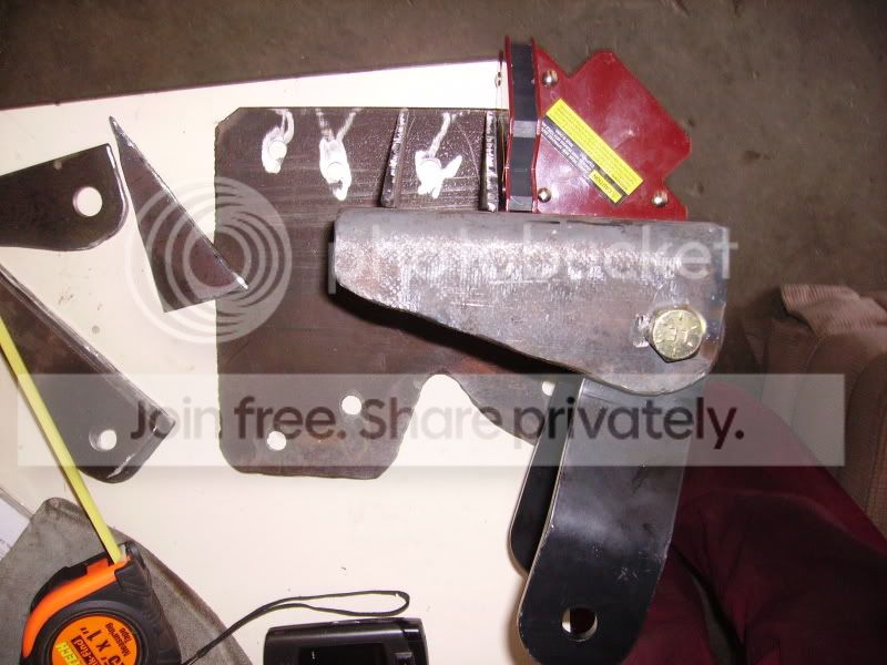

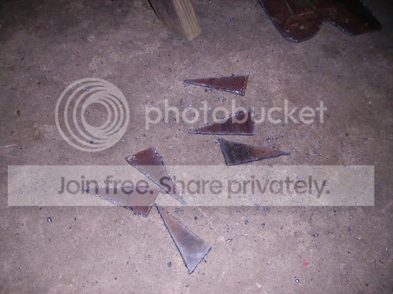

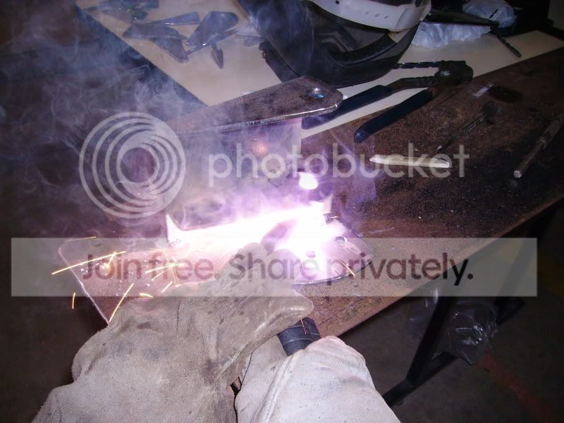

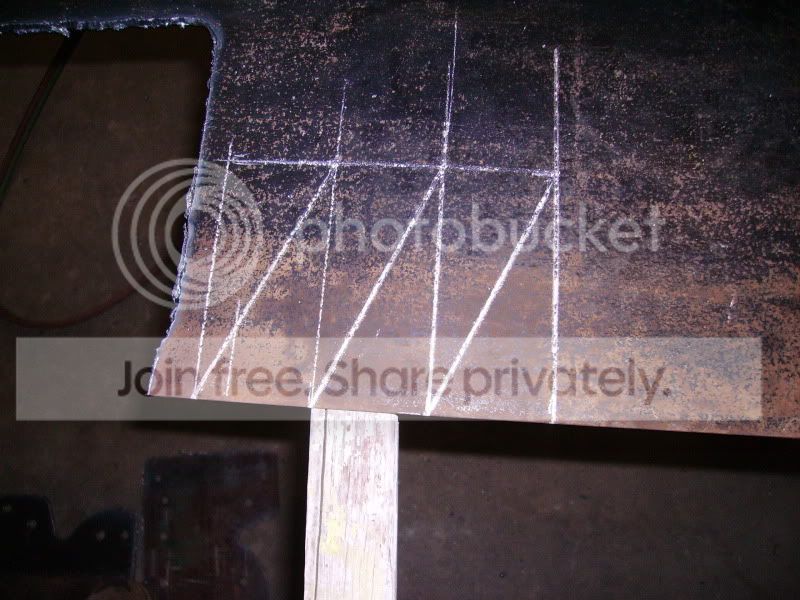

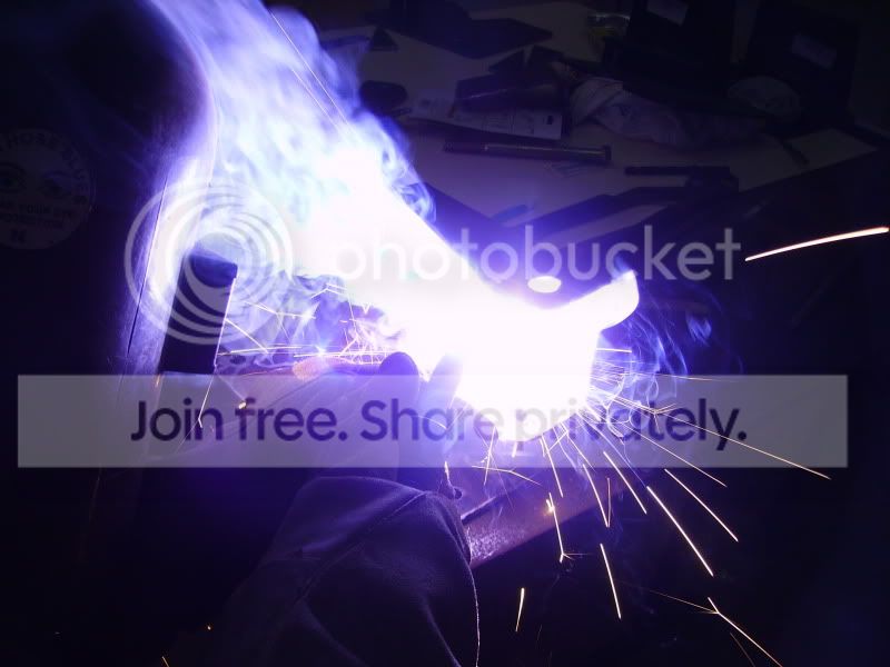

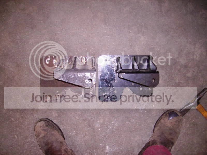

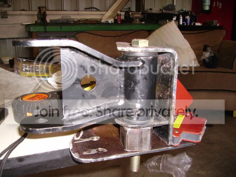

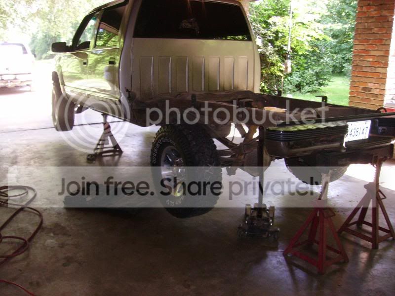

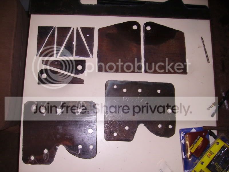

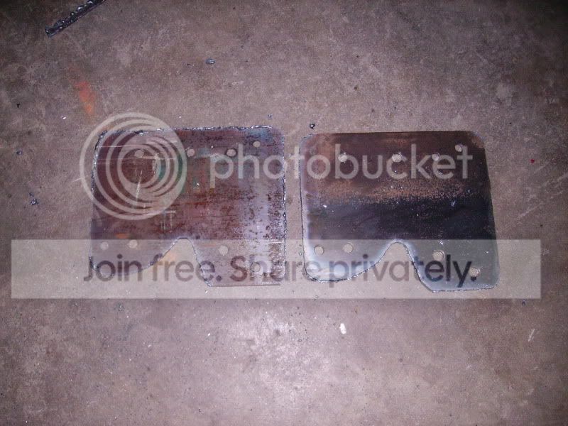

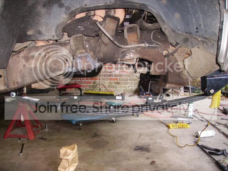

bracket pieces all cut out, formed, drilled and fitted into place... all that needs to be done is to burn it all together
bitch is badass drew. glad we got er done. should look and sound just about perfect with the exhuast and 35's
took dusty in whitenoise last night, he thought the exhuast was kinda loud...just a heads up since your running the same thing. that bb should sound like a beast

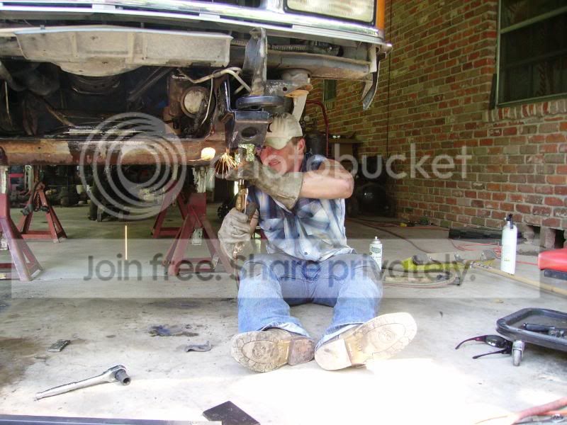

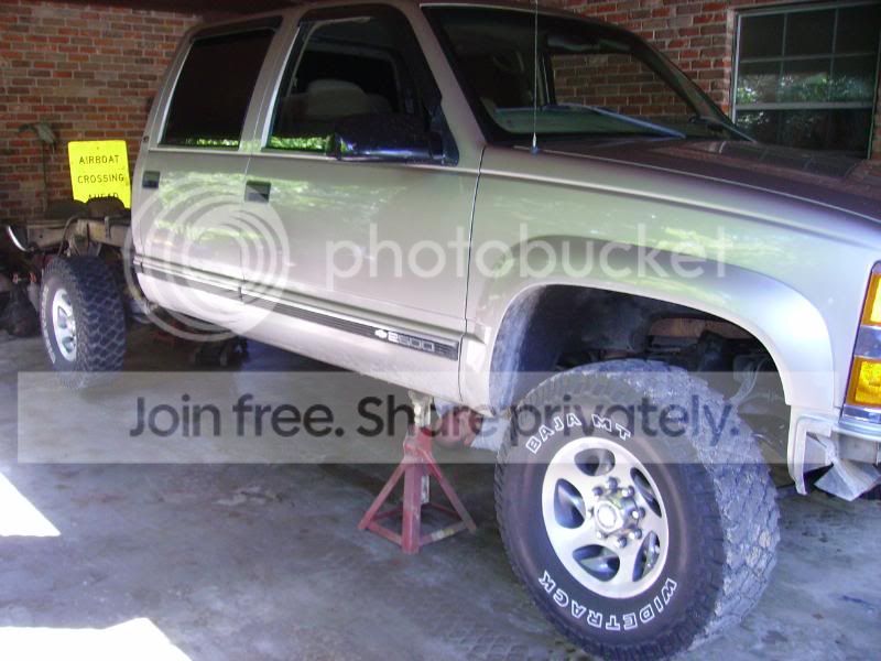

That's a ton of work to get done in a single weekend! This is what needs to be done to my k3500 :deal:
Is that Larry the cable guy?
:haha:
JK, truck looks good. Looks like how it should've came from the factory in the first place!
lol thats me...i seem to have an issue throwing away any old button ups when my arms got too big for em.

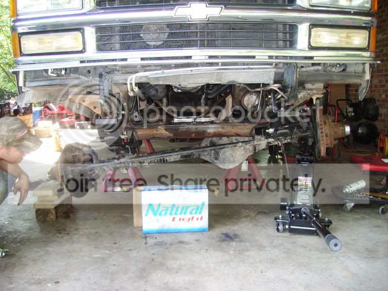

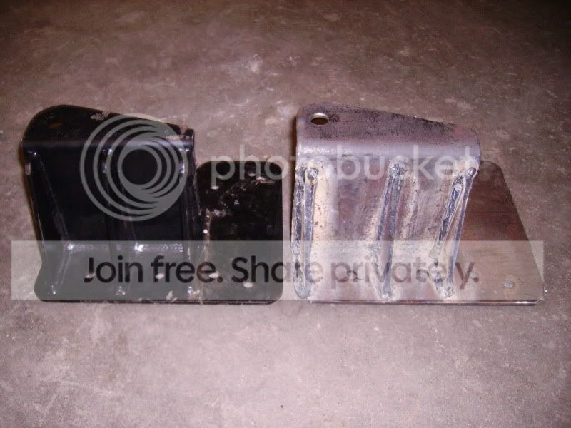

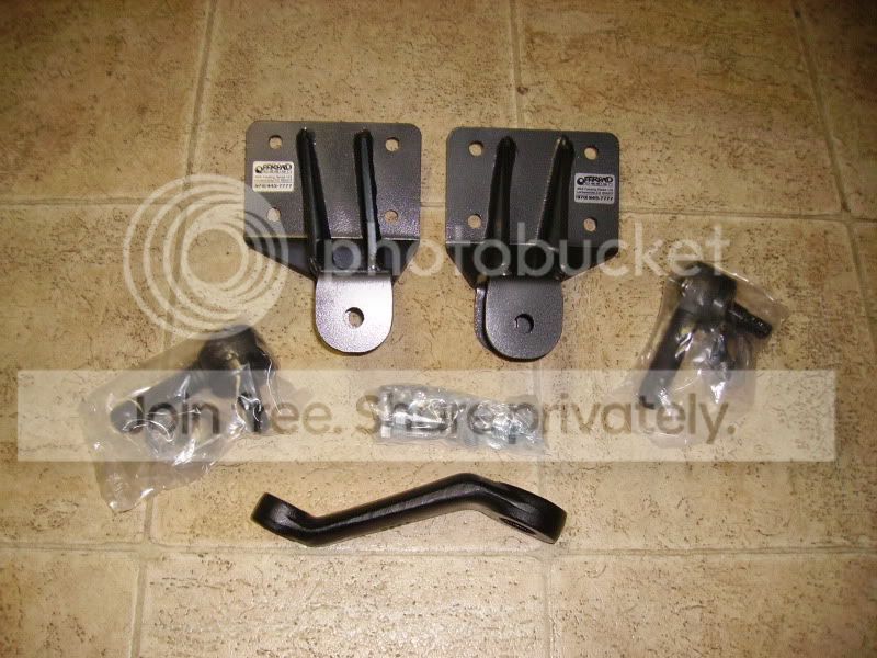

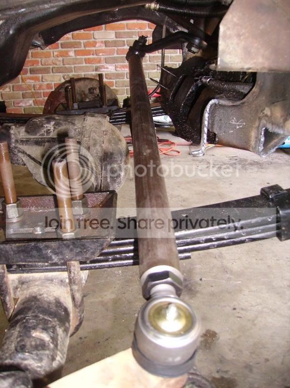

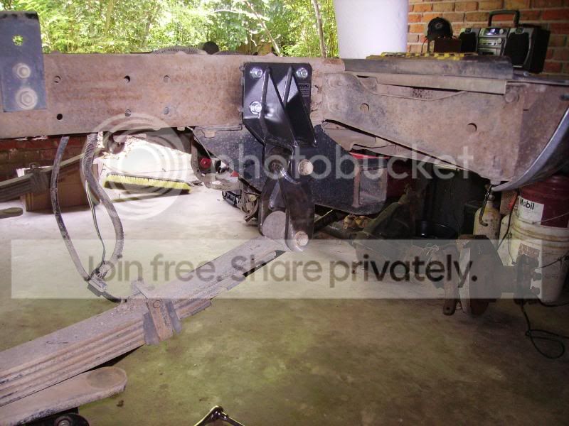

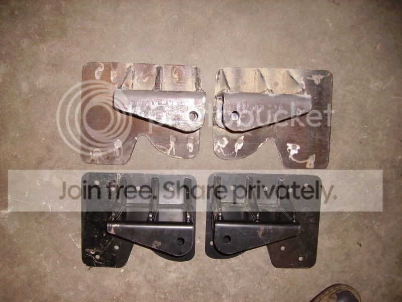

how long did it take to make all of those brackets for the front

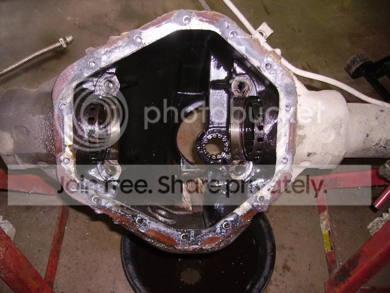

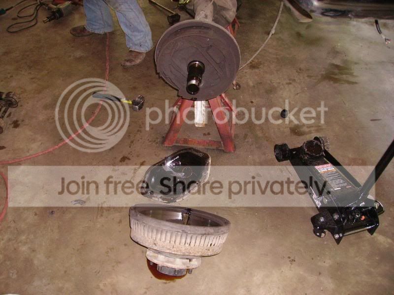

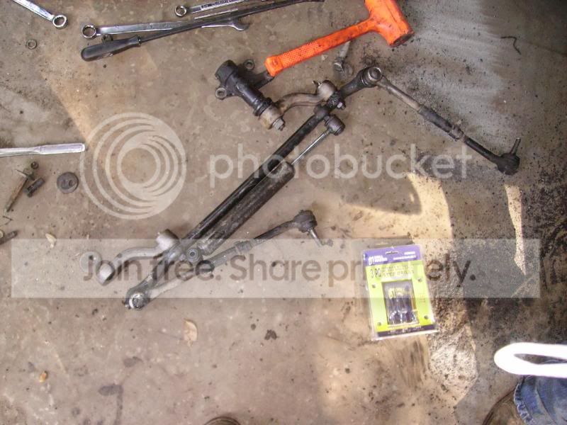

do all the ford axles come with a passanger side steering arm or did you add that your self.
Someone will correct me if I'm wrong but:
No factory light duty truck balljoint axle has ever had a passenger side knuckle steering arm stock. The only example of axles that will except a steering arm on the passenger side without machining are kingpin axles and toyota/suzuki axles. The only reason that these axles do accept a passenger side steering arm is due to the fact that they are milled and tapped for kingpin/trunion bearing caps.

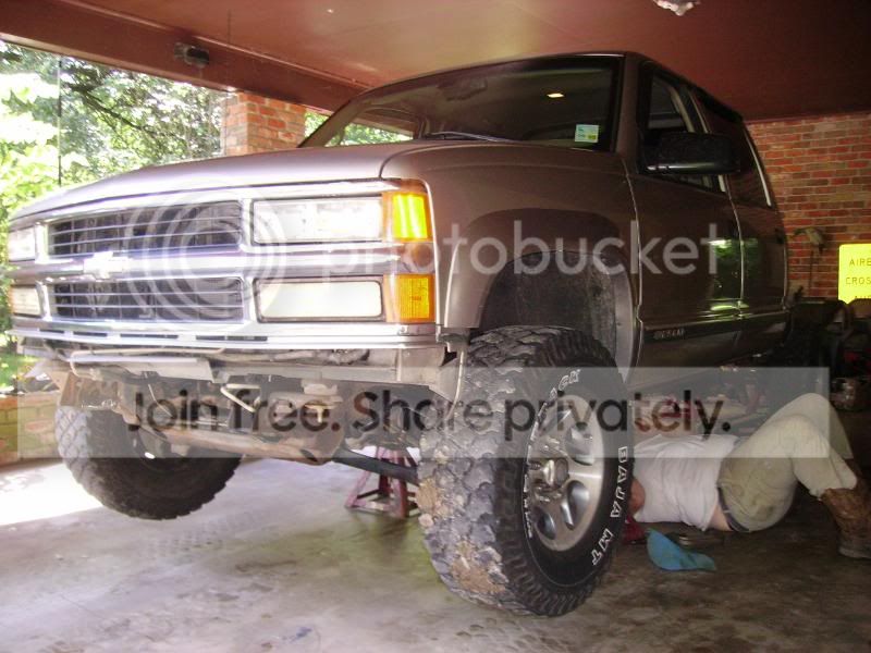

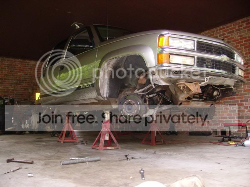

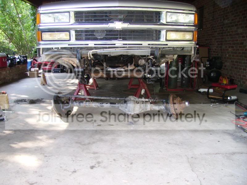

those brackets look real good on the truck. i hate when people SAS their truck but have some stupid looking crossmember hanging down. nicely done!
No no silly the 89-00 trucks had the stupid looking crossmember stock lol.
Torsion bar cross member screams "isnt there a better way we coulda done this? Nah its got enough ground clearance whatever"
