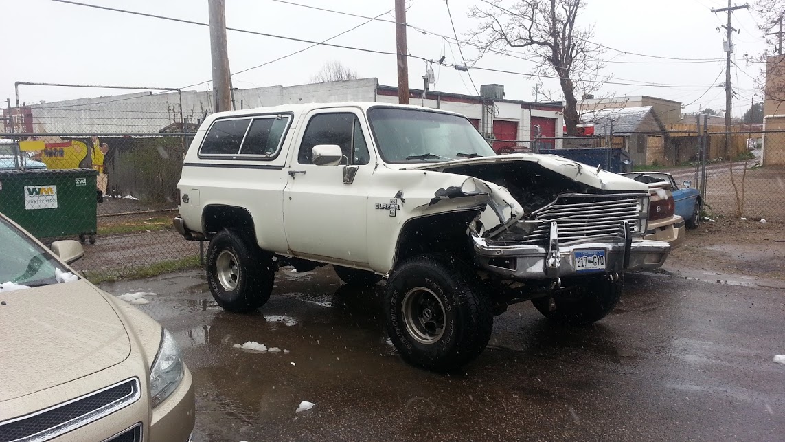

Lol. I haven't even started this project yet. But I'm thinking of chopping off the front clip, weld a tongue, gut the interior, and build a sleeping area in the cab and kitchen in the back just like any teardrop camper. As you can see, the body tub is still in good shape and should have plenty of room.
Basically, something like this...but a lot more-detailed.
This is still psyching me out. How stiff are these frames?!?
