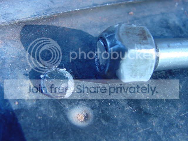

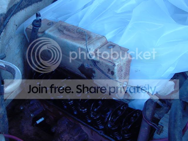

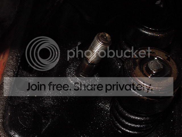

Like I said earlier,I'd have used the screw in studs..I have never had good luck trying to install new press in studs,even when the heads are on the bench..always trash a few,even with the proper tools( which is nothing more than a LONG nut made of solid round stock with a blind hole in it,so the hammer wont muck up the nut or threads..)--what happened in your case happens 99% of the time when an oversized stud is attempted to be pounded into a "standard" size hole without being reamed to fit first....goes in halfway,then it stops,bends,or worse,cracks the head!..
I'd try a screw in stud,a torch will break the loctitie's grip,an oxy-acetalyne torch would be preferable to a propane torch ,but it might work..you can use a open end wrench on the tap,or an adjustable..they also sell "tap sockets" to fit a ratchet for places regular wrenches and "T" handles wont fit..take care to get the threads started STRAIGHT so the stud isn't crooked once its in there..a giude for the tap like a 3/8 drive socket over the boss might help keep it straighter..good luck,dont junk this motor yet,it'll probably live long after this is fixed!...
