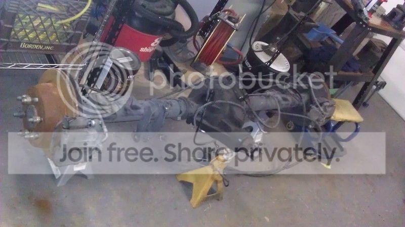

Little update, I finally found a rear axle for a good price!!!
2004 Silverado disk brake rear axle complete with parking cables! Got it for $250 it has matching 3.73 gears. Got to order some spring pads, cut the bump stop plates off, and weld it up, once I figure out the perfect pinion angle that is.
Looks like my evil plan is coming together. Half ton modern brakes and larger lugs, without major issues. All easily repaired with factory/autozone parts nation wide.
Some of the details for the rear axle.
88 Burb 10 bolt 8.5inch :
42.5" spring width
64" wheel to wheel
3" axle tubes
7/16 lugs
99-2004ish Silverado axle 10 bolt 8.6inch:
49" spring width
68" wheel to wheel
3" axle tubes
14x1.5mm lugs
So, it gives me the wider rear axle without spacers. Same 6 lug pattern with the larger lugs (same as my H3 front conversion). Same basic size. Modern disk brakes with a parking brake. From my measurements so far, I can leave the stock spring pads and only remove the bump stop plates to install the new spring pads. I'll know more later about the u joint connection, but every part I'm looking up shows I don't even need to change the u joint, I can bolt it right up.
I forgot to add, the parking brake cables should be adaptable to the stock parking brake set-up.
Again, this conversion is a huge upgrade to the stock systems from our square bodies. But it also utilizes factory parts and replacements are available everywhere. Servicing my brakes should also be MUCH easier as both the front and rear will be brake over hub arrangements.
