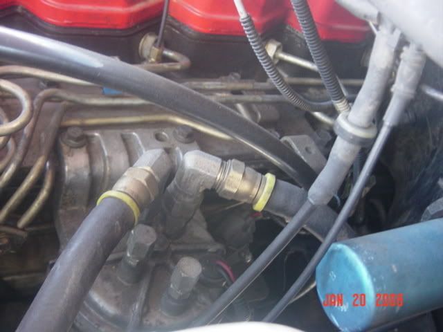

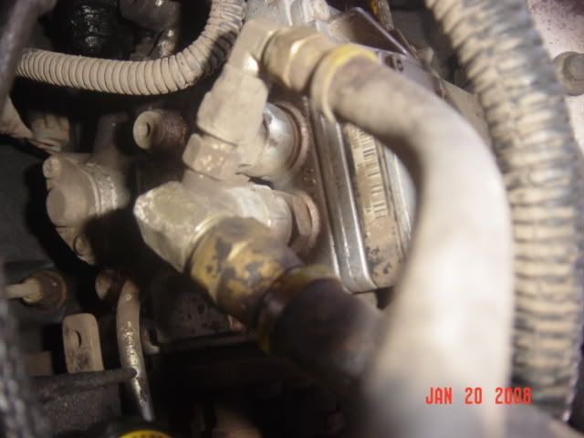

x3 use "pushloc" style hose and fittings often in the past for diesel fuel systems and air systems. and on my own diesel trucks fuel systems.
persoanlly use Goodyear Gator-grip hose, but fittings are the same. the yellow collar designates pushlock fittings from regular barbs. no clamps nessisary rated to 300 psi.
