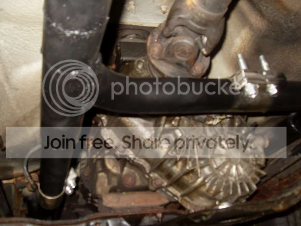

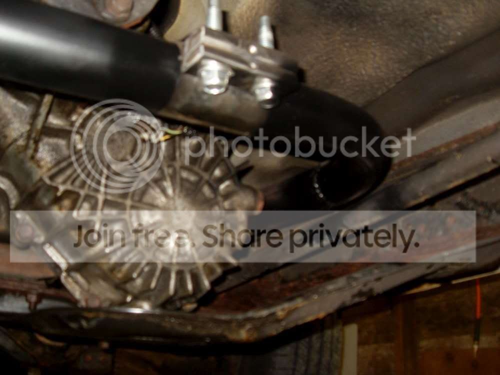

Well I did the exhaust today. I realized a few days ago it was completely shot in like 3 places. I dropped $300 on summit. Bends, clamps, magnaflow cat, magnaflow muffler, resonator, etc etc.
The stock exhaust was routed terribly. There was a POS flex pipe routed UNDER the front driveshaft... So I ran a pipe down the other side of the tcase, made a new "y pipe" and remounted everything.
Its dumped behind the rear axle w/o the resonator right now. Turns out when I ordered my muffler I didnt realize it was a "straight through" rather than a chambered muffler... Its not really what I wanted to Im gonna put an over the axle piece in later next week and hook the resonator up and see if its quiet enough...

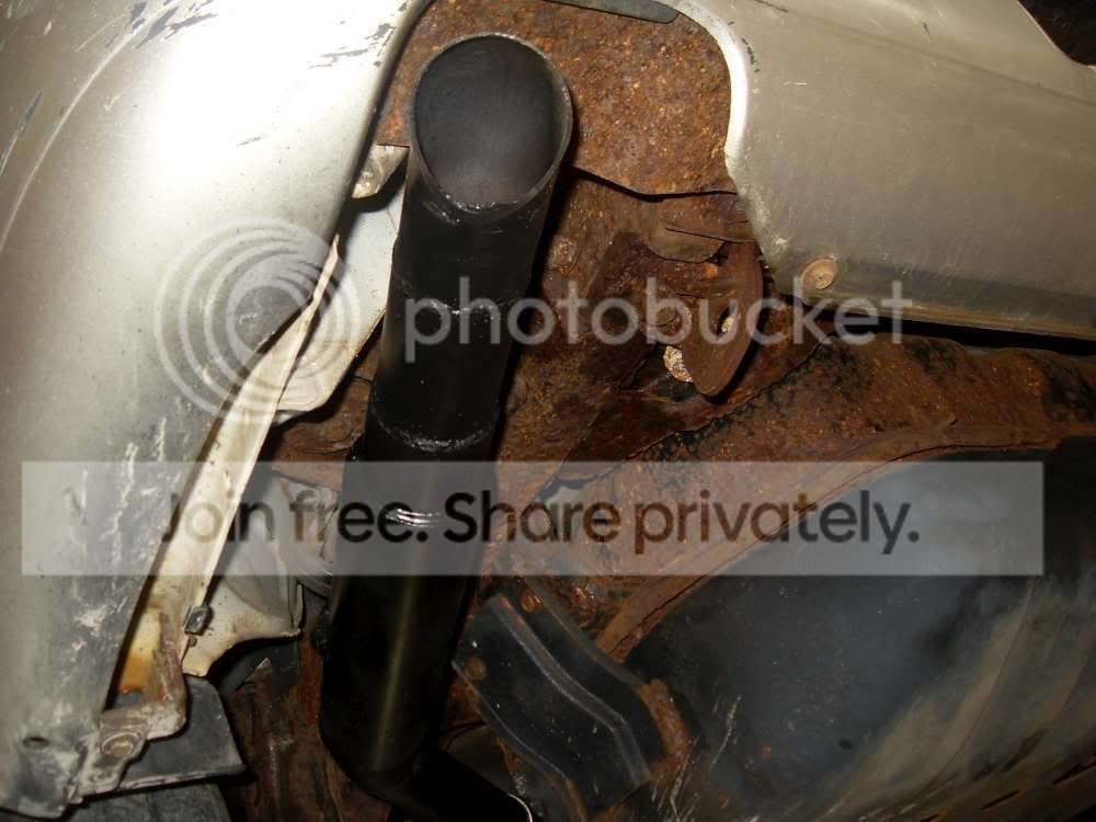

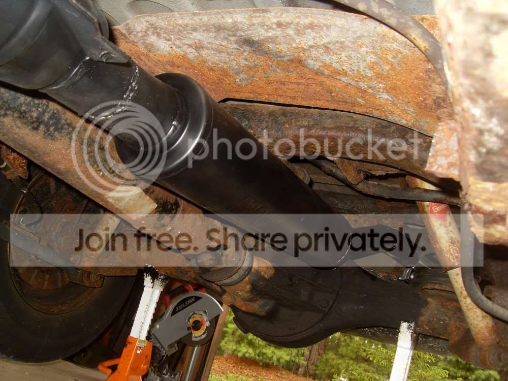

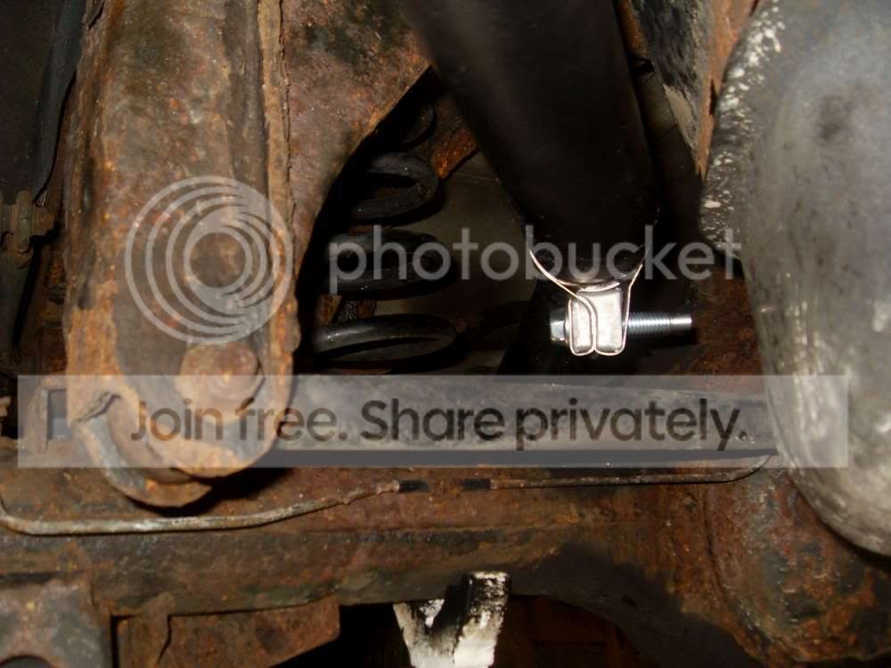

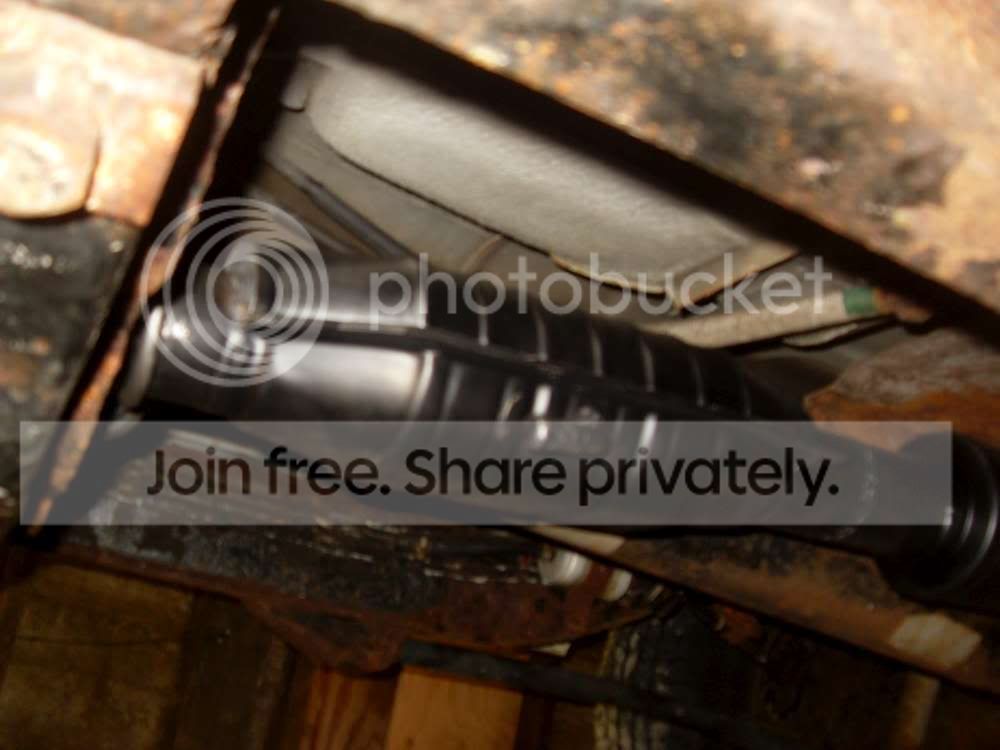

Heres some shots of the exhaust. Got the resonator on and the over the axle piece done. Its much quieter now but I really hope the muffler breaks in more. Its got a little bit of a buzz over 3000rpms which Im not happy about to be honest...
I also need to get some sealer for the butt clamps because they spit a little where the two ends seam even though theyre not suppose to need anything else.
