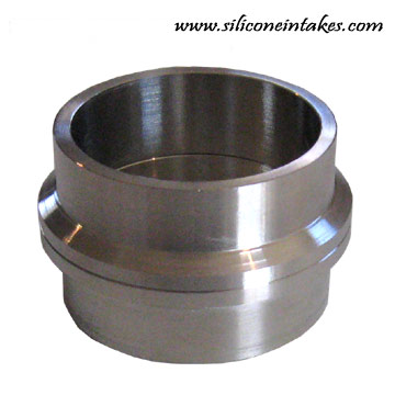

So I was cruising some yota forums and found my solution. V band clamps. Theyre basically like a flange but with no donut.
You weld these on each pipe.

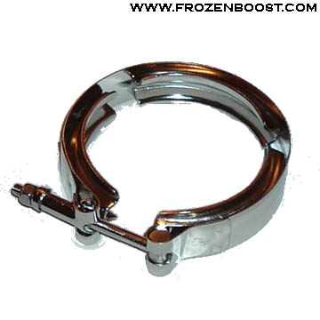

And then clamp them with this
And wahlah you get a butt joint that actually seals with no over lapping. Screw these summit butt joint clamps. I musta got lucky last time I used them...

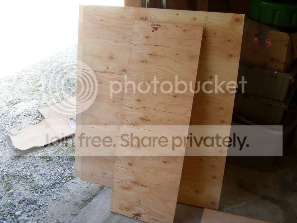

So yesterday I took the woman out to see Harry Potter. She had work today so I worked on the truck. One of the most essential things to an expedition vehicle is semi completed: The cargo/sleeping platform.

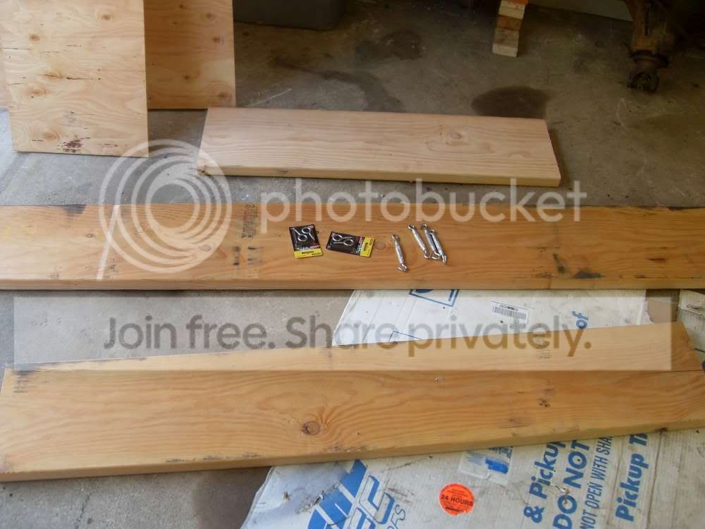

I did the boring work in the morning, replacing the front wheel studs and lug nuts. Then I hit lowes and got a 2x12x16 and a 1/2in sheet of plywood.
I started with this stuff

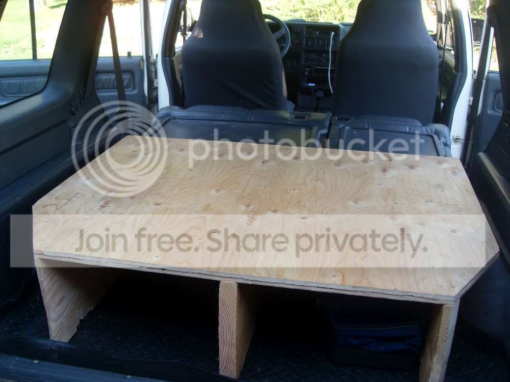

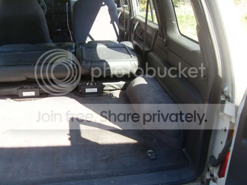

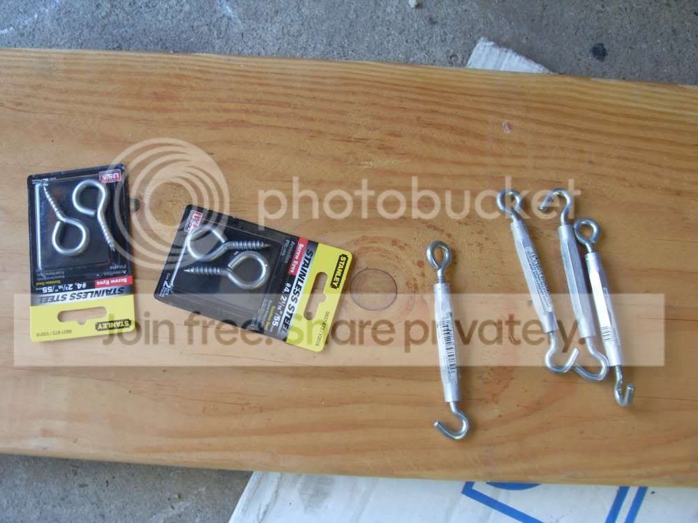

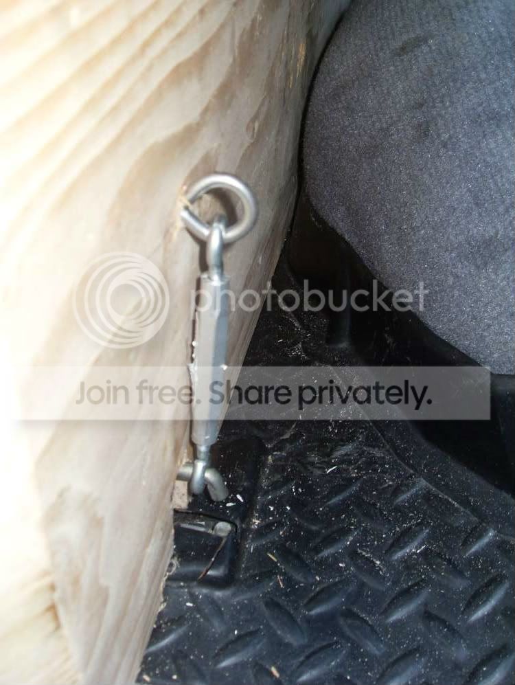

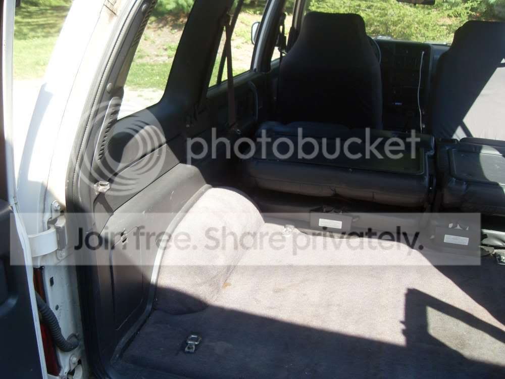

The trooper has hooks in the cargo area that I found under the plastic mat. So I cut slots on the mat so I could access the hooks as tie downs for the platform so it doesnt rattle or move.

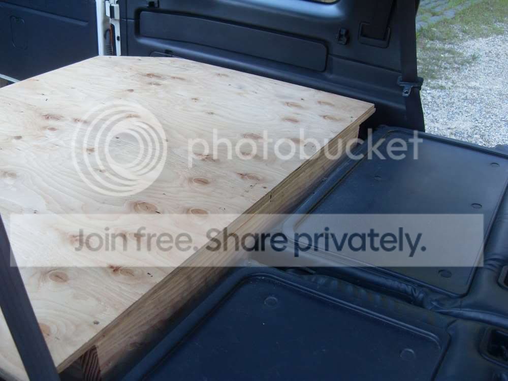

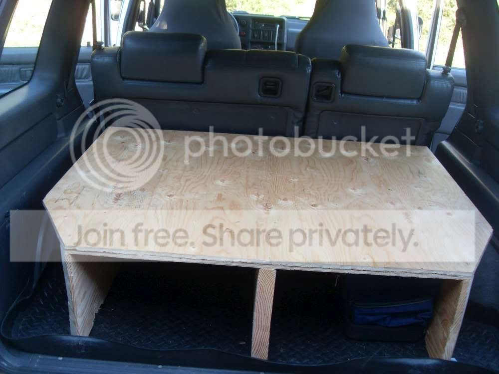

Little cutting, fitting, remeasuring, re cutting later and I got this.
Its about 1.5 inches too tall. Since I dont have a table saw Im gonna disassemble and rip the frame pieces down. In retrospect 2x10 probably woulda been perfect since I doubled up the plywood on top.
Its nice because I had alot of unusable height space in the back of the truck so now I can stick tow straps, tools, etc under the platform and put large stuff on top and obviously sleep on it. A queen airbed should squish in perfect.
Once its ripped down Im gonna paint the frame and wrap the top with some gray indoor out door carpet.

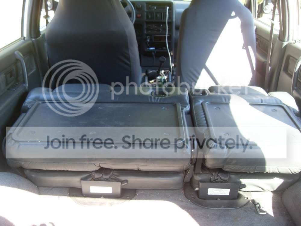

Idk if i missed it or not but how long is it from the seats folded down to the back of that??? I feel like its too short for some reason. but you may not be as tall as me idk lol.

Im a tall **** lol. Thats not a bad idea, only problem I see is that in cold weather you may find yourself, well cold. I plan on making/finding some sort of inflatable filler to take up the leg room in the back seat. That plus folding the seat forward as a "riser" will give me another foot.
