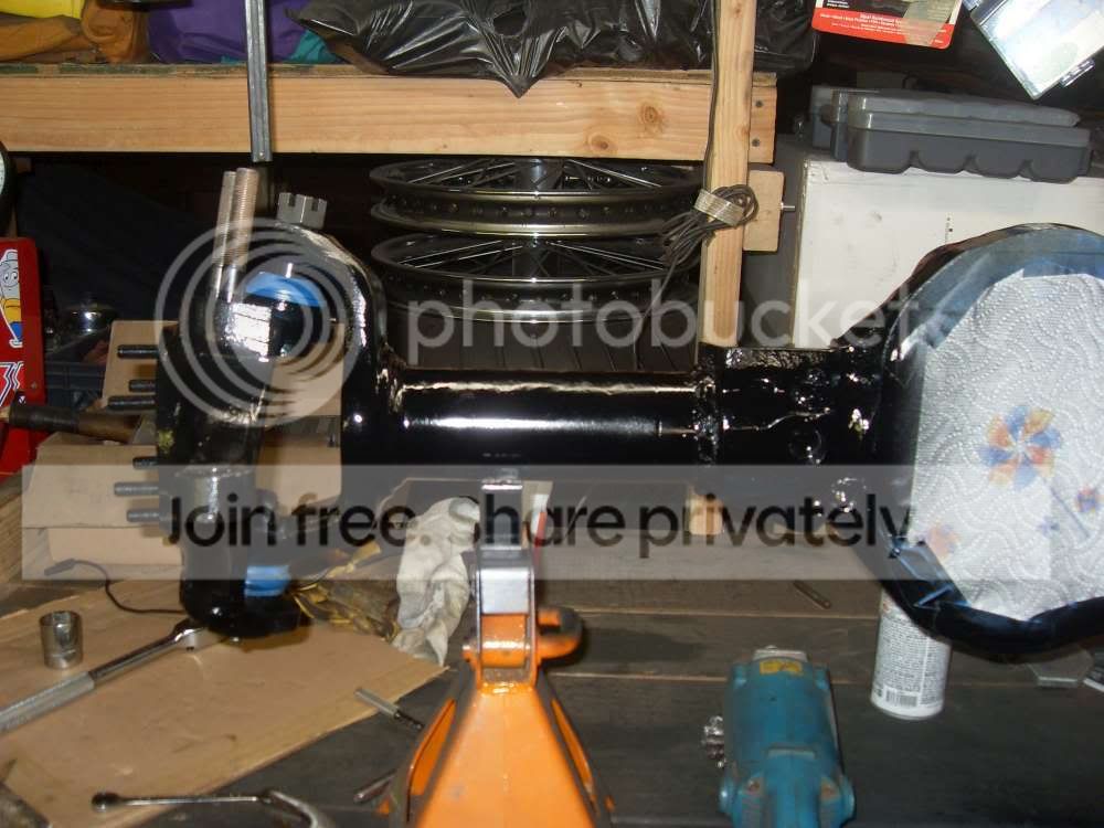

Removed the C and shortened my axle tube
Stripped the housing down to bare metal
Knocked the C back on the axle. Measured the caster and balljoint "camber" angle and tacked it on the tube
Shaved the bottom lip of the pumpkin smooth and ground out a small stress crack I found in one of the webs on the pumpkin
Tomorrow Im gonna burn the C onto the axle with the big machine at work. Also gonna fix that crack up. Torch the spot weld on the pumpkin real hot to burn the oil out and then make a pass on them cause they seep oil. Also gonna weld the pumpkin to the tubes.

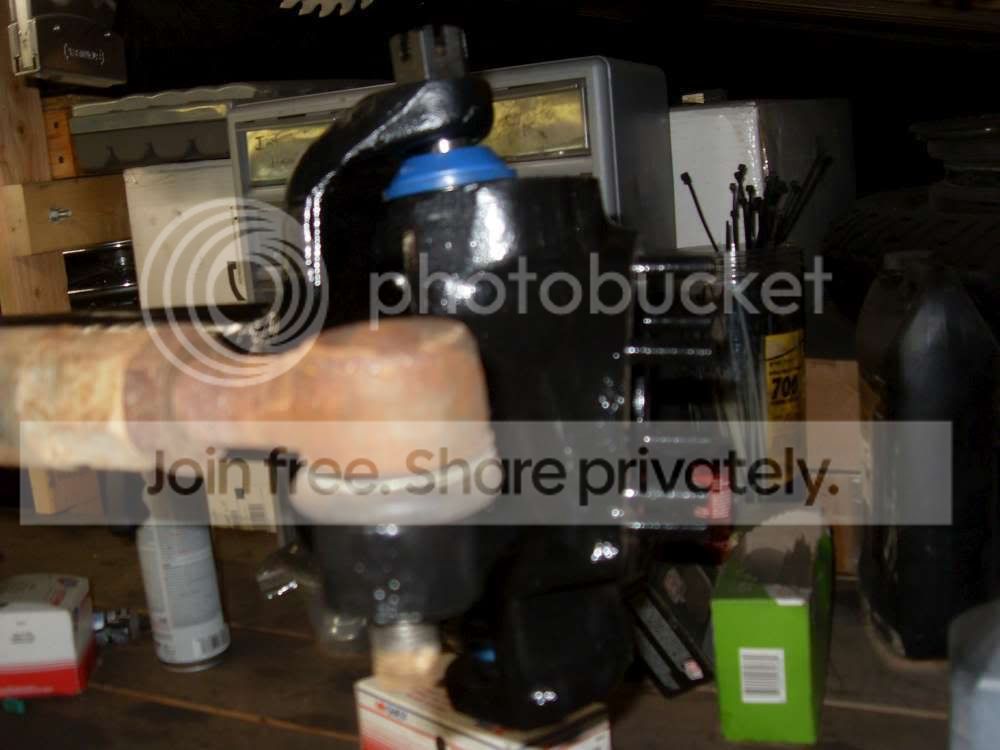

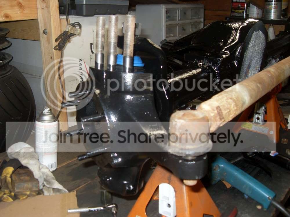

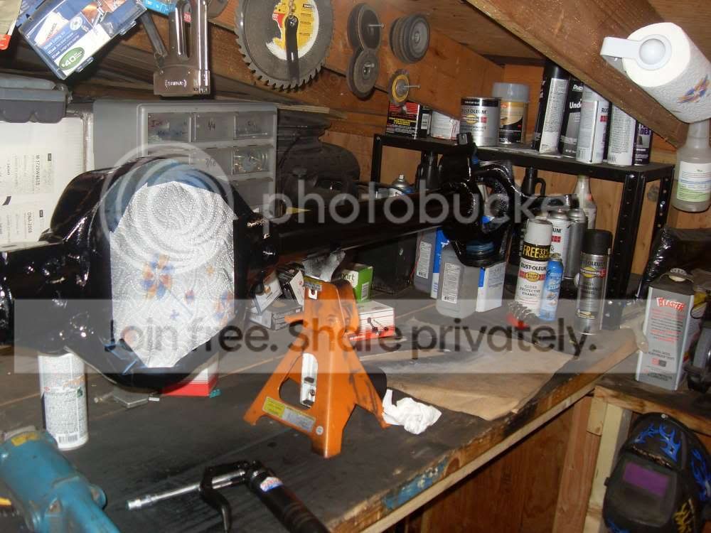

Heres my shortened housing. New WMS to WMS surface will be 63 inches give or take 1/2 an inch. I painted it tonight cause I didnt want it to rust because I cleaned the whole thing down to nice bear metal. Still need to put the brackets and wedges on when I mock the axle under the truck.
What do you guys think is this too much toe out? :haha:
Think I might need to shorten my tie rod :)
What thread size are the steering arm studs and the steering stops? They look like 1/2 fine for the steering arm and 5/16ths fine for the stops. I was to order bolts to fill up the holes on the drivers knuckle.
Studs for the steering arm are in fact 9/16" fine. Donno about the stops.
But I think that toe is just fine :haha:
-- A
Wow! All that clean shiny axle then you throw the rusty tie in to mess up the pic.:rolleyes:
Thats a nascar reverse setup go fast turn right?
All looks great. Makes me wish I was in the garage. But the way how often do you wang the old brainbox on that low ceiling?:doah:
I hit my head all the time. Im f'ing 6'5"...
O and my bench is super tall btw. I liked it at first but Im going to lower it.
I was wondering about both counts, figured it was a combo of low ceiling and high work surface.
I've changed the height of my welding table twice, I think, and wonder sometimes if I should make the legs adjustable or something. There are times where I'd like the workpiece at eye level, but then mostly I want it below me ... :dunno:
