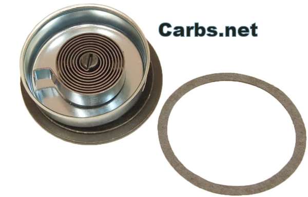

That cover is not matched to the housing/lever.
You need the one with the loop.
You don’t have the slotted choke housing lever.

1982 Chevy K30 4x4 with 454 and 4spd manual, what cover do I need and where do i get it and what is the part number?
I verified with like 6 different places that I have the correct cover, so frustrating.
You can see the differences. The little black seal has to be in the housing for the shaft.
The other plastic piece is the seal between the choke housing and the carb body for the vac bleed.

Call these folks and check with them this has the correct end. I have some cover but haven't found them yet. at least not the non electric ones.
The picture is too small to see what end it has.
yeah, I couldn't tell either, give them a call and ask. I have ordered from them good service.

take the spring off the original and flip it over. that replacement doesn't have enough coils
