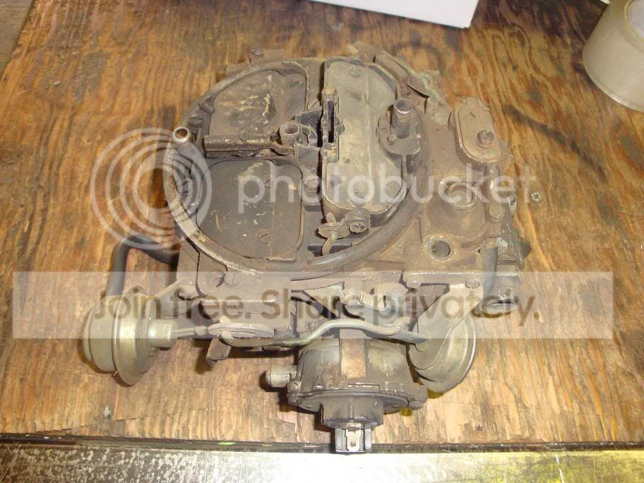

Here's a before shot of the carb. When it returns I'll get another photo for comparison sake.
