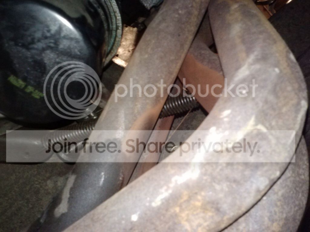

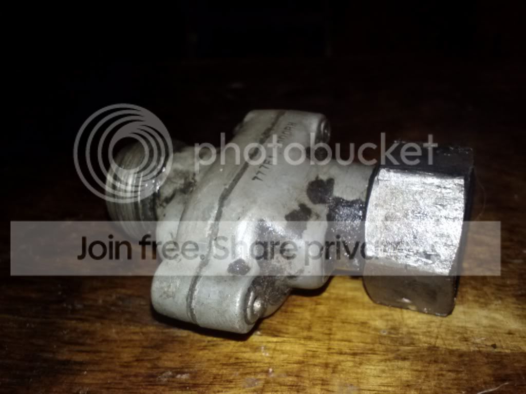

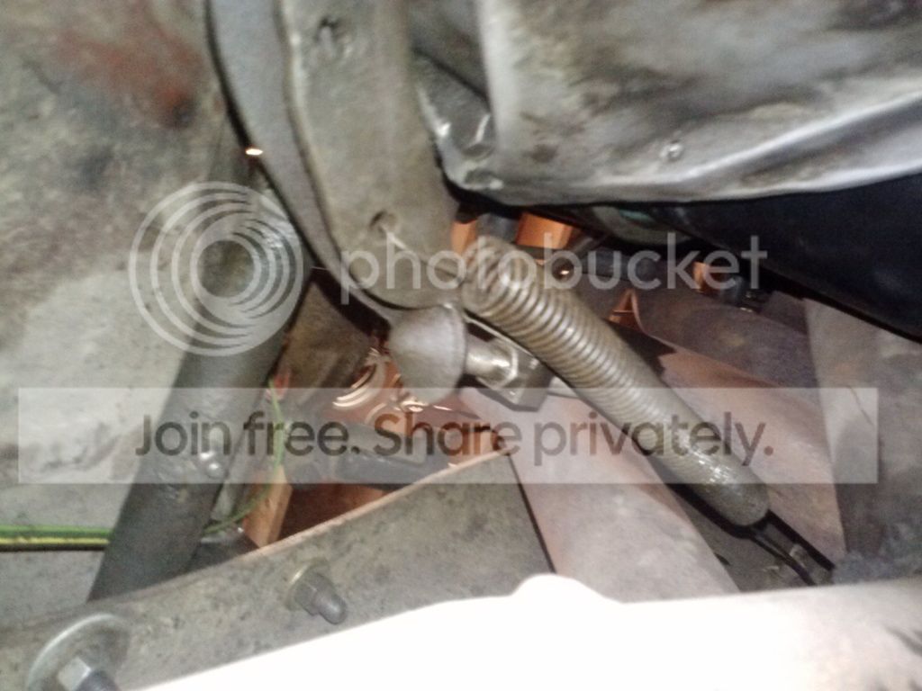

i figured out how to upload pictures. lol is it going to harm anything if the spring is touching the headers? or would it be better to dent my headers to allow clearance? it seems to engage and disengage fine but it worries me..
I honestly wouldn't worry about the spring, but what do I know. That piece between the tcase and cable is a speedometer correction I believe, so no you don't need it.
