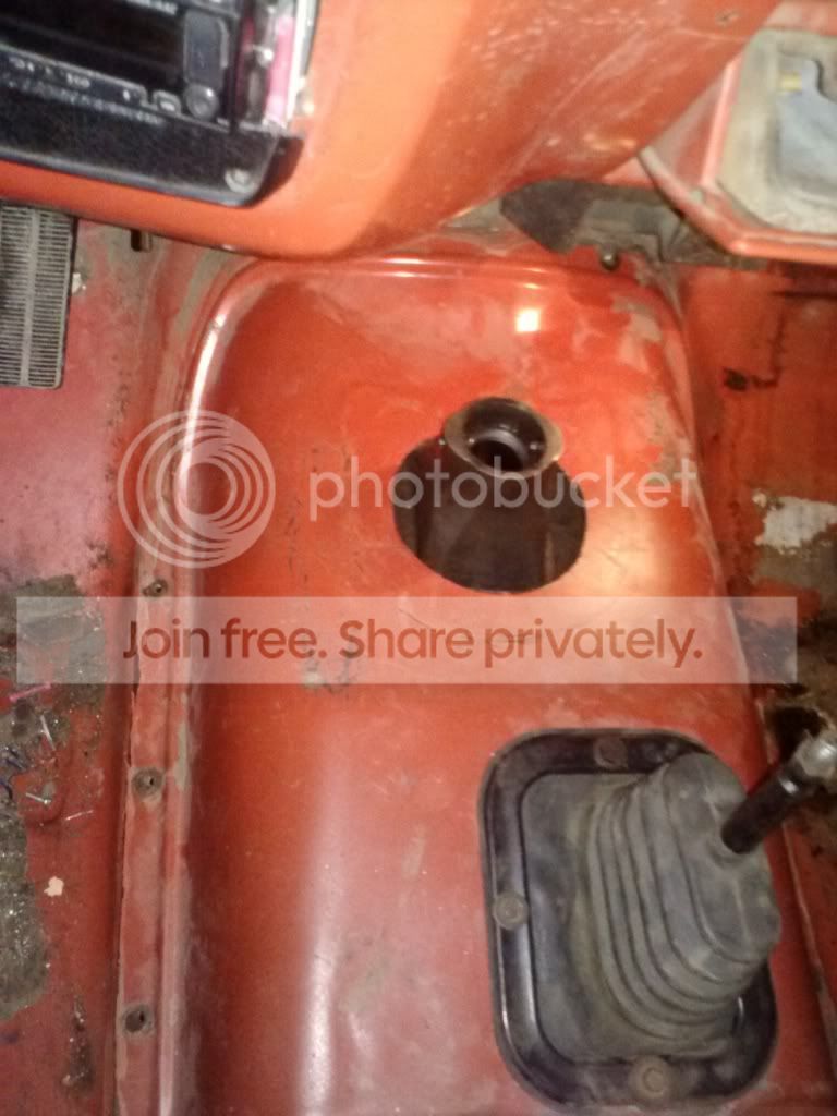

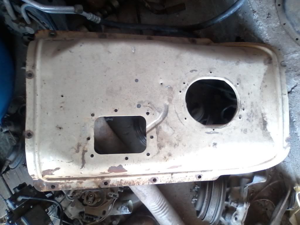

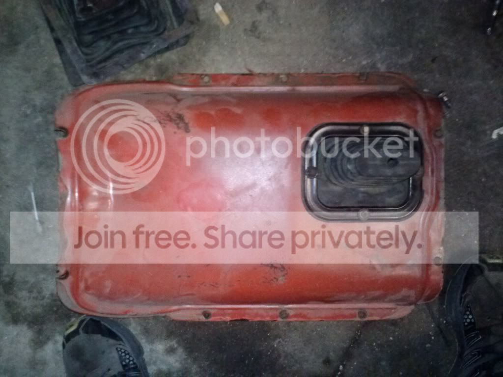

started as this...
did some quick measuring and cut on the lines as good as i could..
it didn't turn out to bad!

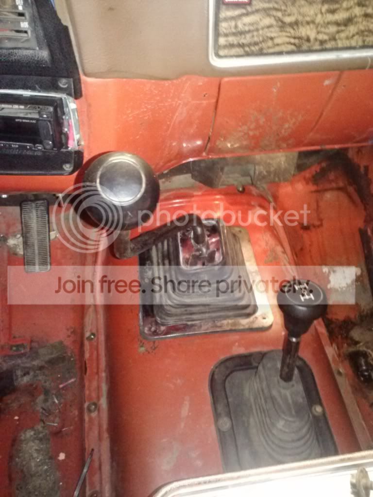

thank you! hopefully i'll be getting my rear driveshaft in two weeks after i get back from texas
Yeah, I could tell by the round shifter lever. An NP203 has a flat Hurst shifter.
