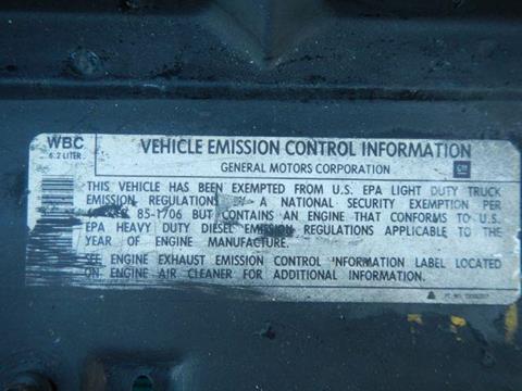

Do your Nazi inspections require a smog test? Does that tie your hands when it comes to exhaust mods?
Of course, if someone asked to smog my M1009 Blazer (R.I.P.), I would tell him to read the sticker on the core support... :whistle:
:haha: :rotfl:
:haha: :rotfl:
I've often wondered what CARB would say about the M1009 exemption.
