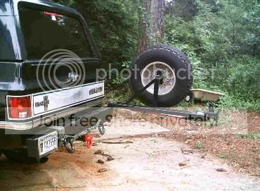

Need Help. I found this rear bumper on another site. I really like the low elevation of the spare. Does anyoneone recognize it (brand?) or is it a custom fab job ? :dunno:
Thanks in advance.
Just to point something out, that rear bumper style looks great on paper, but the added leverage on the bolt were the carrier hinge is located always eggs out sooner or later, causing the carrier to rattle and bounce around while driving on the street, and the only fix is to torch out the old bushing and weld in a new one along with a new hinge bolt.
As for something more stout, this may be a better option, the whole carrier swings down to the ground, preventing you from busting your back trying to huff that tire around, also there are two pins and two hinges holding it in place. This is the same style I wish to fab up for my truck soon, hell I even have all the steel to do it :doah:
As far as your question goes, I would say that could be a manufactured bumper, Smitty Built used to sell one similar to that, however "some" home brew jobs can look professional.

I'm looking for a swing out carrier as well. I went to my local shop. The guy does great work, but he would not even touch my Blazer for less than 1,000 bucks. After I had my blow out and not having a spare I really needed something ASAP. So I came up with this the other day at work. I know it's not the best but, I hope it gets me by for a little while until I can buy something better. Can of black paint and I'm good to go. For a while! :)
Blaze, thats mounted in the receiver right? What did you use for a pivot point?
