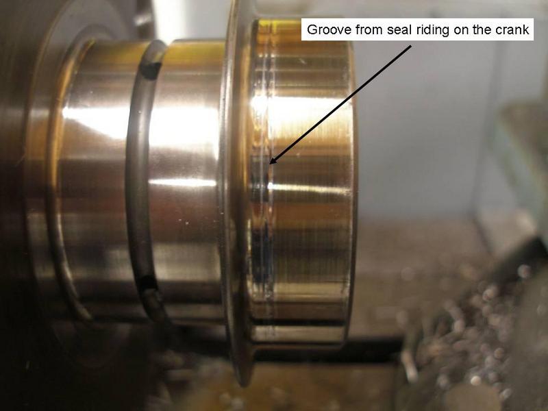

Worst case the crank seal area is grooved and will need a speedi sleeve....still not a deal breaker,,,just adds a little to the cost of repair parts...
Sorry guys, Finals have me running ragged. Speedi sleeve?
I think it's a 6 cyl. I heard about the top end leaking and draining down the back, does that happen with the sixes? I dont blame my stepdad for being fed up, we just had a decent ice storm. The leak doesnt look that bad, well sitting, and she still drives it around. I think Im just going to tell him to wait until spring and ill help him tackle it in the driveway.
The original seal can wear a groove in the crankshaft where the seal lip rides against the crank.... if you stick another seal in without correcting the groove..chances are the seal will start leaking again...
A speedi-sleeve can be installed on the crankshaft to "repair" the seal worn surface....
Problem is.... they cant be used on all cranks as the sleeve needs to be driven over the end of the crank..and some cranks are designed with a flange or slinger that is larger than the seal riding surface meaning there is no physical way to get the speedi sleeve over the end of the crank.
