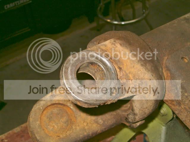

OK, tearing it down now.

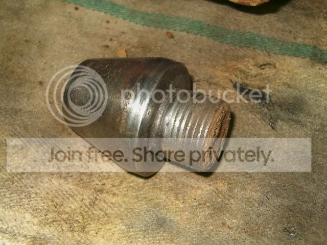

They used a spreader on mine I know. He replaced all the bearings, and the inner seals while it was out, and added the lockright also. The main reason I took it to an axle/drivetrain shop was the kingpin was so bad I took it out by hand...I mean it was wobbling in the threads:

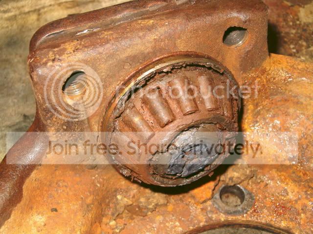

Yeah, I was pulling this thing apart and thinking I could have ran it as is!

:eek1::eek1::eek1: I don't feel bad now, mine wasn't quite that bad, close, but not quite.
I started with an axle that was maybe worth 700 bucks, I piece mealed out all the parts getting everything as inexpensively as possible. I'm still into the Front axle well over another $1500.
