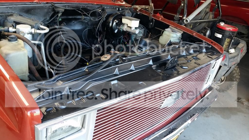

I painted the radiator support and firewall with rubberized undercoating and satin black paint.

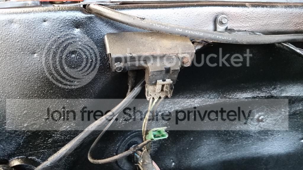

Ok, WTF is this?

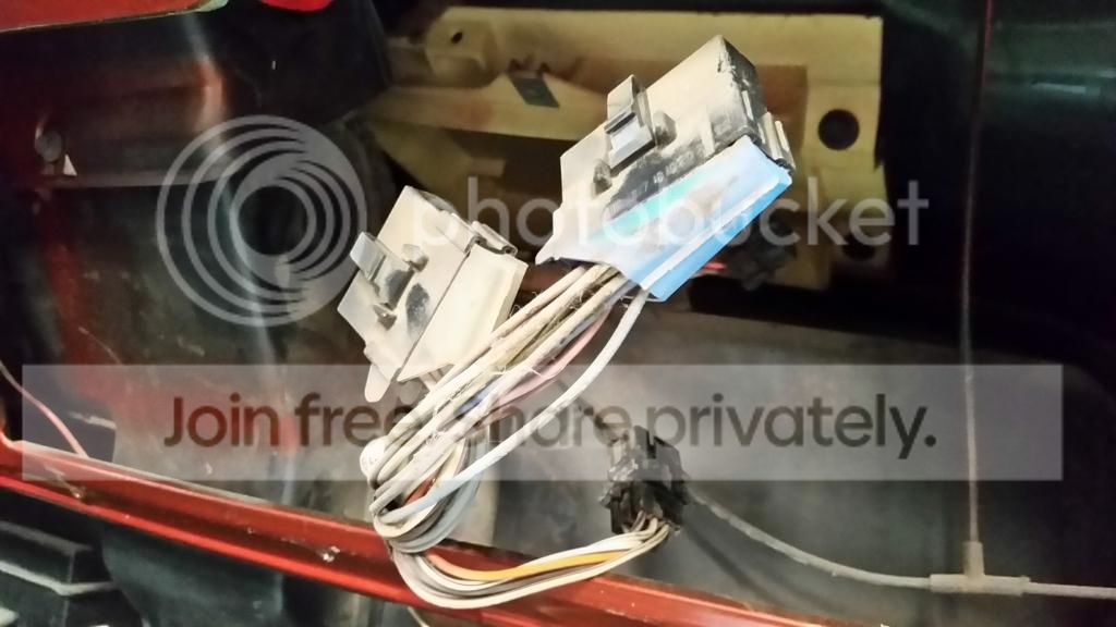

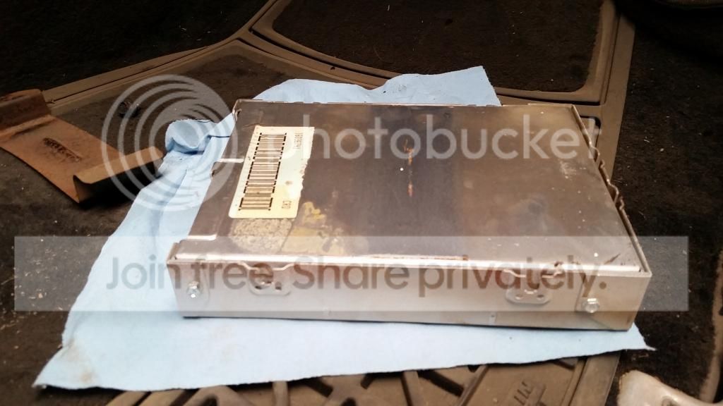

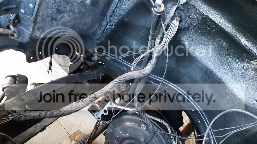

I need to get wires sorted through here, I believe most, if not all can come out of the K5 completely, as it should be just stuff for controlling the CCC carb/distributor and trans. Pulled the old original computer out too, obviously. I'm hoping the new LQ4 computer will be the same size and could go back up into that holder under the dash, and bring the new harness through the firewall, just like the current old harness.
The traditional wiring like the wires that light up the fuse box, solenoid start, distributor power, oil pressure, electric choke, those wires are a seperate harness and are not pictured. What is pictured, is all the california specific CCC wiring/computer. As I said, I believe 95% of that can come out, but a few power wires might be handy to retain, along with if there is anything specific to controlling lockup on the 700R4. I'm off now to go google.:doah:

WTF item is a "vac sensor" that appears to be unrelated directly to the control of lockup. The torque converter lockup hotwire coming out of the computer goes three different directions. 1. To a brake switch, to the TCC solenoid, and an unknown 3rd just yet.
IIRC, non CCC trucks without all this crap just have a vacuum switch and brake switch to control lockup. Unfortunately, the LS computer can not control lockup of a 700R4, I asked.

computer will not bolt in . might fit under dash with some light fab work .
but stock harness is wired driver front fender for computer and no real extra slack to go were you want it .
lots of guys rework the harness to fit that way but takes time .
my 85 c-10 build I am doing driverside batt tray and new ls computer oem gm bracket and cover to hold it like it would be in stock truck but in my older truck .
The computers are designed to be mounted in the engine bay, I wouldn't be afraid to put it there.

I got the wiring harness completely removed yesterday for the CCC garbage. Glad to see that crap go, along with the vapor canister. Those two things alone cleaned up the engine bay a bunch.
