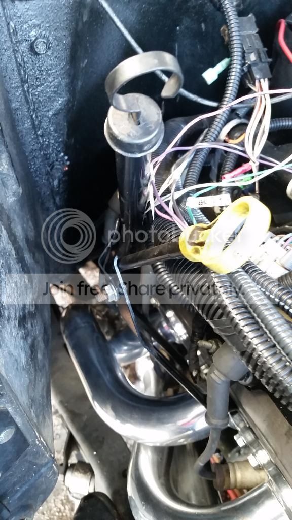

Finished the fuel system, torqued the header bolts, poured 5 gallons of fresh gas in the tank, finished the radiator hoses, put 3 gallons of water in, and fitted my tranny dipstick.
I changed the bends just a bit on the trans dipstick, cut the tab off, and rewelded it on closer to the top and bolted it to the engine dipstick bracket. I like it, engine and trans dips are right next to one another.
