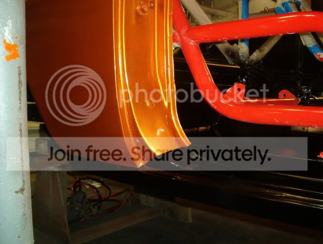

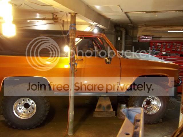

saw this truck for sale on CL and saved the pics since I hadn't seen anything like it before. Looks very similar to what you want to do.
You do have to trim the bottom of the door on that also correct?

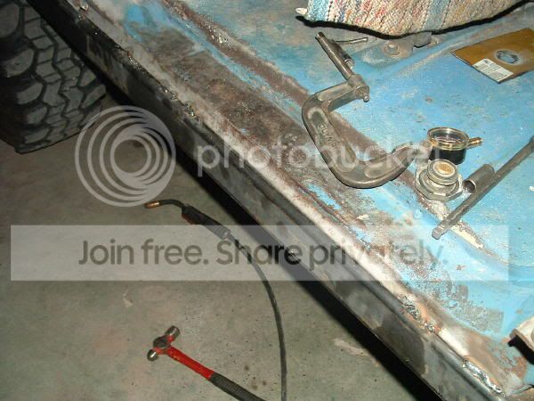

I tried to find pics but couldn't find any. Just a normal type gusset but I brace the floor by welding large pieces of 1/8 to the bottom of the floor. It's the surface area that is key. Takes a long time to do it right but we'll worth the effort.

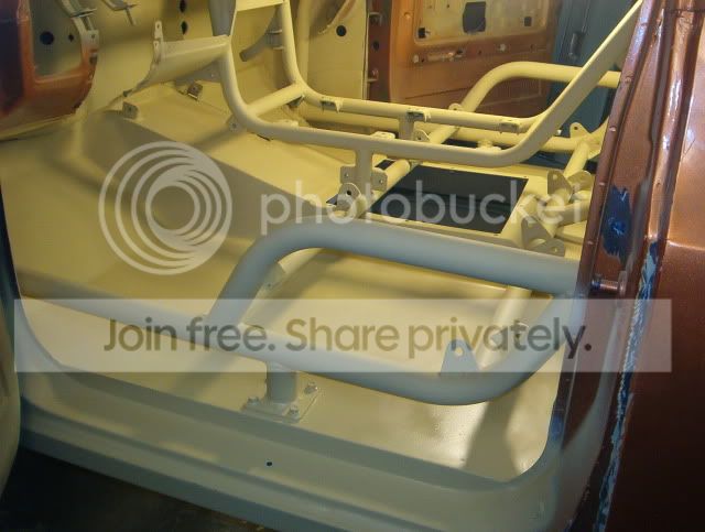

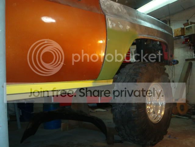

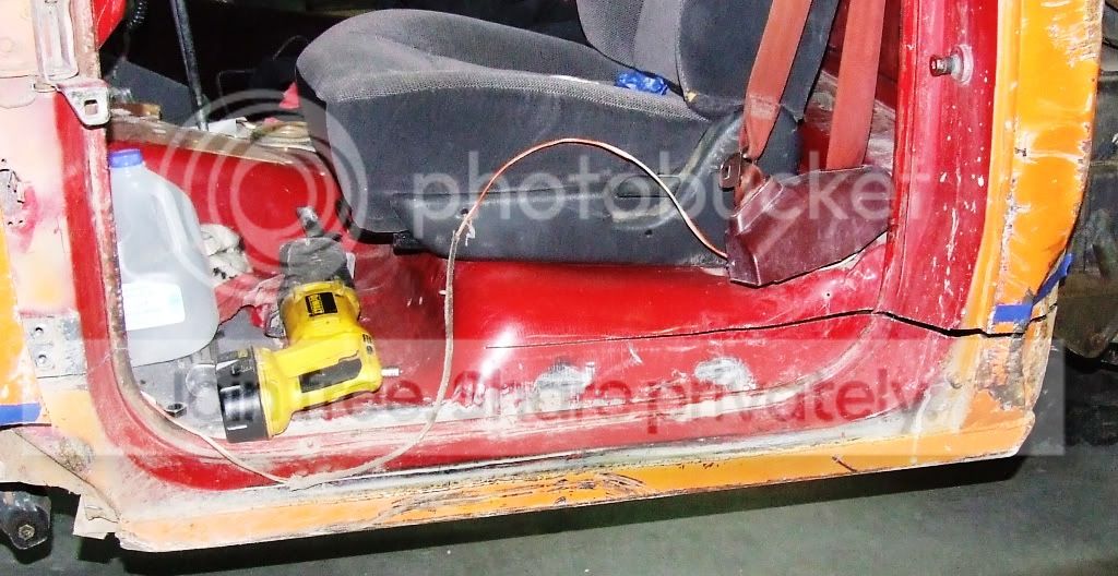

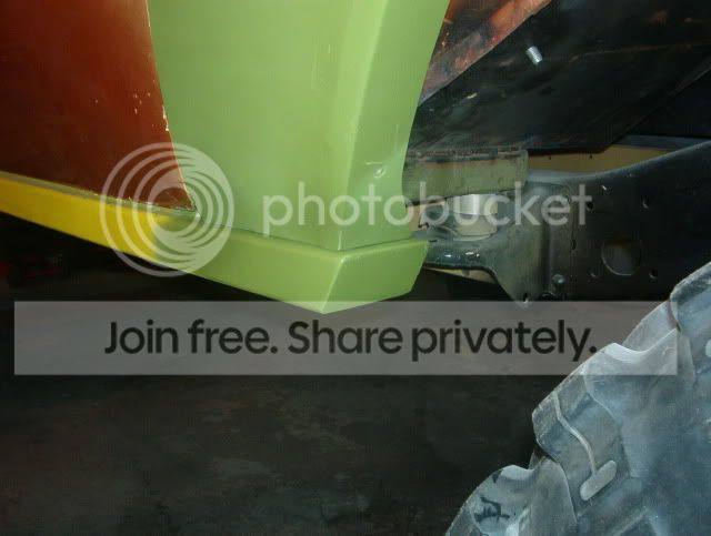

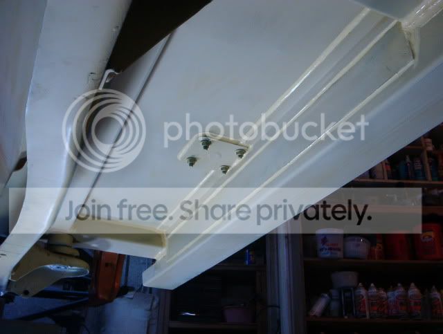

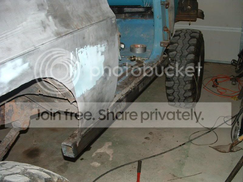

didn't really come across any good done shots for ya.. but here's some of my 2 x 4 integrated one... thru the process somewhat...
it's actually mounted directly to the cab supports too... ends at the sectioned fender and qrter openings...
how it ties into the custom supports/floor..
