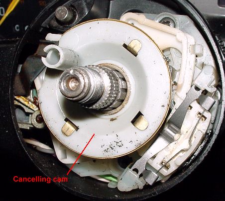

I broke the stem off that pokes through the daisy wheel thing you have to compress to put the keeper ring on...it makes the horn work. Whats that plastic piece called? I can't find it anywhere.
OK...I found what it is called...a "cancelling cam".

I only had one part left over and I could not figure out where it came from...everything seems to be working ok without it.
This piece goes under the one you just replaced.
