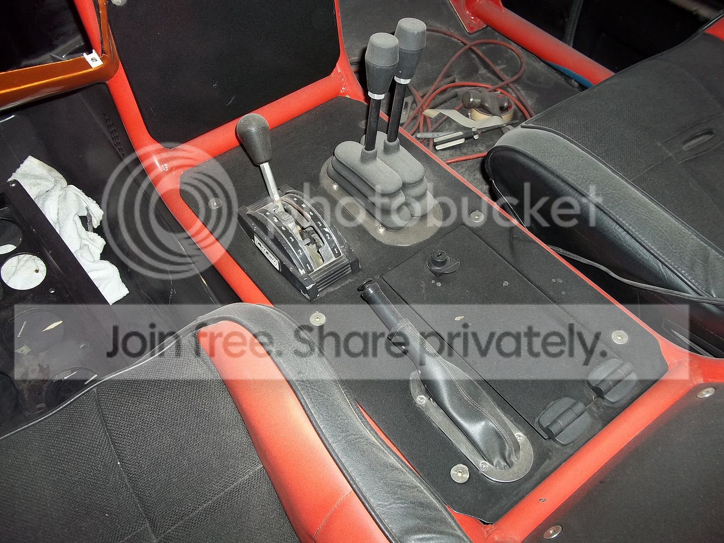

dusty, but ya get the idea...
That's a sweet setup Paul but you have bucket seats. I'm running a bench and plan to keep it.
