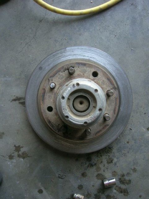

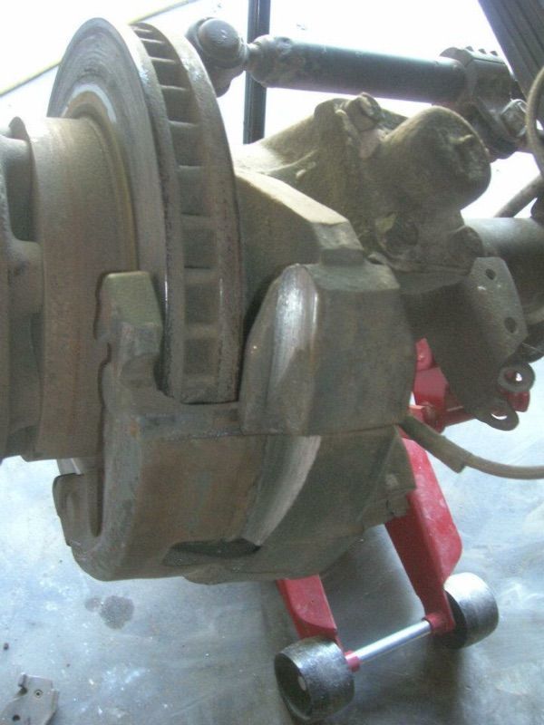

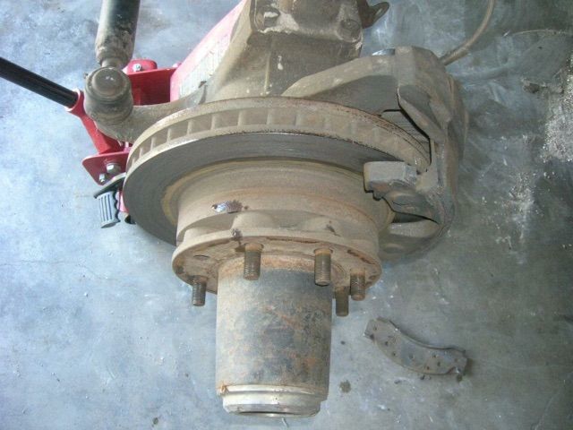

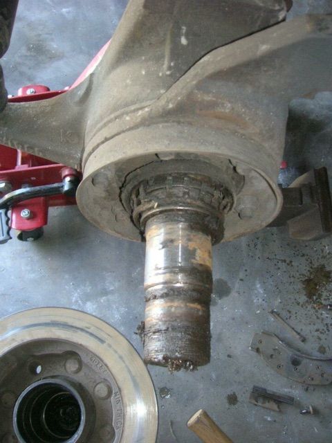

The dust shield is unnecessary. You can discard it.

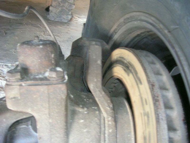

Unless you run wheels with stupid offset, you have to grind for 15" wheels with 3/4 ton calipers and rotors.
Martin
The wheels I have my eyes on are all 3.5" backspacing. If I have to grind on the 3/4 ton calipers I'm guessing it shouldn't be much at all. I read a tech article on here awhile back and the OP was fitting 15" wheels on a D60, if I remember correctly he only had to knock off about 1/8" of material from the 1 ton caliper.
