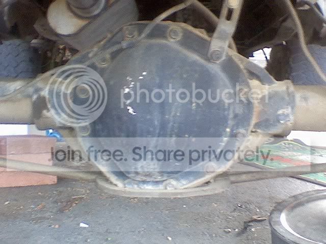

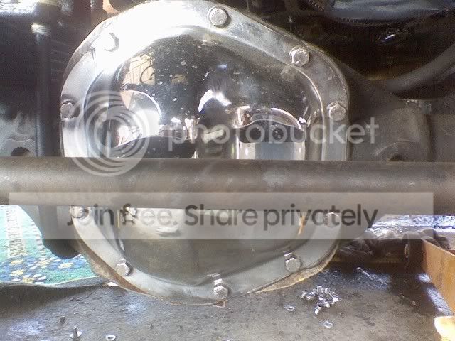

right on man, thank you. Yea I must have got them mixed up last time I counted. Yes 12 rear 10 front...
Front (chrome cover because I thought I was going to be keeping the these axles, I hadnt got to the rear yet) waste of money...
Rear
Whats the bar under the rear end? I took the front one off because it was bent and thought I could hammer it back into place.

im sorry, but that is not a GM Corp 10 bolt with a chrome cover... you have a a Dana 44 and a 12-bolt rear. YUKON Gear makes nice hop-up kits for the 44. I would keep that and maybe go 8-lug hubs. install that 14-bolt Full Floaty rear, and you will be set.

keep the Dana 44 front... unless you are like me and just balls-out blow money on something that you just want braggin rights to... like the Dana 60. I like to go wheelin' and not really do any tough trails, my truck is too cherry. I just like to have the right to say, "i have a dana 60 under my JIMMY. And it will pull yo house off its foundation!" LOL!
