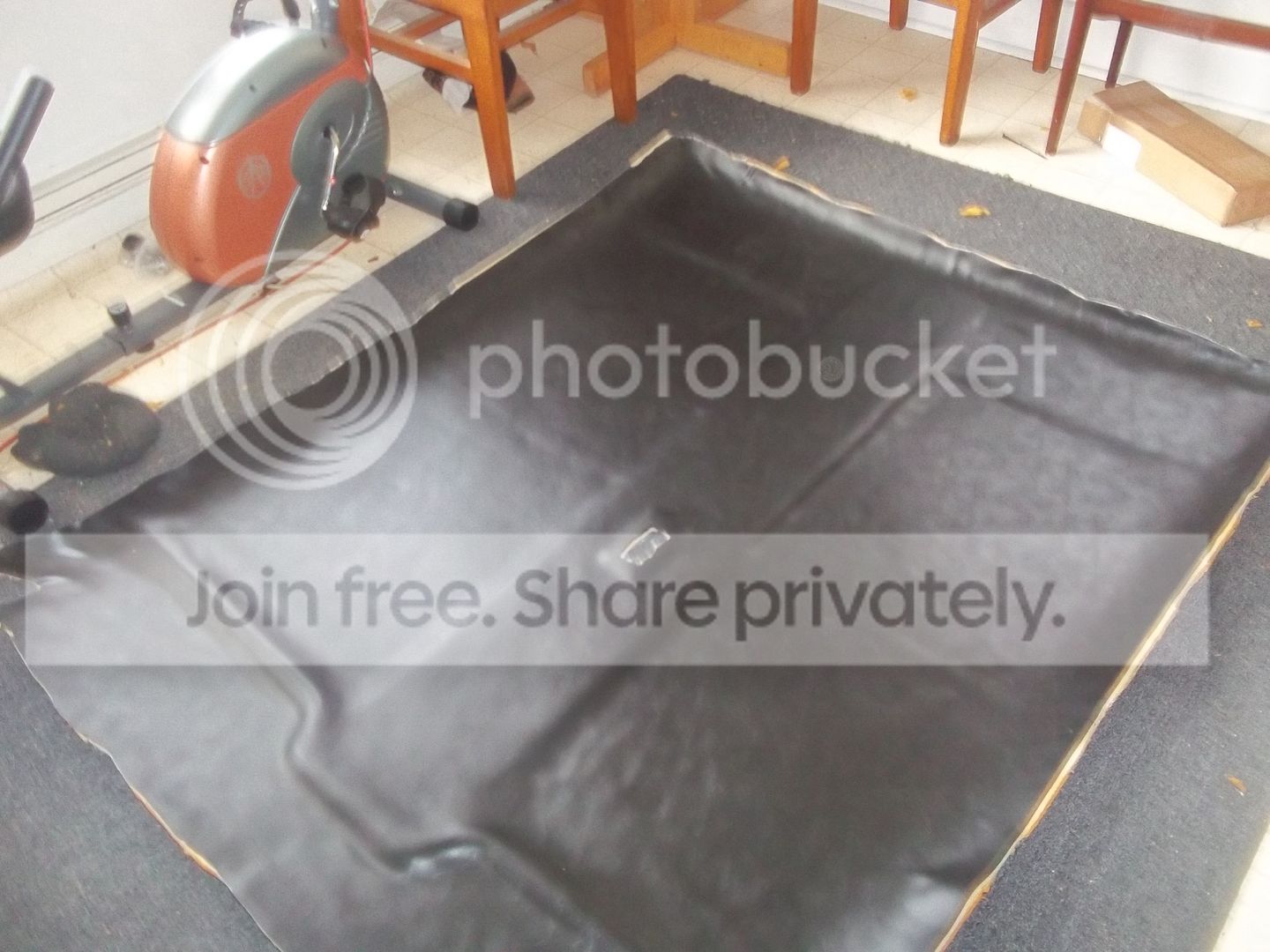

oh, and redid the headliner last night... it'll be awhile before I put it back in tho cuz I wanna wait till it warms up some to put the upper interior back together...

Thanks! I was wondering if it was in a spray can or not...1 can for a single cab enough?

well, I used every bit of 2 on the crew.. so, 1 would prolly do a regular, but you'll use every last bit... nd it also depends on the 2 surfaces...
being this was a 'foam" panel once the fabric was removed, and that vinyl has a 1/8" foam backing to it, I wanted a pretty good douche.. at least on the headliner side, and more of a skim coat on the fresh material foam...
just make sure you coat both surfaces and let it dry before sticking.. that's the biggest mistake most make with contact cement, being impatient and putting it together too soon.
That's a one time deal with that glue then.
If I mess up and put a wrinkle in it you can't just pull it up and try again, can you?
I wanted to use the factory material, it's still in good shape just sagging.

pretty much.... once again it depends on the 2 materials.. if you haven't rubbed it in, sometimes you can pull it back a bit and resmooth it... it is a bit more forgiving usually than say, laying formica with contact cement.. but yeah, generally you don't want to it pull off if ya can...
that's why starting from the middle, or an end, and working it and rolling it out works better than laying it on the whole thing..
I did that in 1/2's... took a sharpie and made center lines in both directions, on both materials... folded the material in 1/2.. douche, dry, apply, smooth.. than douche both the other 1/2's, repeat...
ya also have to watch with some materials, and bleed thru of glue.. that can mess with the color consistency, or smoothness, especially with fabric/cloth based materials..
that's why I generally like to buy the stuff with the 1/8" foam attached to it.. you can douche the he!! out of it without worry of the wet glue soaking thru the material...
