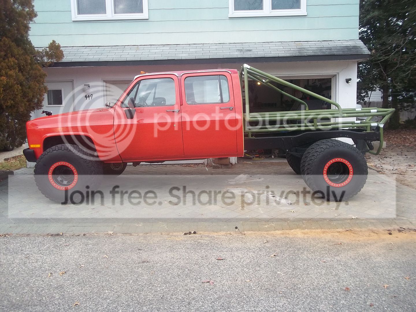

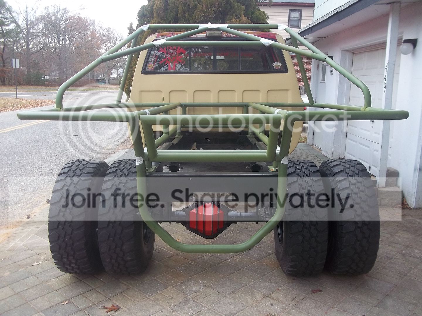

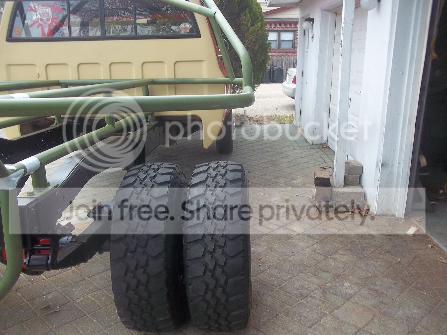

and here's how the tubebed width worked out to the meat... it's a solid inch or so wider... but the smaller lower tubes are going to be in some from that tube, so it should work out well....
it'll prolly help out with the flap sitcheashun too.... :haha:
