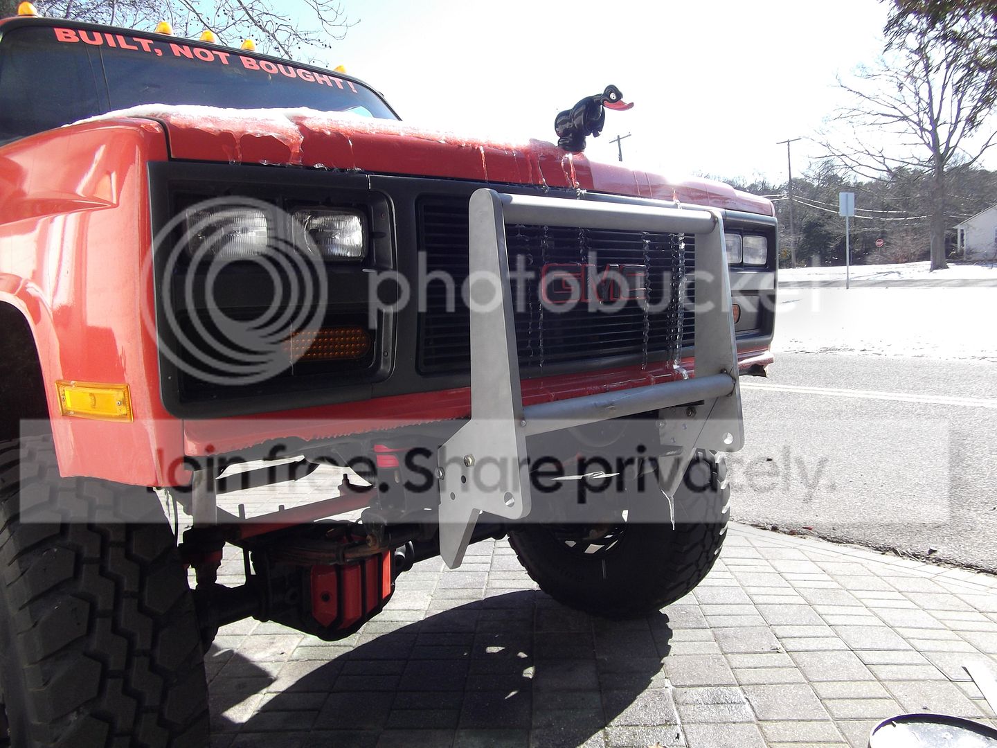

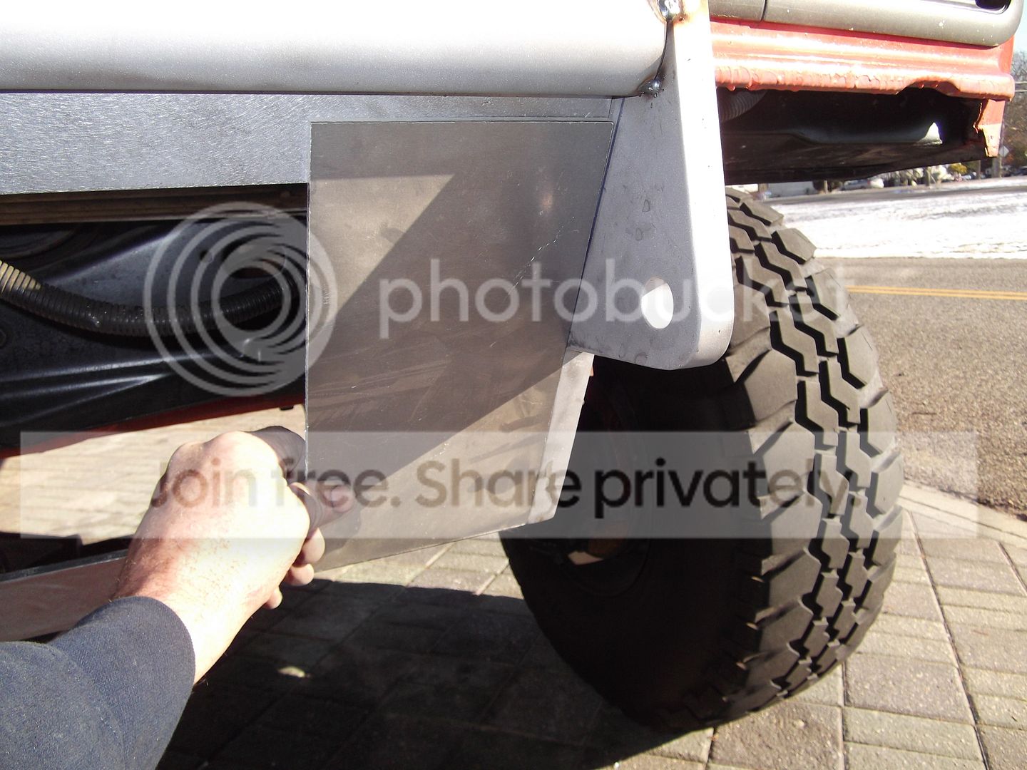

the beginning of the skidplate mounting structure......
as I mentioned, the skid will carry over the tubebed panel theme, same countersunk black fasteners.....
decided to recess it flush with the uprights for added Prius crushing capability.... :burnout:

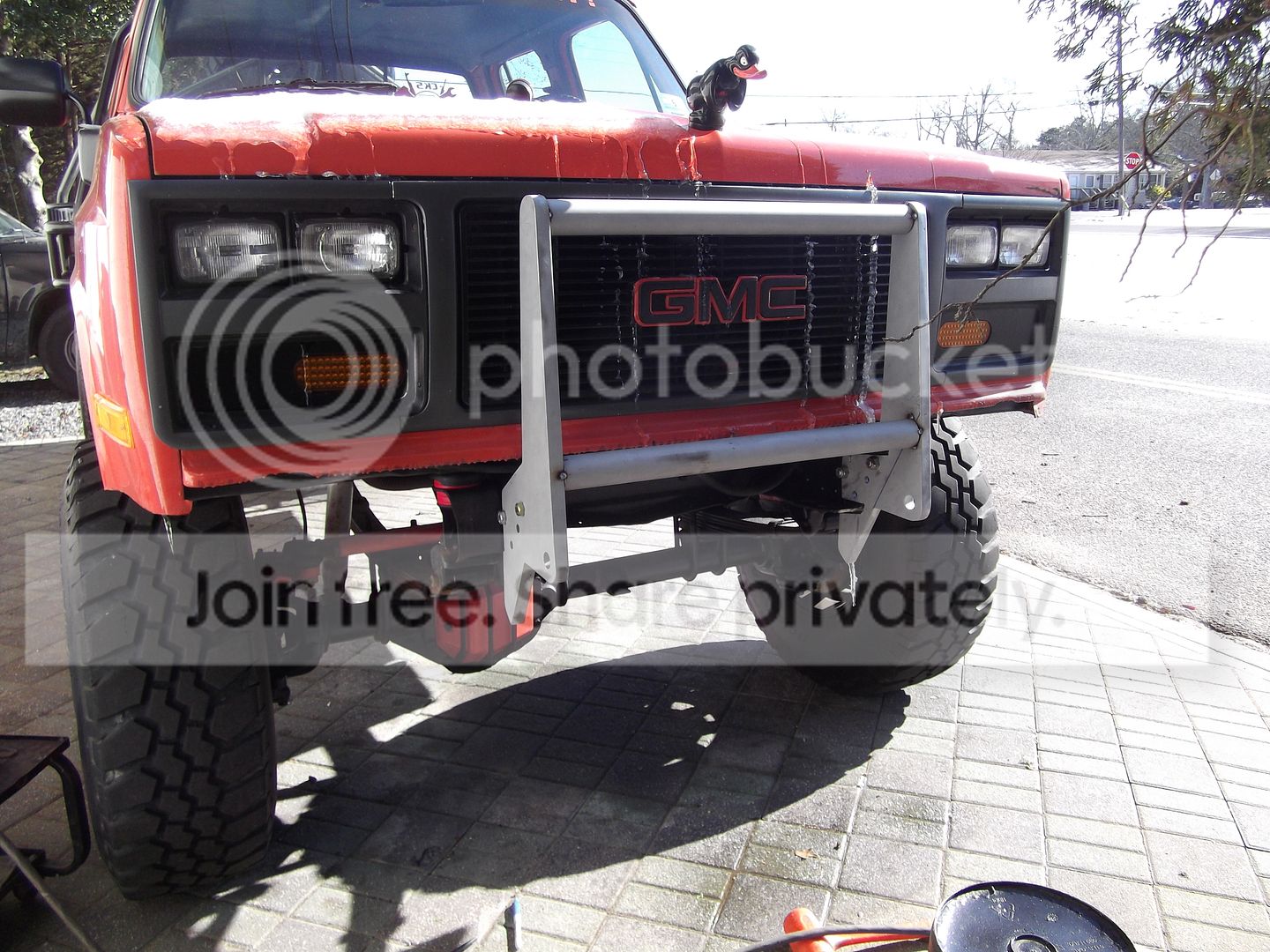

oh, a reminder of the plate and light setup... should leave a nice window for the GMC emblem...
thinking a pair of these....
I like it, but the first view of the opening of skid plate area reminded me of the Spartan Grille with Teeth. I really did LOL picturing those teeth in your skid plate area, just as you hit a Prius.
You know what... I like it the primer colour. Obviously it will be painted, I assume Black? But I like the way it stands out now!?
Will for sure look tits Black, but I wish it could pop more. You know over the top Sh!t!? Lol!
Geez Paul like your truck wasn't aggressive enough and just generally hugemongous. This bumper is gonna fit right in.
I'm seriously digging where its going though. Reading back through other posts its gonna be sweet
actually, that's all raw steel right from the blast cab.. I tend to pre-prep the parts that way, so when I'm done fabbing, it's just a bit of clean up than RG and color... and yeah, definitely the same satin black as the tubebed.... the alum skid should really help it pop hopefully... eventually when I go dizzle, I'll cut some slots in the alum for an intercooler behind it...

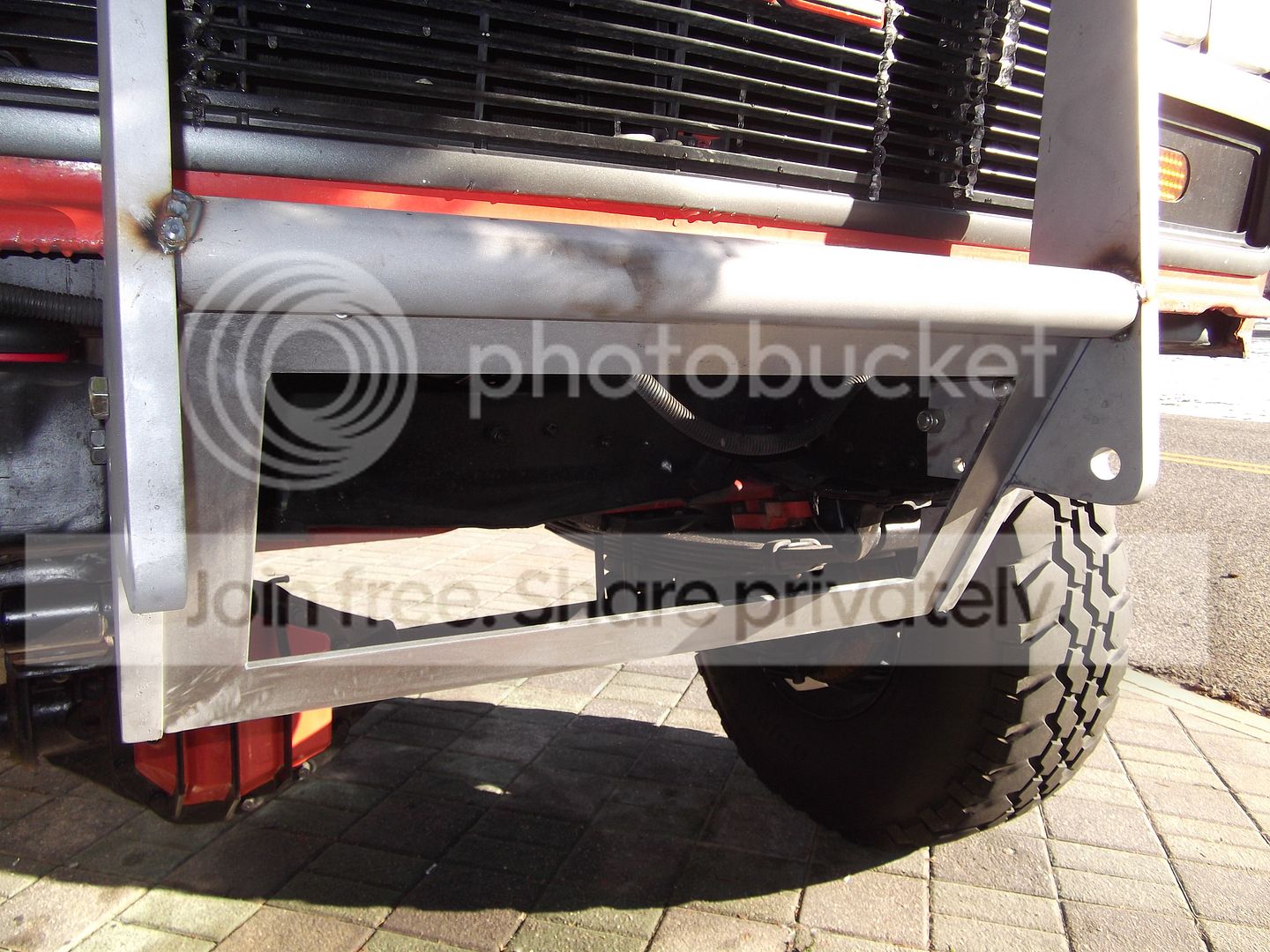

alrighty, didn't quite get as much done today as I wanted.. ran out of argon, had a couple errands to run too.... but I'll be on it hardcore tomorrow bending outer tubes... did get the 2 pieces done today......
added a piece of 2" x 1/4" across the bottom to stiffen it up.... and potential mounting for an intercooler, etc down the road....

and also got the top plate in.... it fills in the gap to valance and gives me mounting for the plate mount and lights....
when I pull the bumper off Friday to final weld in the garage I gotta fill in a few low spots on the front weld seam and regrind.... it's flush with the top tube, and follows the valance panel in back... 3/16 thick...
