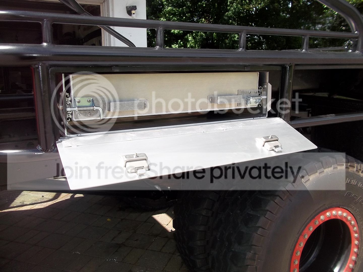

okay, I knew it was going to happen, so I can't really say "lesson learned", but it is time to pay the dues for impatience.. :doah:
the drawers are fugly... had about a 1/2" of sand, rocks and road debri in em... the metal will be fine after some elbow grease.. but the sliders are destroyed, well, 3 or 4 out of 6... plus a couple of the front latches got hammered too... so i gotta call the company this week and see about replacement slider costs, etc... probably a 3, $400 faux pas in the end...
over the winter, I'll be reconditioning all the alum, fabbing the dividers and tops...

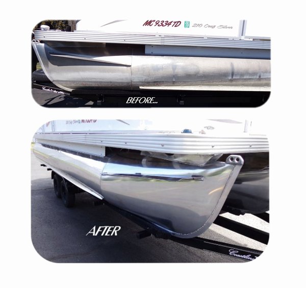

after having the tubebed on the street for a few years now, I'm very happy with my decision to just give, and continue to just use a combo of 220 thru 400 and scuffpads, etc to keep the alum looking decent on the outside...
that calendar shot basically just had me wash the rig the night before, and wet scrub the Al with a scotchbrite pad and laundry detergent.. there's actually some real healthy scrapes in the Alum currently on the 2 large panels, I work the heck out of the rig with total disregard for scrapes, etc...... but from 10' and beyond, you wouldn't know...
i hate to think of the tedious upkeep I'd be having if I had polished em to a mirror! :doah: :whistle: :doah: :haha: not to mention, lawsuits from blinded drivers... :yikes: :pimp: :rotfl: :cool:
Wow, they rusted fast. You really need to put tops on them and seal it all the way around. It's the only way you'll keep everything inside clean.
absolutely.... when done, there will be 2 ways protecting them.. the belly pans will keep 99% of stuff from ever even getting near them... than the tops will keep everything "in" the drawers and stop anything from getting into the top area.. the only "open" space to the drawers at that point so they aren't technically sealed, will just be the 1/2" or so gap around the front of each drawer, behind the outer folddown doors... and that's fine...
