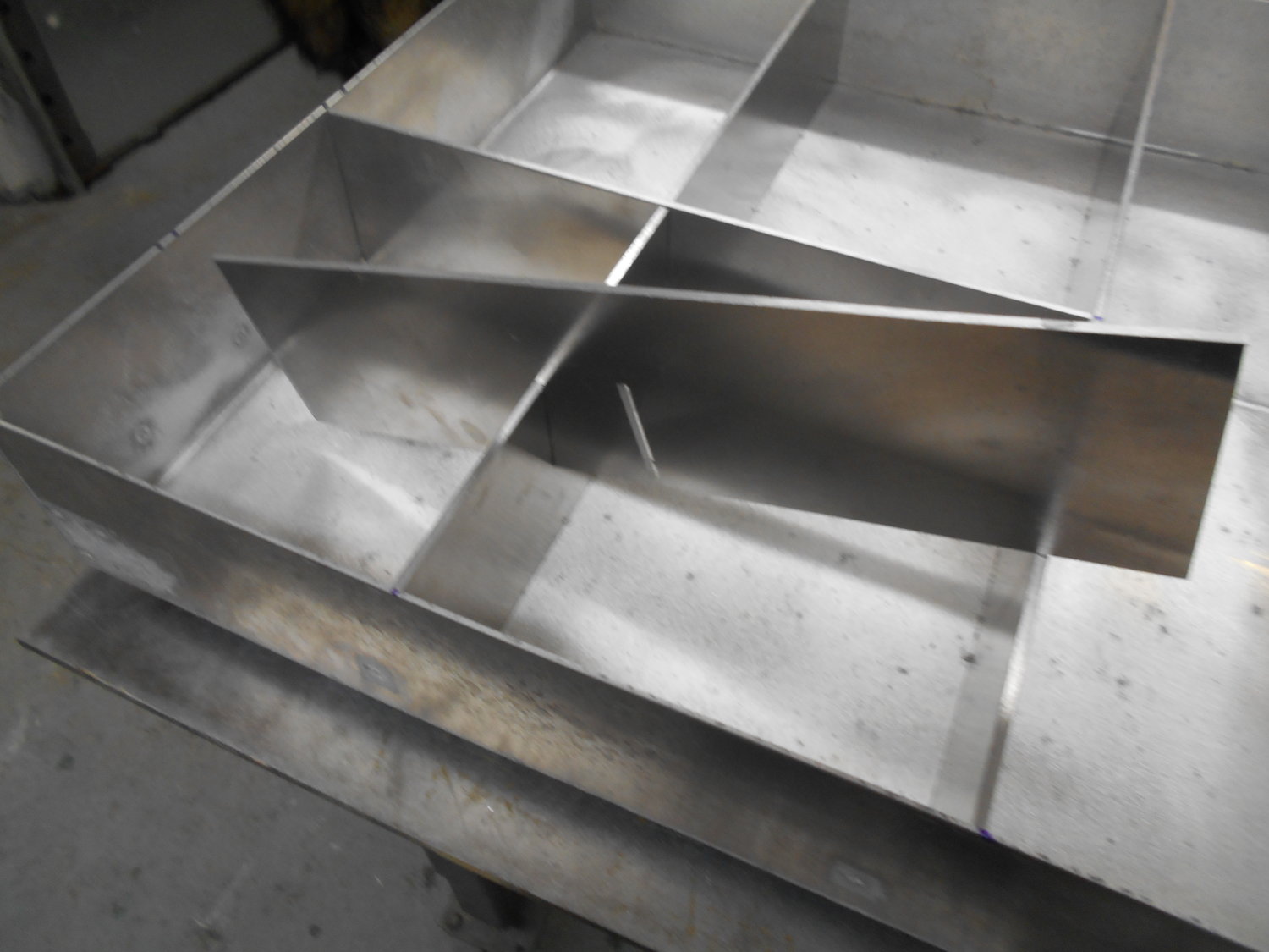

Not sure my brain just didn't catch it, but how are you keeping the dividers from spinning around inside the drawer?
you're one of them there idea-r guys...... ;)
funny you mention that... :haha: i meant to update.. that one slides in nice and snug, doesn't really move (benefits of the beltsander).. but yes, being 4 points,you give it a pop and it will turn.. so, it actually does go in/out with the drawer in.... :o
now, that can't/won't happen with the others as they will have multiple contact points... the simplicity of this one is screwing me..
to be honest, it's definitely snug enough that i could prolly leave it.. that's the "hard cases" drawer... but i will probably put a tack at the top of a couple walls.. like i said, gonna have to do it on that other one anyway... so i'm down to 2 removable.. and that's fine.. i kinda figured that's what it would end up being...
still don't think I want to fully burn them into the drawers tho.. couple nicks of a cutoff wheel will pull em out in a pinch... but i will more than likely burn all the divider joints in.. waiting on wire coming monday.... starting to get my feel back for flowing Al again... burnin the box in took way less time than i thought it would....

Could burn a couple of tacks onto the walls to make some ridges for the dividers to slide between.
good idea, i did think of that... than if i ever did reconfigure it, i could just add a couple new tacks, and grind off the old ones... i guess it boils down to how much i want the dividers to be removable... the amount of tacking/grinding will be minimal either way...

Maybe lock in the back side with just adding two more pieces from each back corner to the center X. Hold em in with Velcro or two sided tape.....or something. Should lock everything in and nothing is permanent??
Edit: or make the added piece on the back side run from corner to corner and cut joinery into the added piece and the back top side of the X so they interlock? Tough to explain, maybe?
you made my brain hurt..... :haha:

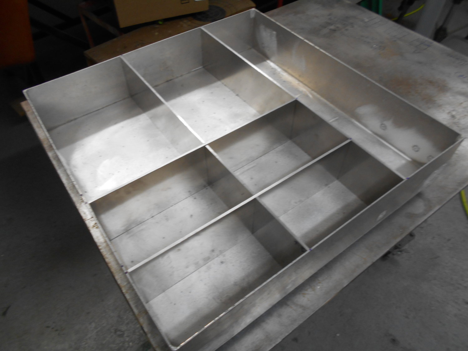

the jenga interlock is how i did the dividers... if you were tacking/welding them to the outer perimeter, you wouldn't even need the full beads at the joints.. the overlap deal was nice and snug.. nice 90 corners... but if i did that one, i'll do the rest.. need the trigger time anyway..
Jenga.....
full
this was the config that will get tacked due to the full compartment to the right...

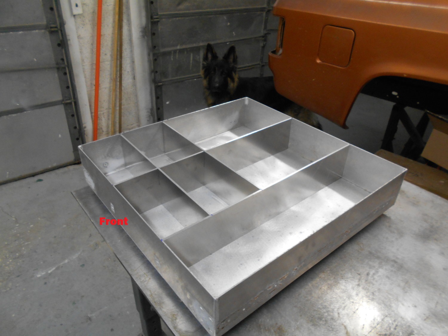

Drawers look great!
