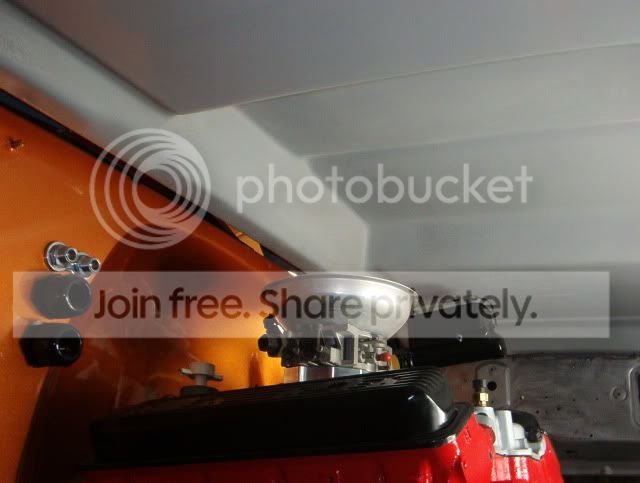

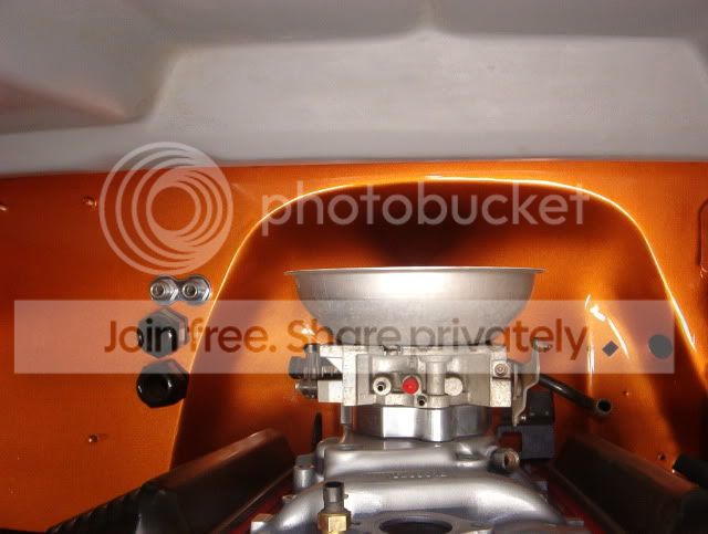

I just realized that's one no one's ever asked me about.. getting rid of the weld seam in the curved portion of the firewall.... welded up and ground smooth.. really gave it such a cleaner look than that factory seam they all have....
Man I thought something looked different....I just couldn't place it...dang that firewall looks good...
Given what you said about a satin black, would you still paint the inside of the fenders the same color as the outside or would you go with an all black engine compartment?
