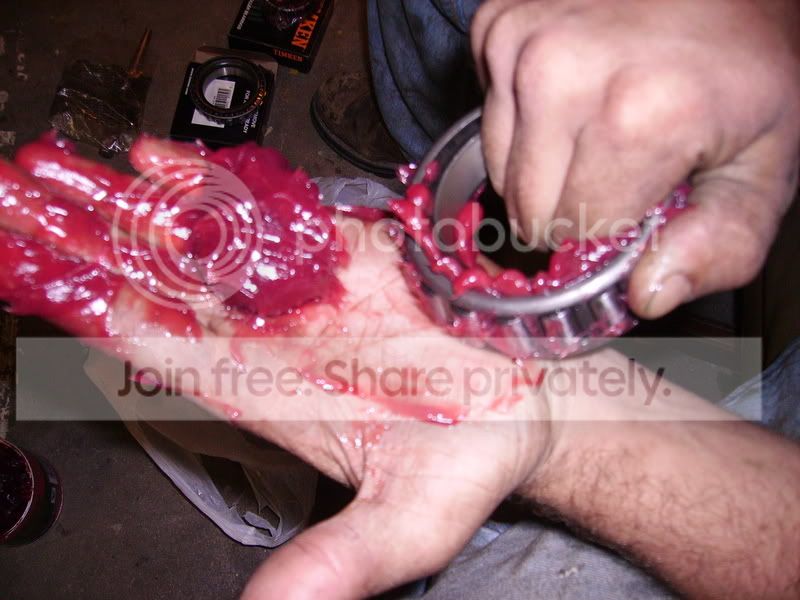

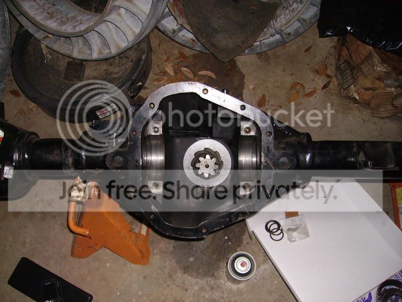

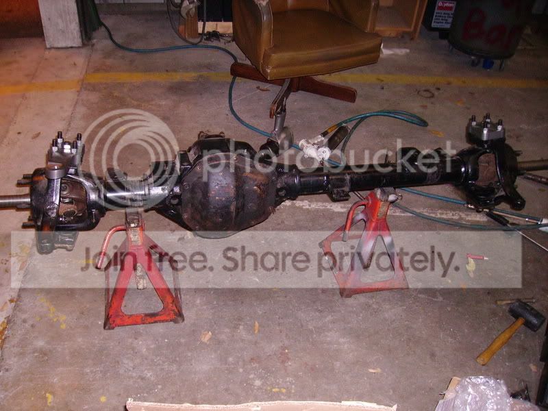

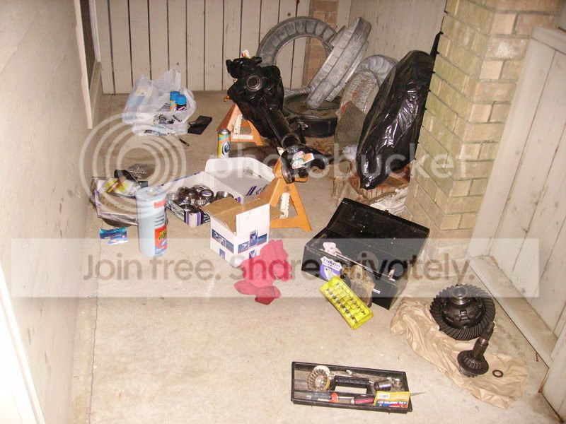

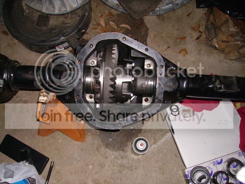

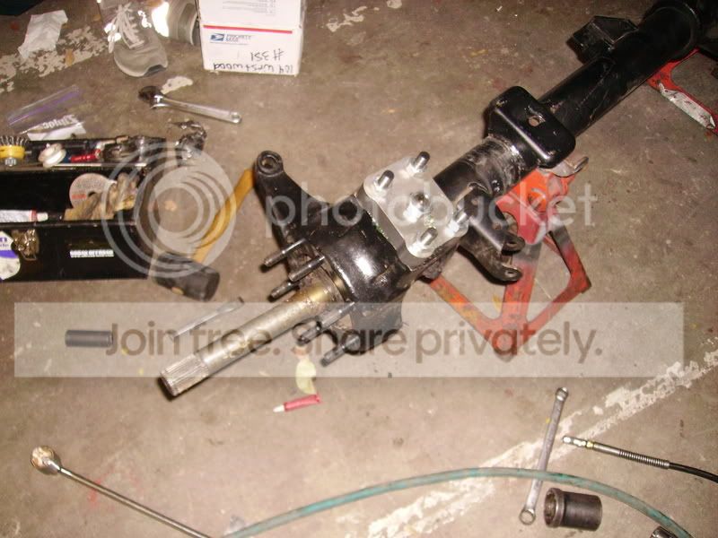

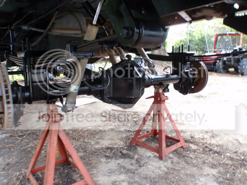

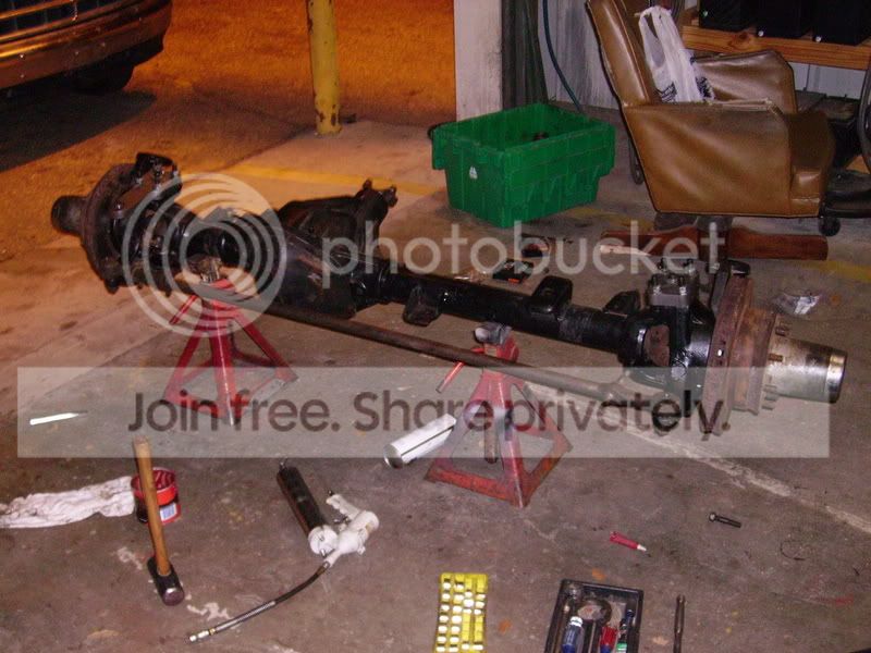

got a tiny bit done today, but was halted by the lack of a correctly sized socket for the pinion nut... other than that all i have to say is, setup bearings/races are splendiferous (sp?)

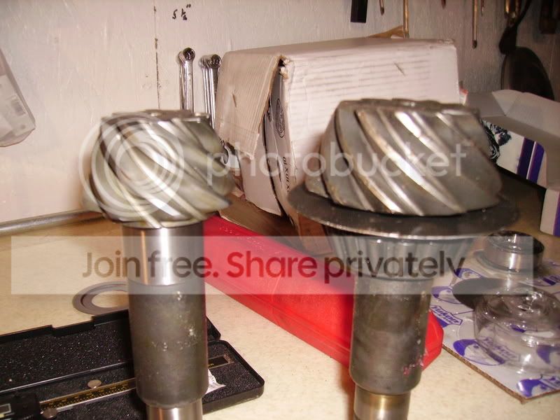

5.13 pinion head along side the 3.73 pinion head

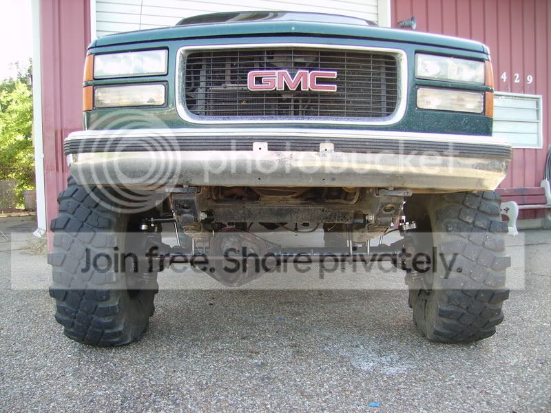

are those xml's? do you drive on them on the road? if so how do they ride?
holy crap its been way too long since ive updated this thread!
better late than never i suppose but to answer your question they are a $hitty tire that i wouldnt recommend to anyone honestly

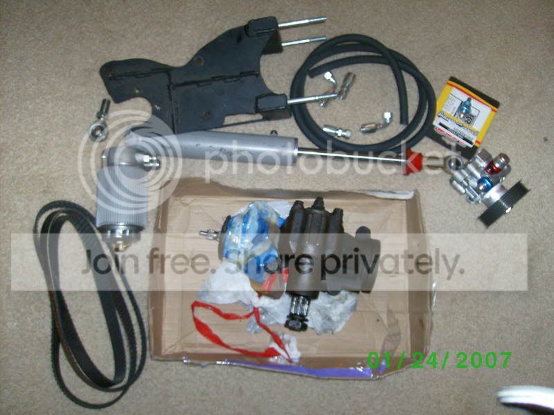

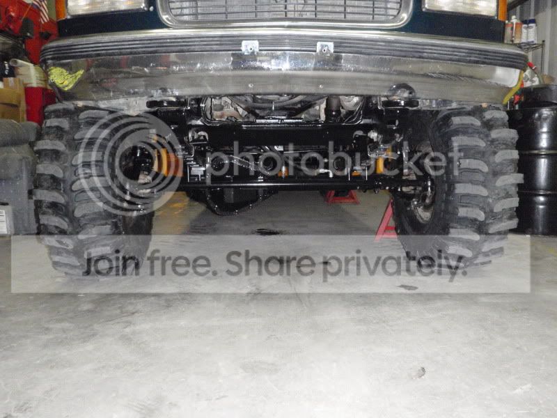

for your viewing pleasure hear is what little ive done over the last year...

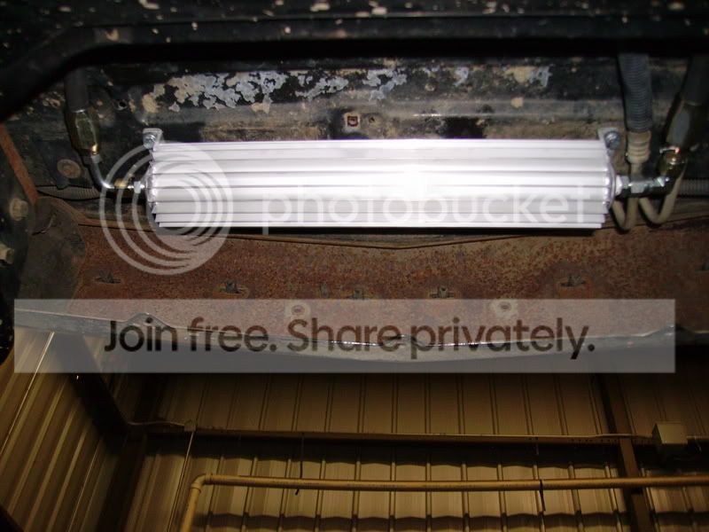

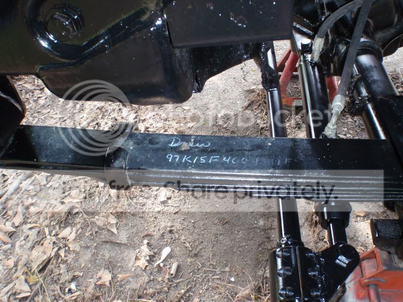

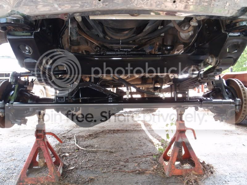

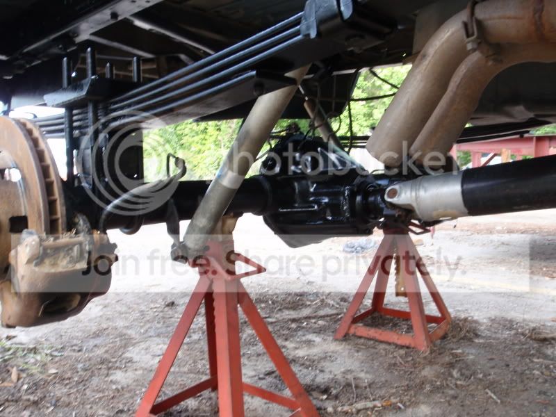

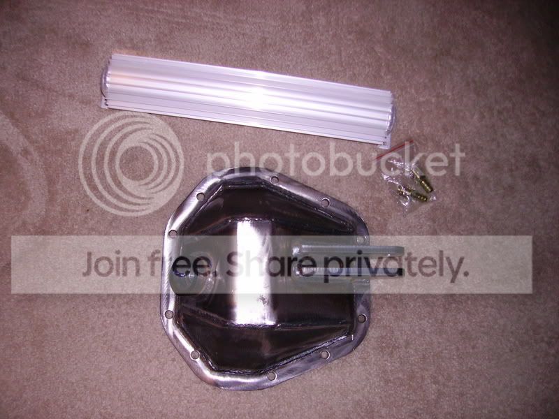

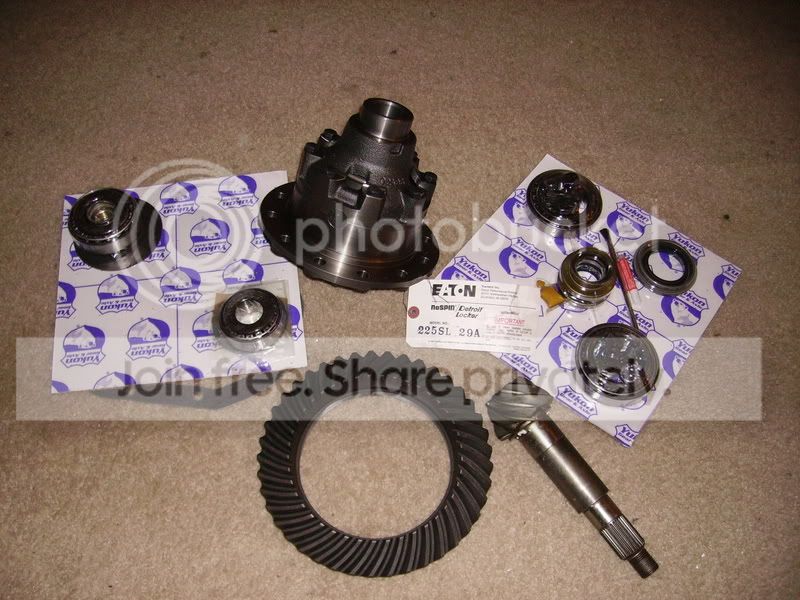

looky at all the pretty parts... hopefully in less than a week they will be all on the seal. only things left to acquire are a few various hoses that i cant measure for until i have the system mocked up

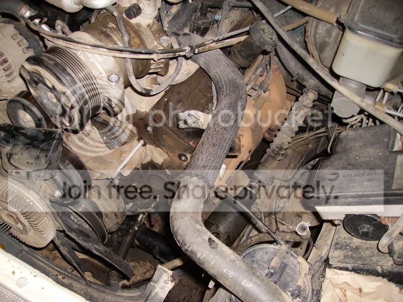

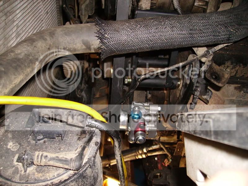

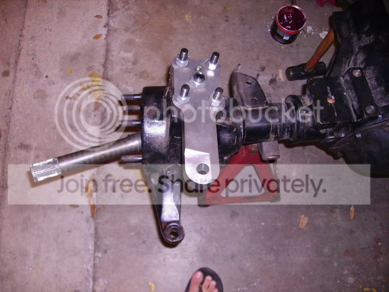

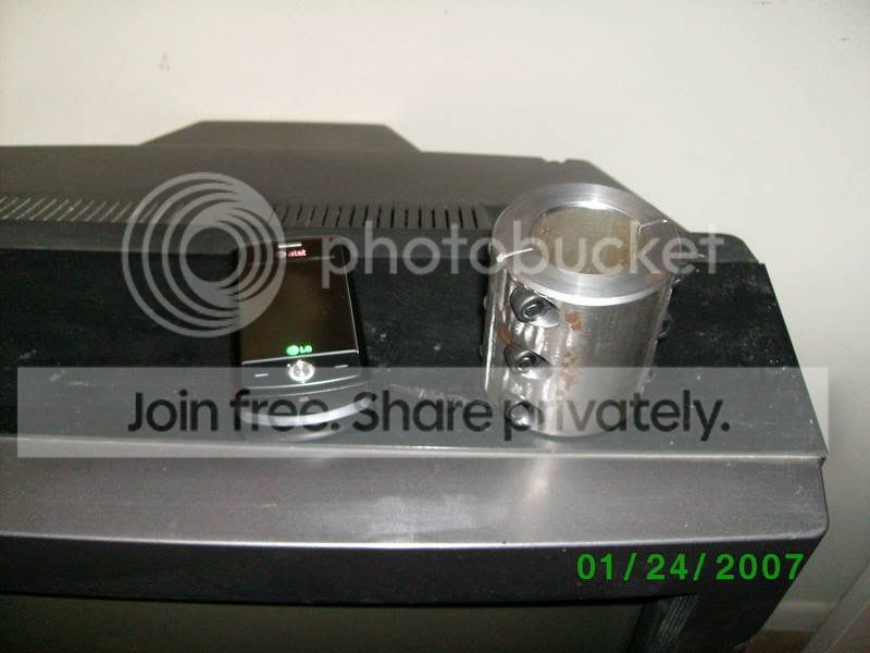

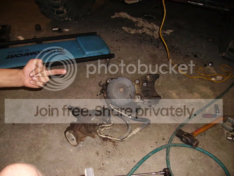

in pics: Crowley fab KRC power steering pump/ A/C bracket to fit vortec 350, tapped 97 k1500 steering box, KRC power steering pump with 3.17 GPM valve, appleton reservoir/filter/cooler, 15" finned aluminum cooler, 1.75"/.75"/8" PSC ram, 6' PSC hose kit, DIY4X flatback d60 cover with ram tabs and a 1.5" MAD4WD tierod clamp
thanks much kyle for taking essentially all the fabbing and thinking out of this one :rockit:

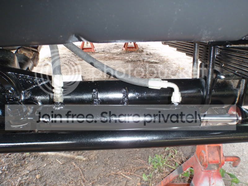

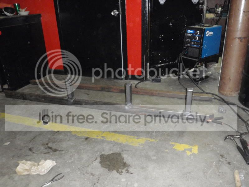

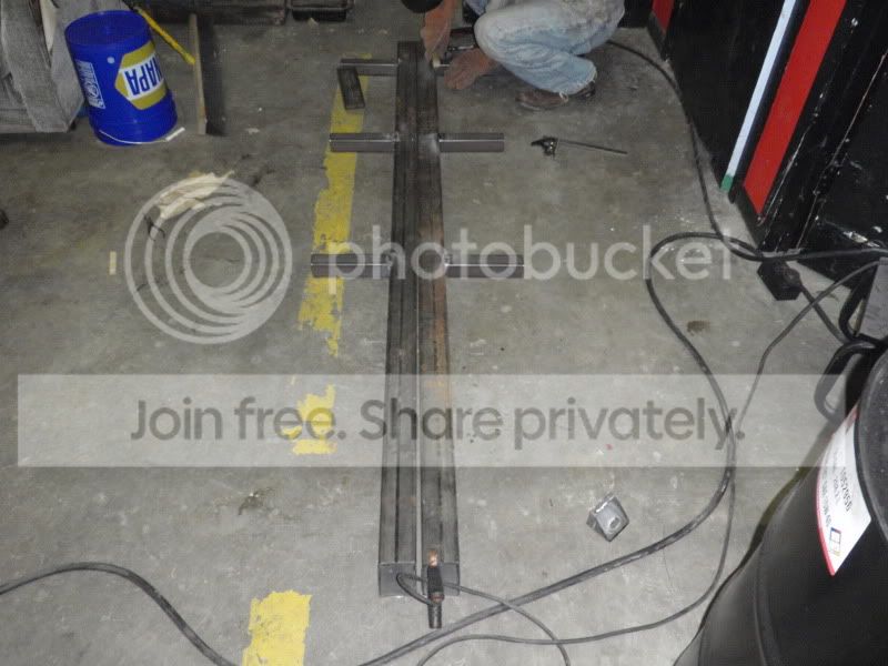

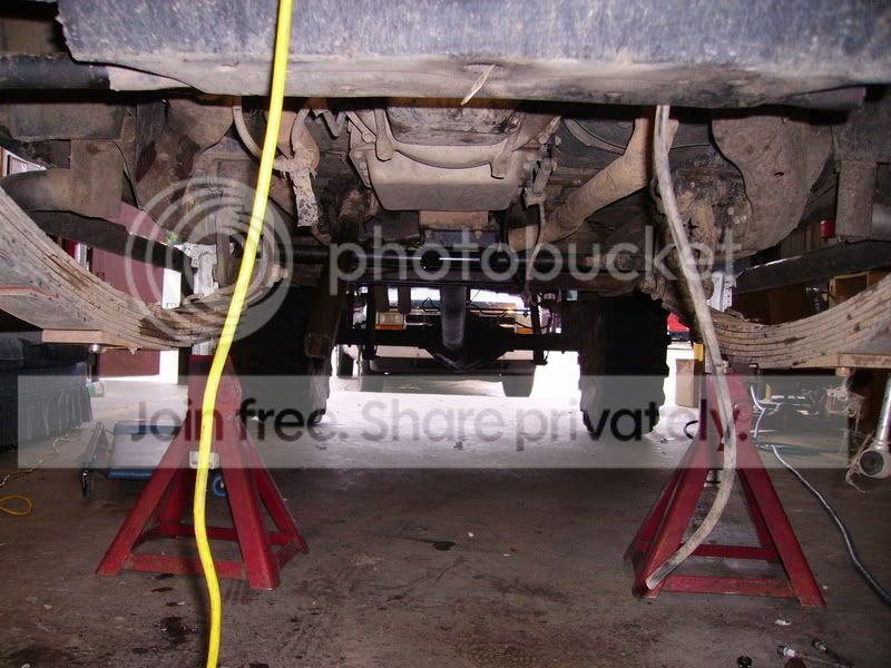

ok my brother is a horrible photographer but here is the days progress...
observing the 3:1 watching/working law
first trial = fail
second trial = success

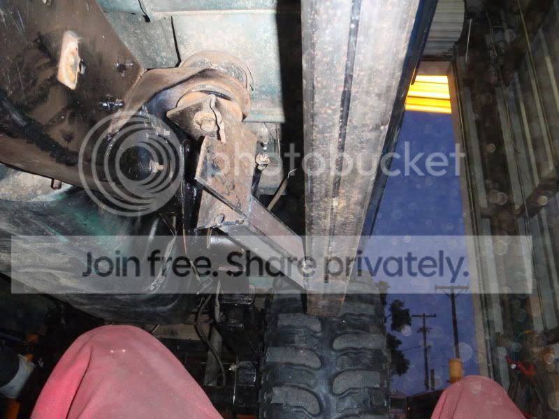

ram mounted

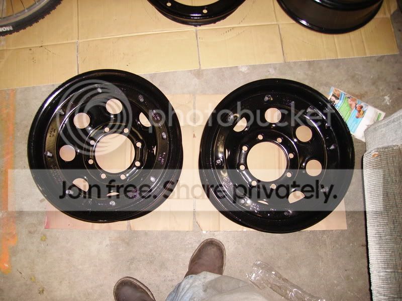

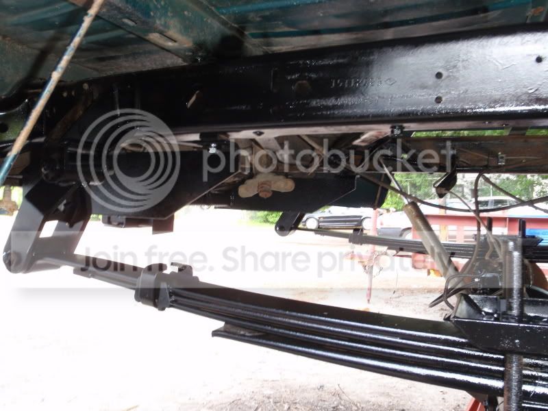

H1s finally painted

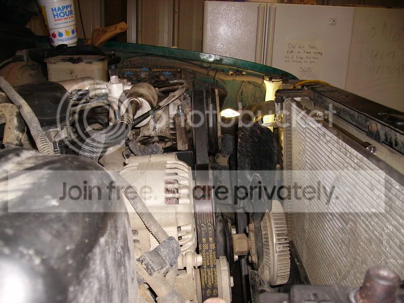

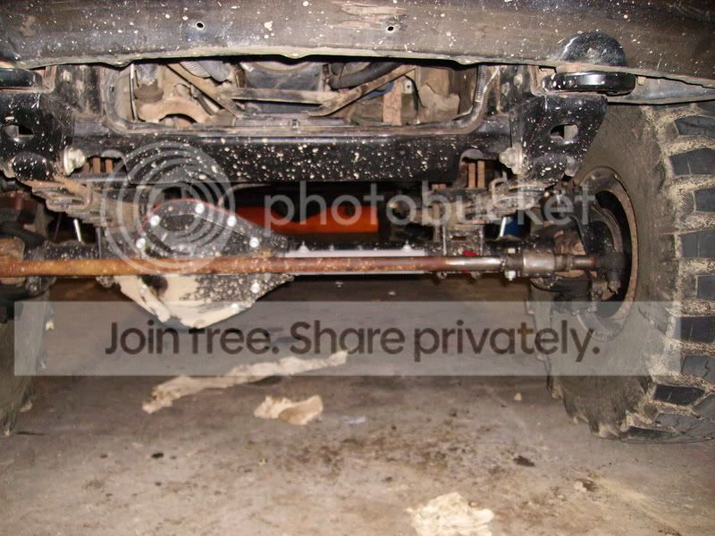

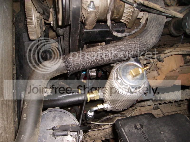

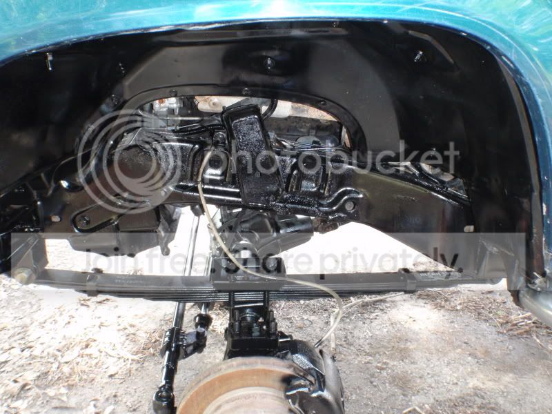

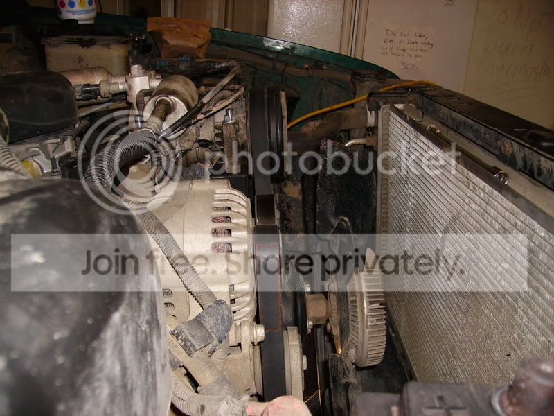

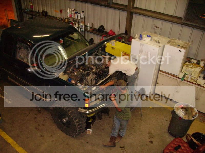

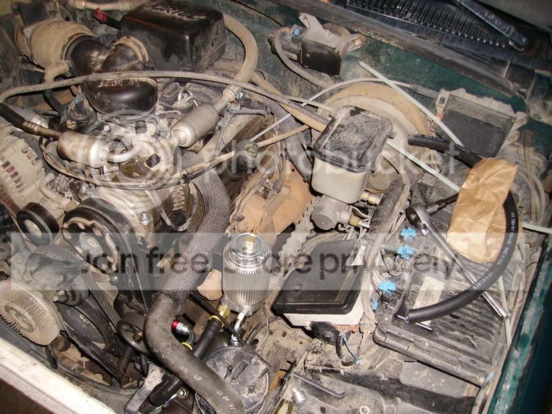

today started out slow but picked up pleasantly just at the end... a missing male/male fitting on the steering box and some closed mindedness on where to mount the ressy drug spirits down. but once marcus came up with good idea to make a bracket to mount it to the engine hoist bracket things picked up and we got all but one hose made and it shouldnt take more than 10 mins to do once I get the adapter in the steering box

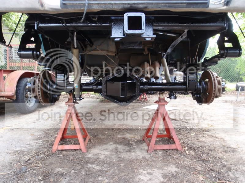

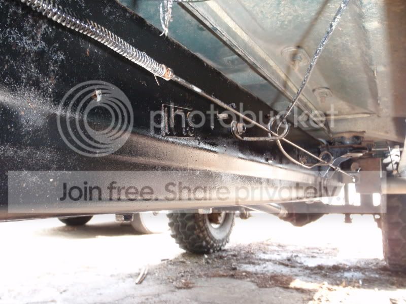

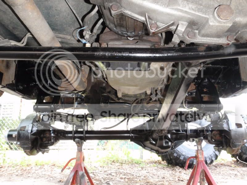

went on a ADD fueled cleaning binge yesterday and today... i hadnt started let alone cleaned the seal since ferriday back in febuary! COMPLETE undercarriage wash/paint washed the body (still need to wax it, its scratched bad bad) and cleaned 90% of the interior

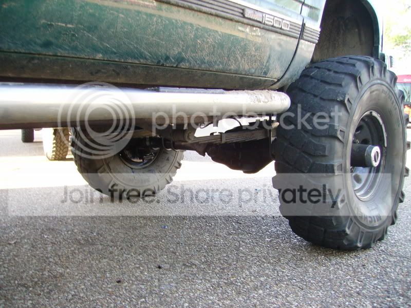

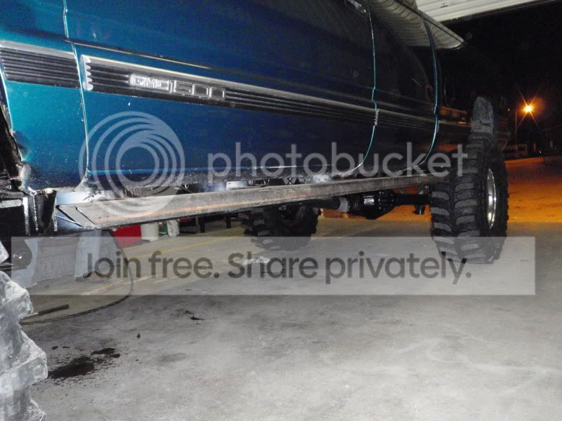

sliderz........
