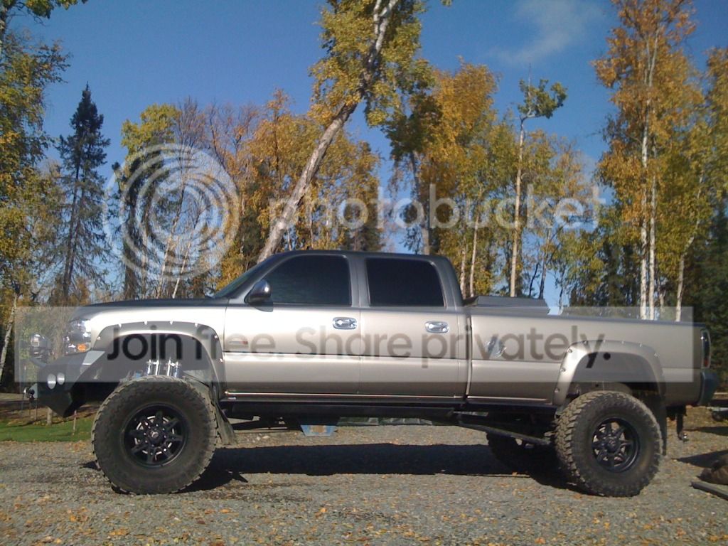

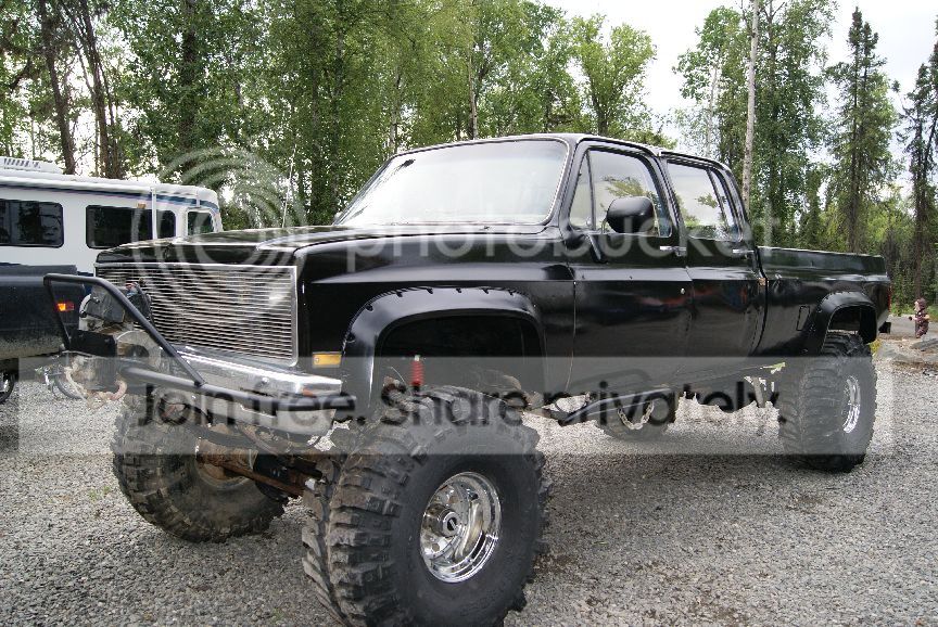

Pretty soon this....
Will have a front end more like this!.....

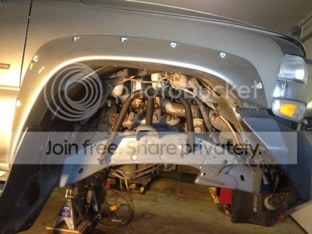

I know you guys are sick of of seeing pics of my fender wells...but can I just say how liberating is it to go from this...
To this...
This this!
Can't wait to get-r-done!!

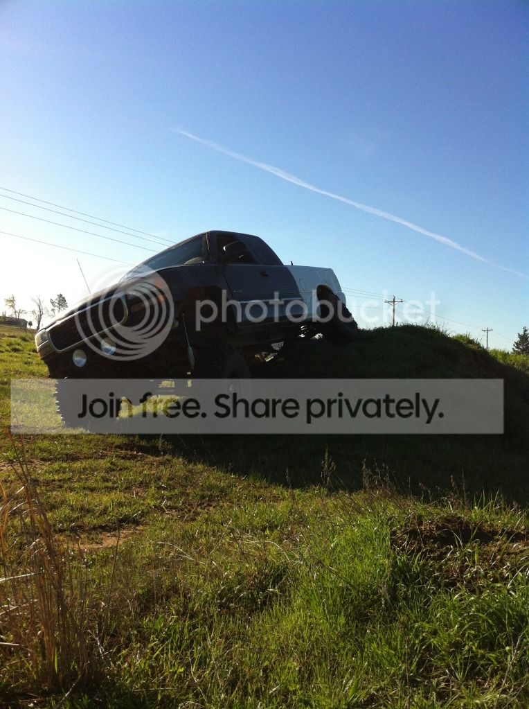

So here's a few quick measurements. If you need anything more specific let me know.
Brake lines are hard to measure. Damn flexible hose. From top mount to around the banjo bolt hole is roughly 29". My axle to frame distance is around 13 1/2", and at all the droop I could manage makes that distance just over 22". I'm not sure how much lift I have, but that's stock 52" springs and a zero rate. I did my own front bracket right off the frame to avoid adding as much lift as possible. With stock lines in the stock location I can usually pull them tight, I went as far up the dirt as I could but I couldnt get them completely straight, but 29" is a pretty good estimate.
I always enjoy a good excuse to go play on my makeshift RTI ramp. Here's a shameless picture of my beater I took while measuring.
AWESOME! Thanks Cruz!....this is exactly why I love these forums! I'll get some longer ones to be safe!
Nice flex BTW!

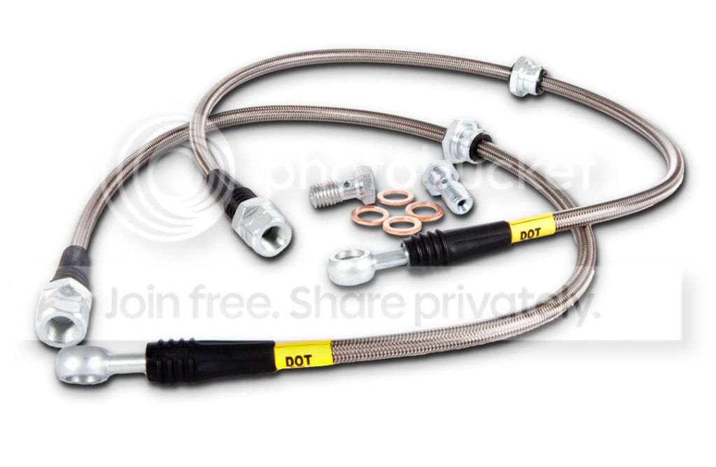

OK, nothing is easy. I'm just trying to order the brake lines for my Dmax, but Offroad Design is unsure of the ones I need. I assumed that if they had a metric 10mm bango bolt at the caliper, that they would also have some metric thread for the hard line connection at the frame....BUT, Chris says they may be 3/16IF and 1/4"IF like the old ones. So, since I am not near the truck, can someone tell me what connection the brake lines (front and rear) are at the frame and what Bango bolt is really needed for the late model trucks? I've Googled it, but I trust you guys more....people that have recently swapped them out with SS lines like I am trying to do now!
PS. Think I'm going with a 33" ORD line to be safe....remember, 1979 Dana 60 in front and AAM 11.5 in the rear.
Going from memory here, so bear with me. My axles are from an 85 1 ton, so I'm assuming they are metric. I've got the stock lines in front bolted to the 85 caliper. I believe it's a 10mm banjo bolt. I've got the stock rear line off of the truck ran down to the axles stock hard line on the long side, and I've got a parts store short piece or hard line ran into ord stainless lines for a disc brake 14 bolt conversion on the short side.
I recall the new truck axle having a 15mm flange, but the threads were identified to the old stuff with the 3/8 flange.
Sorry if none of this makes sense, it's been a long day, and typing on my phone gets annoying.
