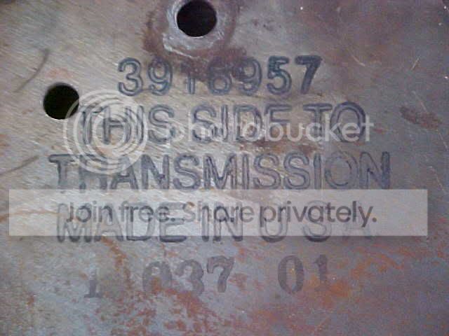

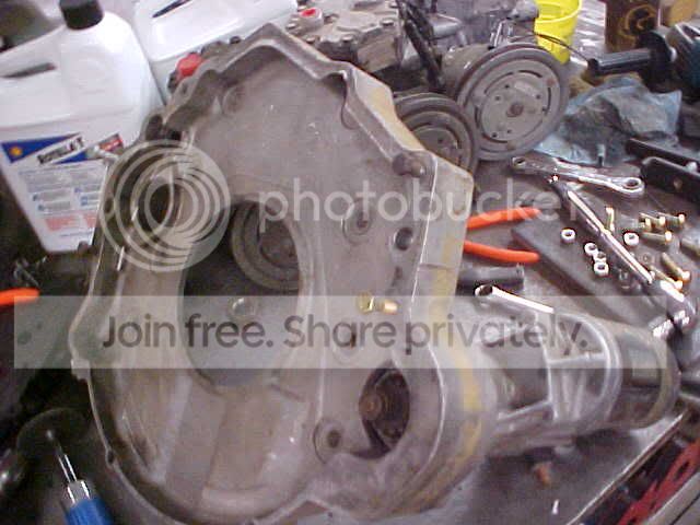

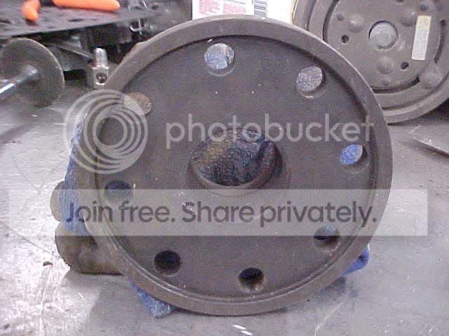

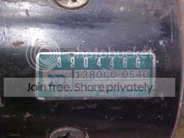

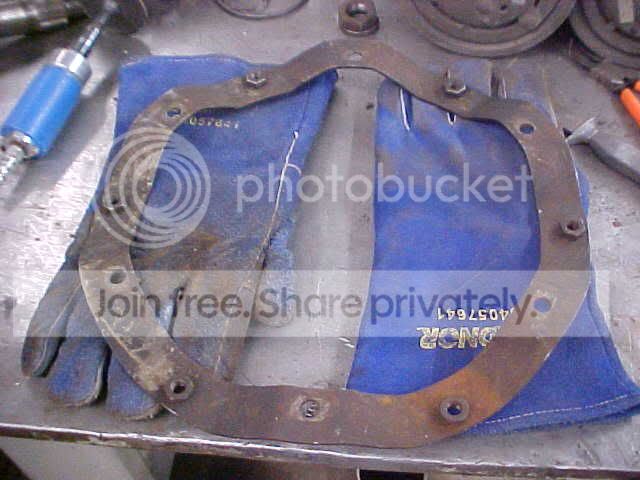

Ok, Here are some pics I said I'd put up and I just took pictures of the part numbers so I wouldn't type them in wrong.........
***Don't blame me if you get the wrong parts****:p:
This is for the 3.9l to th400 auto trans...

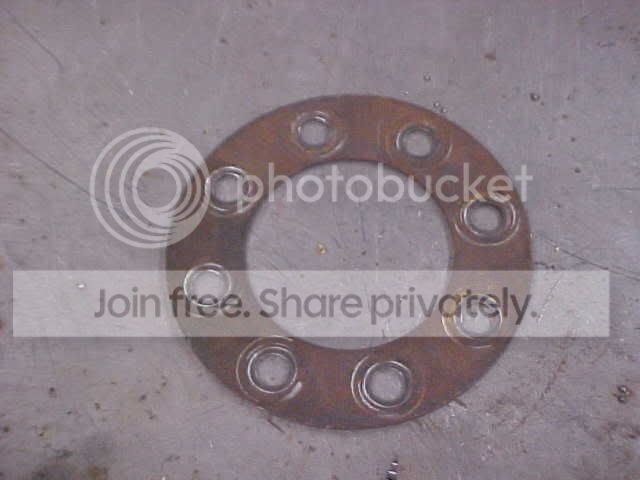

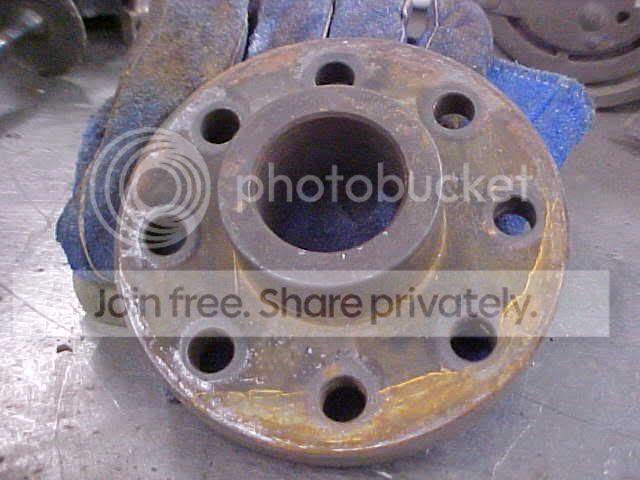

#1 Crank spacer, bolted between the crank and the flywheel....sorry no p.n.

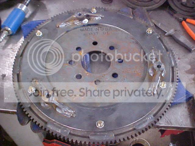

Flywheel pn.
With my adapter (cut by DIY4X) for a th350 torque converter

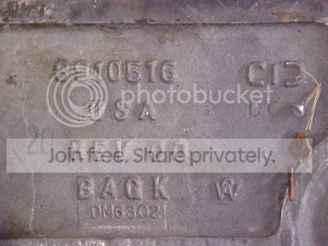

th400 torque converter adapter....sorry no pn. on this either
This is just a thin washer/spacer for the bolts through the flywheel, crank spacer. no pn.
This is the adapter for the chevy th400 (NOT BOP)......
