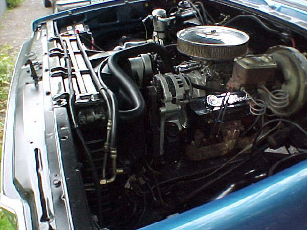

Serpentine is the only way to go if you ask me and there are several different factory GM options to choose from. Here is a thread from a few years ago that I contributed several pictures of the various designs used on small blocks and 4.3L’s over the years (there are about 4 different factory serpenite designs for big blocks too) . Some are better than others. My preference is 1996-2000 L31 5.7L brackets mainly because I like the HT6 A/C compressor vs. the R4 that was used on older versions.
Way back in 1996 I swapped my old 350 over to serpentine. I pirated the brackets off of a wrecked brand new truck at the time. There were no forums back then and nobody that know of had done this swap before so I had no idea if it would work or not. In the end it worked great! I did have to drill one hole in the passenger’s side head though. That was the scary part! I reused my p/s pump too and just swapped on a serpentine pulley. If you go with a serp set up I suggest grabbing the fasteners from the donor as well because you will want studs in the block on the main fasteners then use constant prevailing torque nuts to secure brackets. The nice thing about going to serpentine is the fact you can more easily run a higher amperage alternator. I went from a factory 63 AMP alternator to 105 AMP, what was HUGE back in 1996 :haha:
I’ve been running serpentine on this thing now for 18 years on all of the engines that have been in it (350, 454HO, and 8.1L) and have always carried an extra belt, idlers and tensioner. Not once have I needed to replace any of those pieces on the trail but I did have to replace a water pump on my old 454HO on top of Mount Antero which the serpentine brackets sure made for a quick an easy WP swap.

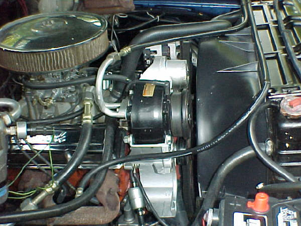

My old serpentine converted 350 with 1995 C/K 4.3/5.0/5.7L brackets. I ran this little contraption from 1996 to 2003 when it got a 454HO, which I ran that engine on L29 7.4L serpentine brackets.
These brackets used the R4 a/c compressor which is a turd....all 4 of them! :haha:
These are the best small block brackets in my opinion. 1996-2000 5.0/5.7L. Same brackets used on 4.3L all the way to present day on GM Express and Savanna vans.
