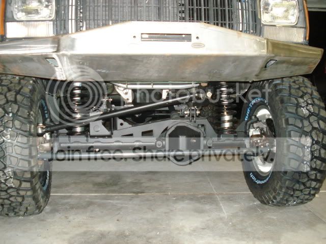

trac bar/panhard bar
Hey you two! Quit trying to confuse things! Bot of you need to add a "k" to your "trac" :doah:
