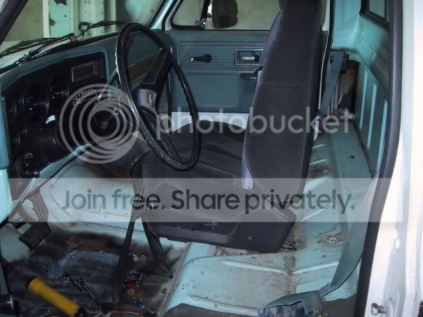

2000 chevy 1500 seats, I built mounts for them, they have the seatbelts mounted in the seats already, but some guys mount them straight to the floor.

You pretty much have to cut off the whole mounting system leaving just the rails. I put mine to a tube on my floor but it would not be too hard to make a bracket to bolt them to the stock holes in the floor.

yeah yeah a pic is worth a million words blah blah, full disclosure I stole this from someone else on here. The bolts going through the seats are 4" long and go through the floor and through a piece of 3/16" steel that is 36" running front to back. The seat set also had a middle seat that might have bolted in over the transmission tube, which would have made the seat continue the entire width, but I didn't use it as it was only a small seat not a center console it did have some cup holders though.
For anyone making mounts for their seats, DONT use old bed frame! It is hardened steel and sucks to drill through. I dont know why I used that for my seat frame and center console....

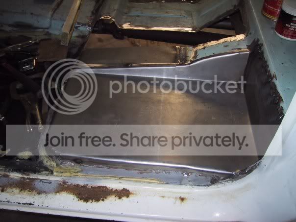

not easy to use the bucket/bench seats in a truck, the floor has a hump in a single cab, not flat like the K5's. Your goinna have to mod the floor.
http://www.gmsquarebody.com/forum/showthread.php?t=375
You can usually mod the seat to make it work, most likely why Chris asked. See what others had done to get a good idea of what seats you can use. My seats I cut all the mounting tabs off and made my own did not need to level the floor like the above pic
In a Blazer or Jimmy the floor is flat, trucks they are not. I just wanted to give him a heads up because all the replies were about seat swaps in blazers, none about trucks which is what he asked.
