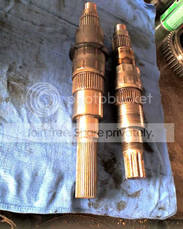

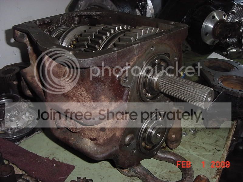

is there a picture of one of these shafts anywhere? installed in the 465 would be ideal! thanks
Here you go -
I have a pic of the 10 & 32 spline shafts next to each other, I'll find it and post it tomorrow.
Very much appreciated. Maybe this is why ORD doesn't post on this board anymore; they don't have to, their customers do it for them!
