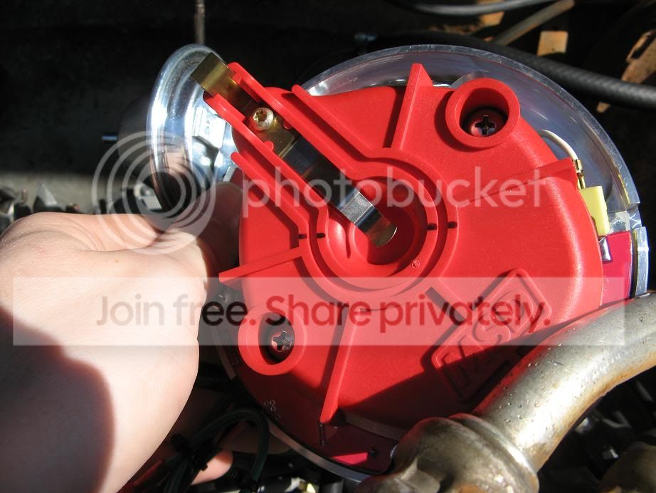

I can’t seem to get the dizzy all the way down. It’s getting through the gear, but I think it’s hung up on the oil pump rod. I have the dizzy and priming tool marked to show the rods orientation. You can see the lines. I keep trying to rotate it different ways but no mater what it wont go down. The dizzy body turns fine, the rotor is tight on the gear, and nothing is in the way. I don’t get it. Can anyone help guide me? I’m nervous and frustrated if it’s not obvious already ahahahaha
Ok, you have to remember that because the gear is a helix as you drop the distributor the rotor will turn so therefor you can't point the distributor exactly where you want the rotor since it's going to move. Now, you are correct that the dizzy gear is starting to mesh with the dizzy gear on the cam. If you have a remote starter button you can hold the dizzy and bump the remote starter button and the dizzy will drop all the way down when the dizzy shaft is lined up with the oil pump shaft. If when you're done the rotor doesn't point where you need it to just repeat the process but make sure to move the rotor appropiately in the direction needed for it to drop where needed.
I have my own method of dropping them without bumping the engine over but it's too hard to explain on here.
hmmm remote starter
I might ("might") be able to substitute that with a younger brother right?
The rotor turns as it goes down. I start it slightly retarded and it rotates advanced as the shaft goes in. I'm only 1/4 -3/8" away from the intake.
The only reason it won't drop all the way is it isn't meshing with the oil pump slot. Remember the shaft turns as you drop is as the cam gear it's meshing with is helical. You just need to try turning the oil pump shaft with a screwdriver a little, and then try to stab the dist again. No need to get flustered, there is nothing wrong with having to make several attempts.

O.K., step back, take a deep breath and r-e-l-a-x!!!!
1) does the dizzy have an adjustable collar? If yes, try raising the dizzy (lowering the collar) a bit to seat it properly.
2)timing at idle, o.k.
3) before dropping the dizzy in, turn rotor to #1 post on the cap. HoW, you ask? Install cap, mark on dizzy body with a sharpie or something similar where that post is.
ensure the piston is near TDC on COMPRESSION stroke (both valves closed)
this should get you in the ball park.
Rene
this^^^
the oil pump isn't lining up. i went through the same thing, and got just as frustrated, then, had a beer and a smoke, and started looking at things a little more carefully.
do the whole screwdriver to turn the oil pump thing. it may take many tries, but it will work eventually!!

I thought marking the dizzy body where #1 is was a good idea, so it's already done.
Motor is on tdc, both valves are closed and balancer is lined up @ 0
No adjustable collar.
I marked the dizzy cap and my priming tool. I did this just so I didn't have to guess where the oil rod was. I KNOW where it is. But I guess I'm just missing something, its all good. I'm not getting frustrated so much with this, just people. They know how little I know.

I'm telling you, once you have the dizzy where you think it will drop correctly just bump the starter and it will drop down then just bring it to TDC again (compression stroke) and make sure that it is infact where you need it.

Just bar the engine to get the oil pump drive slot lined up if you don't have a remote starter.
