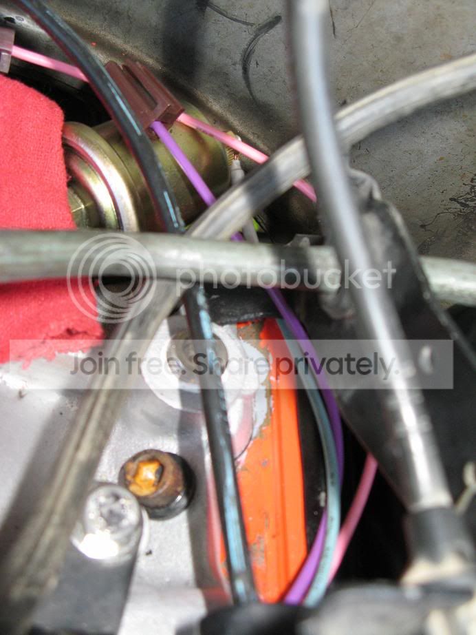

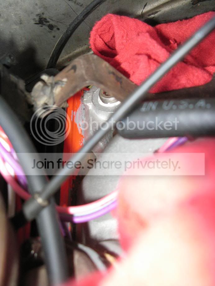

I finally had my cousin come down Monday (after saying he would 5 other times) and we tried. The oil pump rod is clear, cause I can get the primer on it. Both the priming tool and dizzy sit to one side of the hole. (passenger side and back). We bumped it ~15 times, ran it for a few seconds, we tried tapping on the outer edge to get it to drop, we tried a lot of things. :dunno:
With the distributor in and gasket in place, the gasket does not cover the entire hole.
