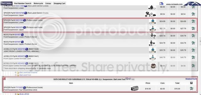

So I looked up the parts on rockauto...
So it looks like it'll be about $100 for all four.
So the upper ones use an adjuster... so I'm assuming I need to order that little tool at the same time.
I wouldn't order the tool, just take it to a competent alignment shop and they will make sure they are adjusted and setup correctly.
do your self a favor and get the moogs or a similar quality, do not go with the cheapys!

I don't plan on keeping this front end for too much longer so I don't think I need to go all out. Is it a fit/finish difference or just how long they last?

Ok so where is the best place to get moog ball joints?
I did a quick search and found some here...
http://www.autopartswarehouse.com/search/?D=ball+joint&Ntt=ball+joint&Dx=mode+matchallpartial&Ntk=Main&Ntx=mode+matchallpartial&N=1588+4294965773+9929&Nty=1&V=1588+4294965773&Vh=1978%20Chevrolet
So it'd be about $200 for all four if I go that route...
EDIT: Looks like Summit has them and they're quite a bit cheaper through them too...
http://store.summitracing.com/egnse...925060+4294907043+115+4294908181&autoview=sku
