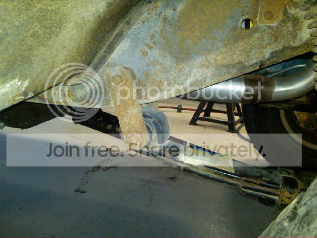

then i pulled the blazer in, i knew i had to level it out before i tried the jump wire on the distributor. because i know me and if it runs i want to drive it and it was kinda scary steering it with the front end so much higher and the steering out of adjustment.

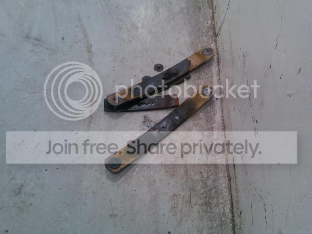

heres what i pulled out of the front
and the shackle angle still sucks, but it is better
still sits about half an inch higher in the front than the rar but im fine with that because i am going to build a better front bumper and add my winch.

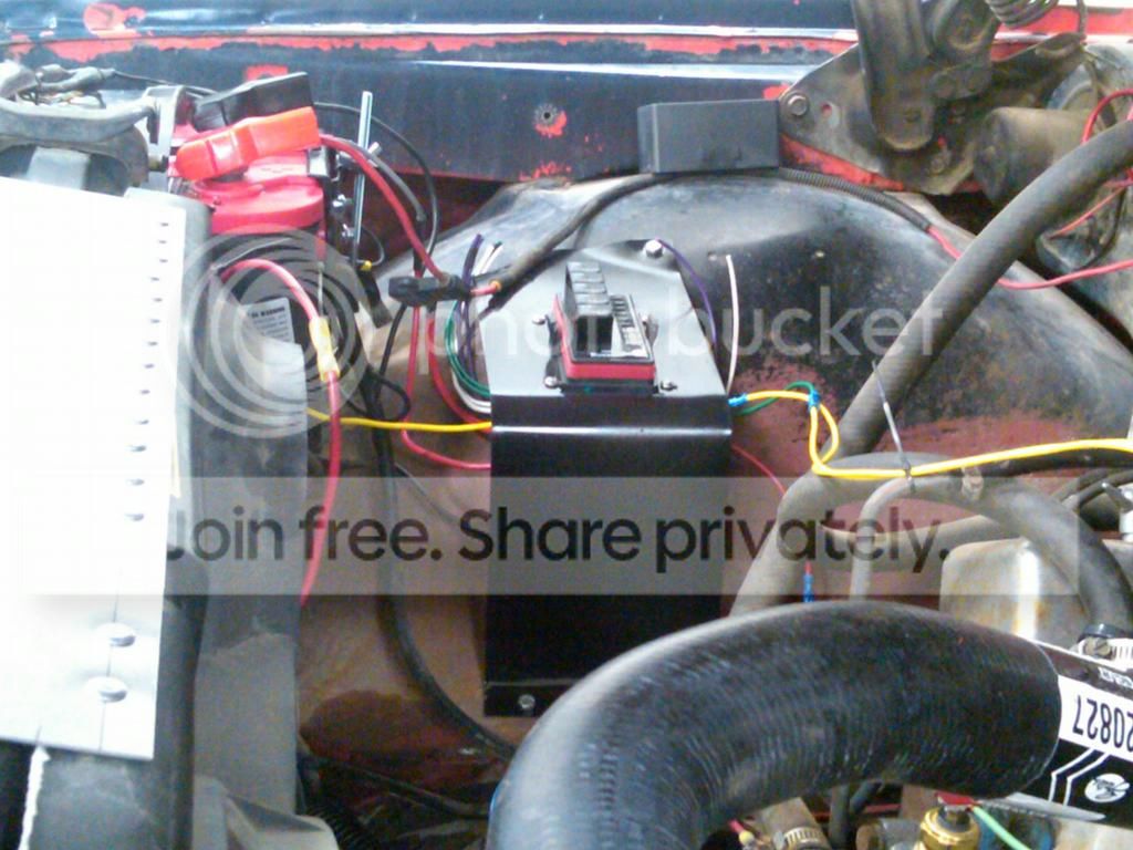

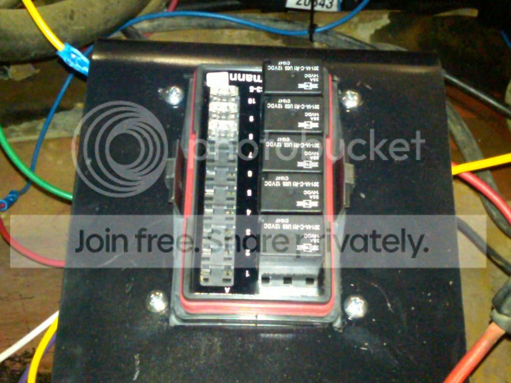

put an order into to PMA4x4 for a sealed relay box, summit racing for a thermal switch for the tranny cooler fan and another thermal switch for the windstar fans, a steel truck box for the rear so i have lockable storage with the top off. found a seat bracket i need from a jlmerie on 67-72trucks.
my order from classic parts will be here today with my mirrors and new ignition switch

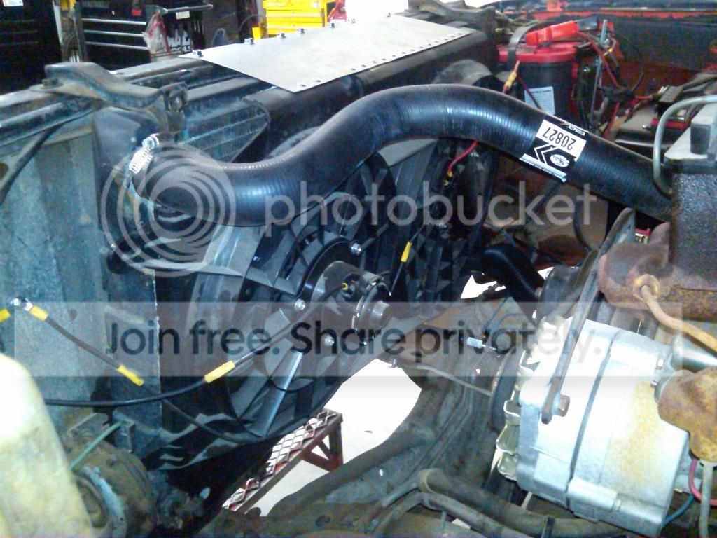

Saturday i was called into work so i figured id start working a day early to swap my radiator and electric fans in. my aluminum radiator from my 91 burb wouldnt fit so i put the old radiator back in for now till i can buy one that fits. i got my trans cooler with built in fan installed, the windstar fans installed, new water pump since when i took the flex fan off i could tell the shaft was moving, relay box installed, thermo temp sender for the fans, and a new temp sender for the gauge (then found out my gauge doesnt work).

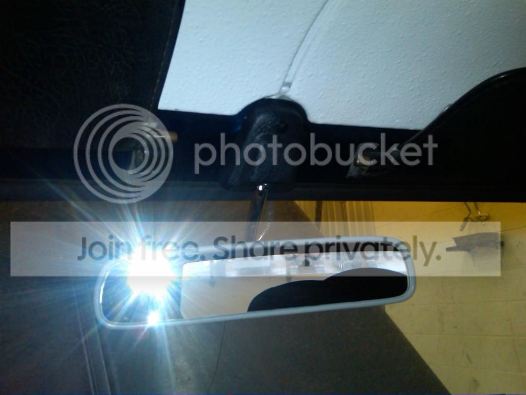

yesterday after work i put an aftermarket electric temp gauge in and installed a rear view mirror, i hate trying to re-install a rear view mirror that has fallen off the glass because they never stay so i ordered one for a 67-70 that screws to the windshield frame.

...installed a rear view mirror, i hate trying to re-install a rear view mirror that has fallen off the glass because they never stay so i ordered one for a 67-70 that screws to the windshield frame.

I glued my "correct" 1972 mirror on to the windshield twice.... and it fell off, TWICE.
After that it "fell" into the garbage pail and was replaced with one from a '69K5. It hasn't fallen off since.
-G
I'd prefer a screw on rear view mirror too,but my '82 GMC has too much rot in the windshield area to hold sheet metal screws...:doah:..my glue on mirror is about due to be found lying on the floor,happens most every summer the first 90+ degree day we have when I park it in the sun...hate gluing those dam things on,I always f*** up and put the tab on upside down or facing the wrong way 8 times out of 10!..:doah:
my old 70 chevy i had in high school had it screwed to the windshield frame so when i seen this one use to have one on the windshield, i knew what i was doing. cheapest one i found new was in LMC for $50 shipped, that was the whole kit.
