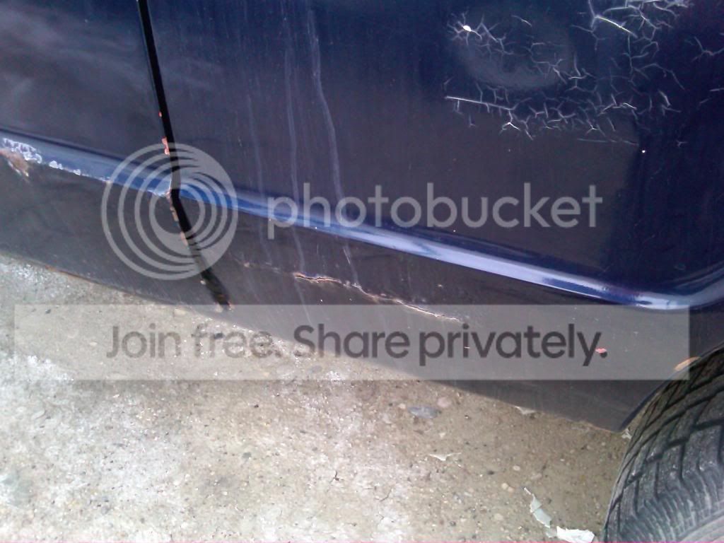

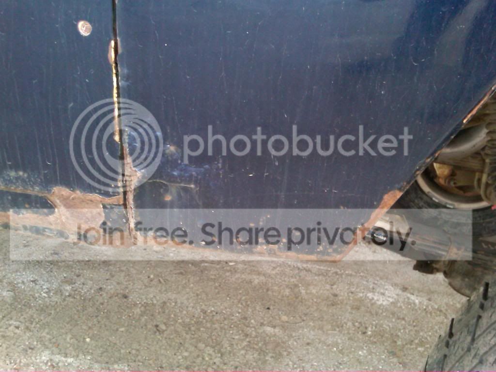

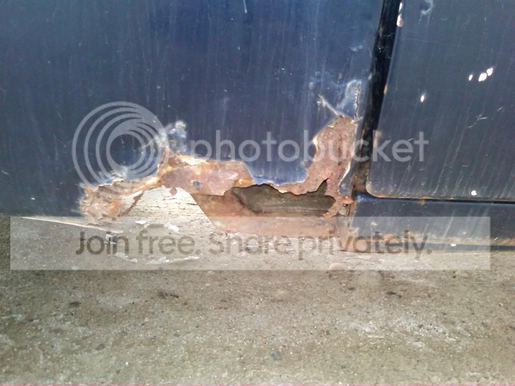

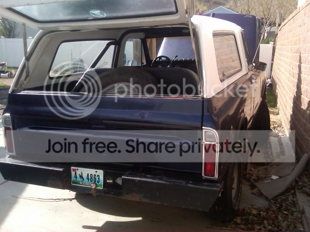

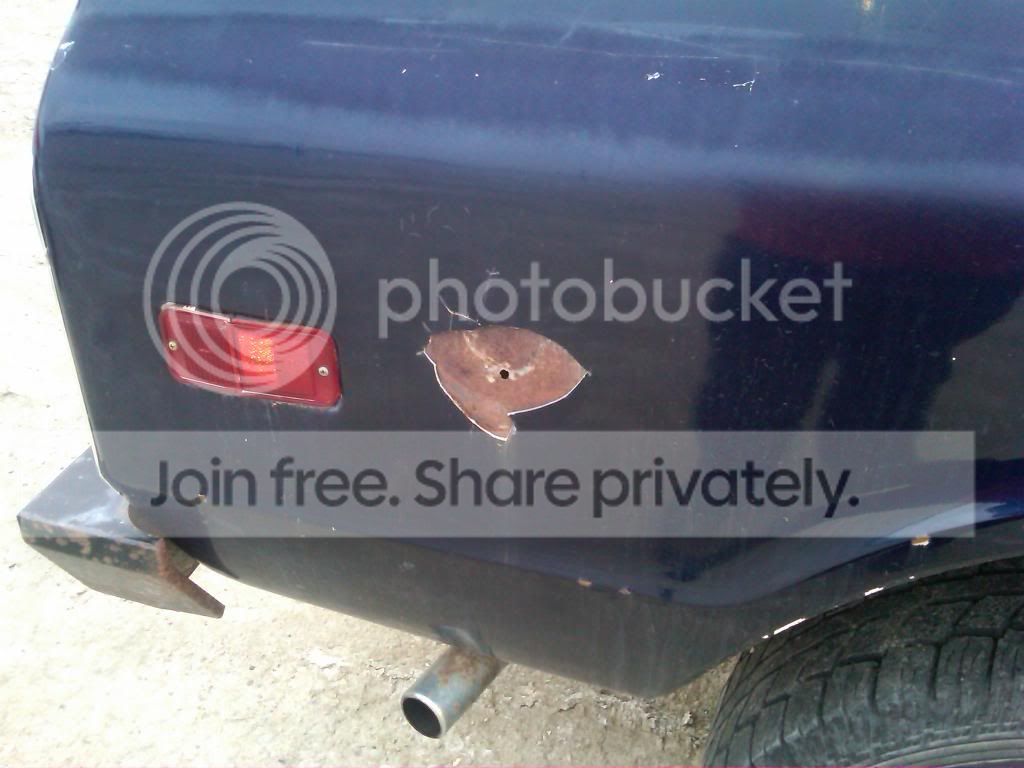

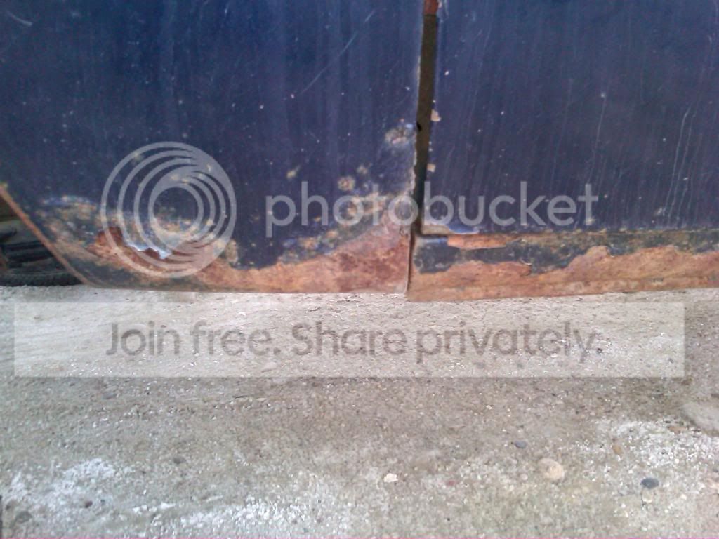

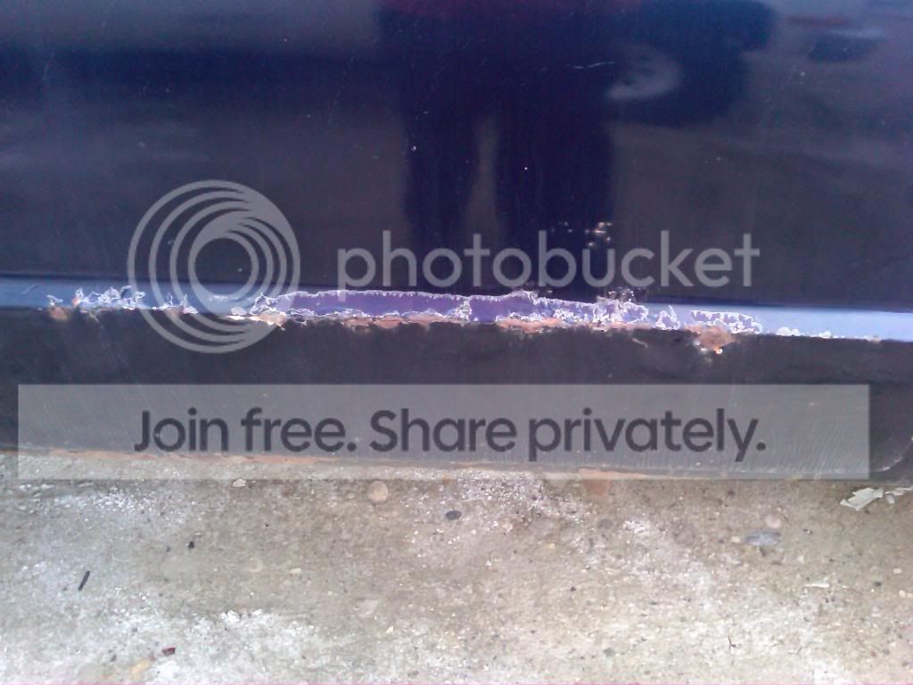

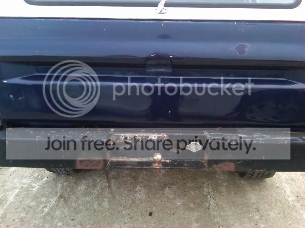

Got it home lastnight, when it was at his house i couldnt really see the passenger side because of the retaining wall, well there is a little rust on the passenger behind the door. Still not bad for how much i paid though.
Here are the pictures of the rusty spots
rear bumper, im going to build me a new one so if anyone is interested in this one, its repairable
the worst spot
paint bubbling up

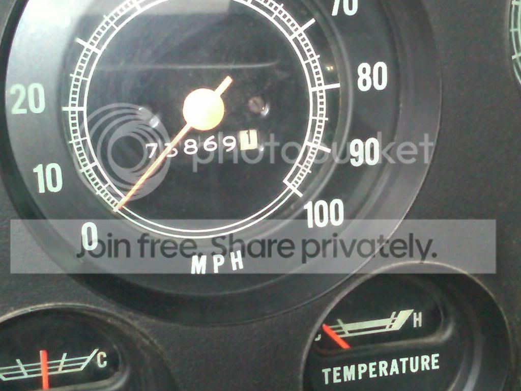

and the PO confirmed this is original mileage.

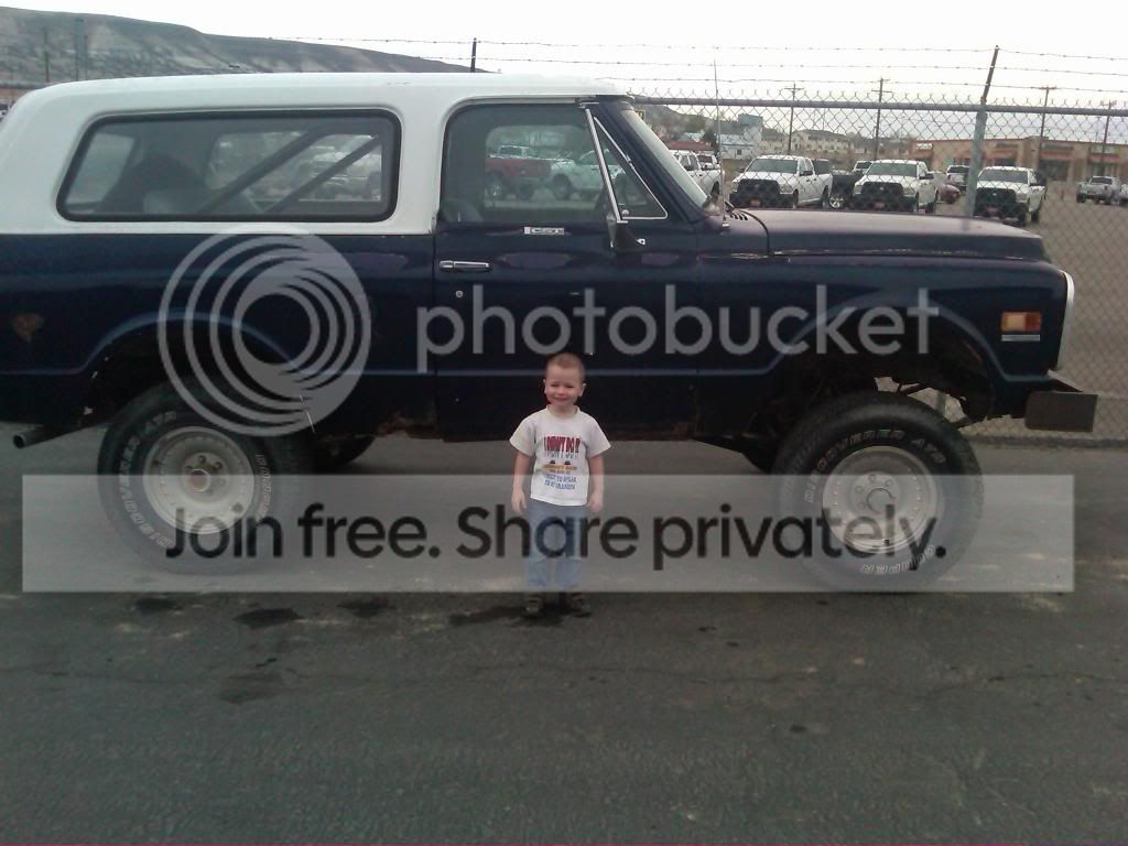

ya the wife brought him to work lastnight when i was tinkering with the blazer he runs into the shop "DADDY", then he sees the tuck and makes a 90 degree turn "MY TRUCK"

Cool picture of the little guy....and kudos to you for getting him interested at an early age.
