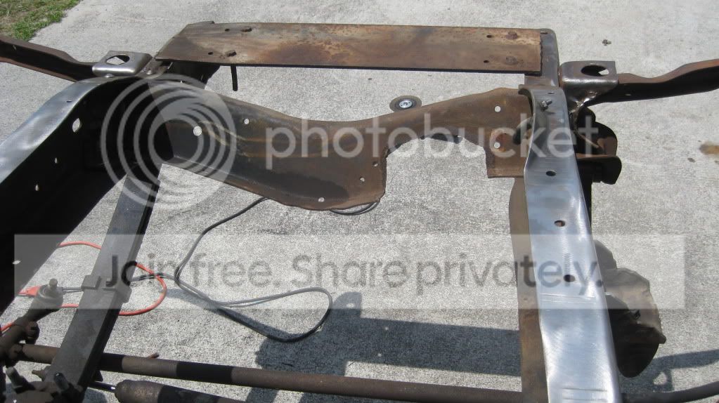

Here is anouther pic of the ghetto/booty Fab job the PO did with his winchplate and PTO cutout on my crossmember...

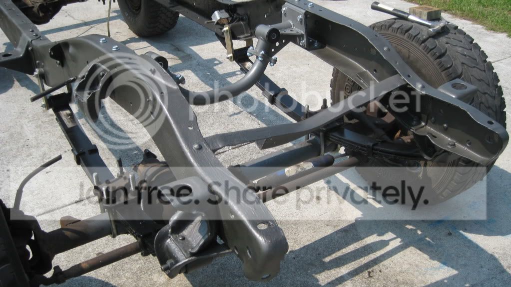

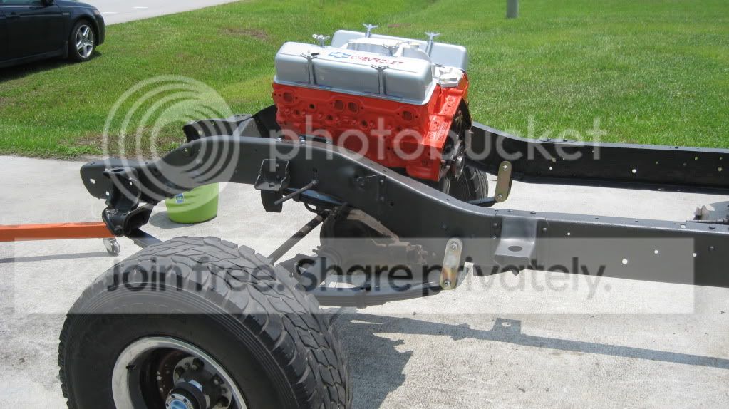

After hours upon hours of wire wheelin I finaly Got the frame coated in the rustbullet finaly...tommorow i will top coat it with rustbullet blackshell.

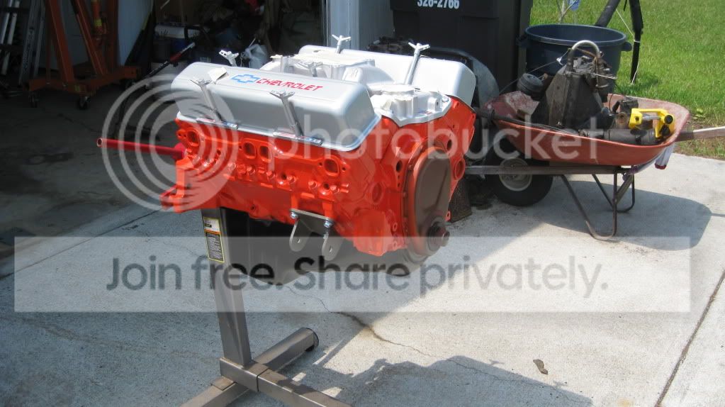

And then mount the motor in there with this beauty i got in the mail today...

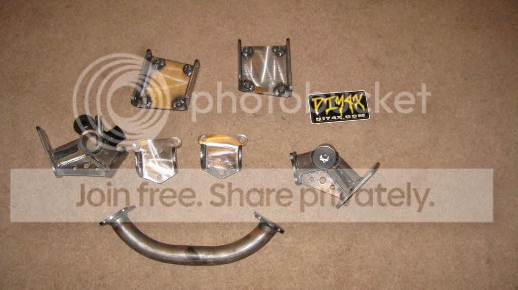

Still waiting on the U-bolt reversal stuff for the 14bolt from DIY and also the front u-bolts from ORD.

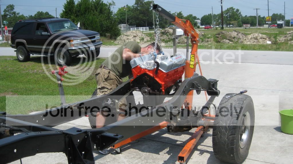

Well i woke up today ready to get things going, i wanted to get the frame topcoated in the morning so i could instal the corssmember and engine in the evening BUT.....
A rainstorm has decided that was not a good idea.
Looking good. The wife must be pretty impressed now that it lost it's earth tones. :grin: How'd the Rust Bullet application go? How many coats and how much did you use on the frame?
The rust bullet application went ok...You gotta stir it ALOT, The stuff gets really thick if you leave it out. I would pour some into a tray and brush it on but it would start to get real thick quick.

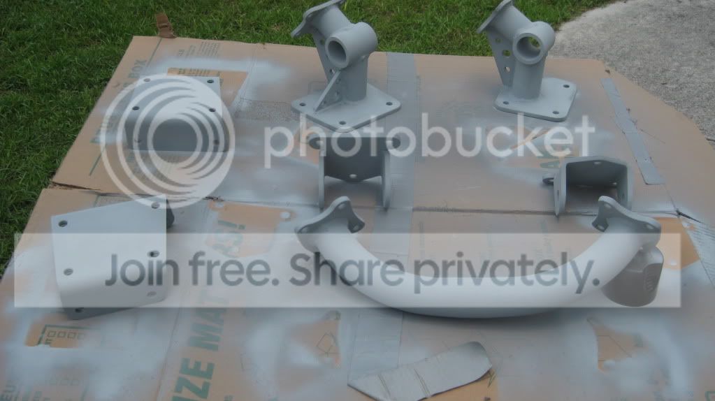

So i may be copying a certain ramjet 502 owning somebody on this board in my choice of frame color...I decided for asthetic reasons to paint a coat of that cast iron duplicolor engine enamel over the black shell, and its looking pretty sweet so far. I may also have completely copied him by painting the crossmember the same color and clearcoating it too.
Pics tommorow when its all done. I just couldnt help myself...it looked soooo nice in his thread.

So i get the crossmember in and engine bolted up and head out to the place where my transmision was being rebuilt to pick up my rebuilt 350 and 205 with new seals and he isnt there, he wont be back until monday. I was going to do the whole deal at once so i wouldnt have to leave the engine sitting there on the mounts alone but looks like it is going to stay there until monday.
