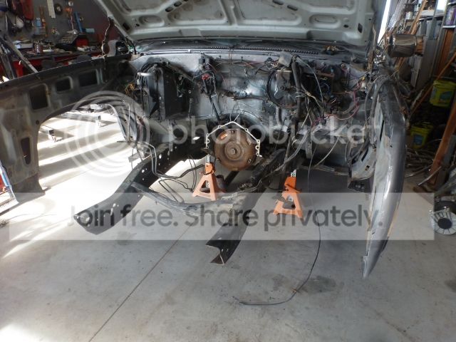

After two hours in the shop this is what I have, don't know if its that easy or I have striped to many of these trucks.

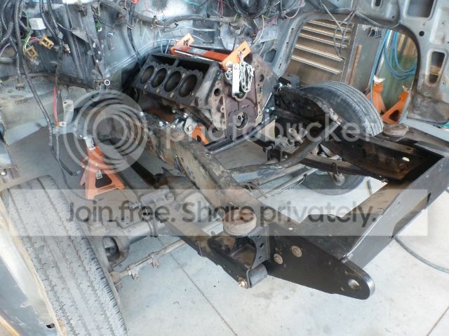

After dropping the Abomb in place I set a bare block in place.

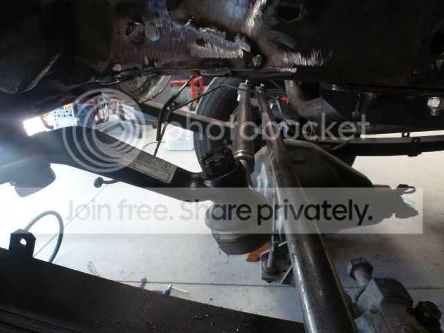

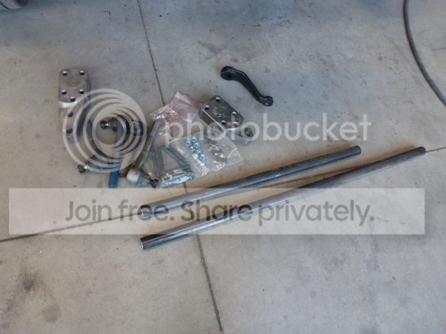

Started working on the cross over steering from Kurt at DIY4X.

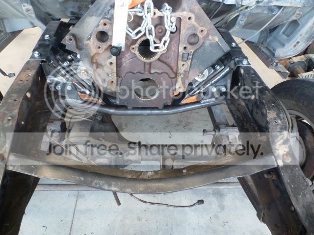

Installed the ORD engine cradle.
Did a little fab work to get the 2wd and 4wd motor mounts connected.

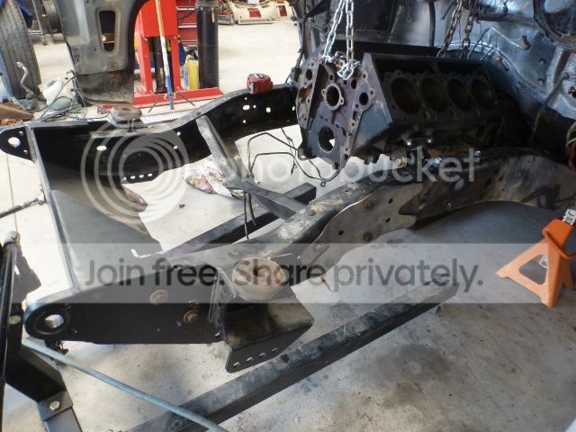

Rolled the Dana 60 into place along with 52" springs packs.

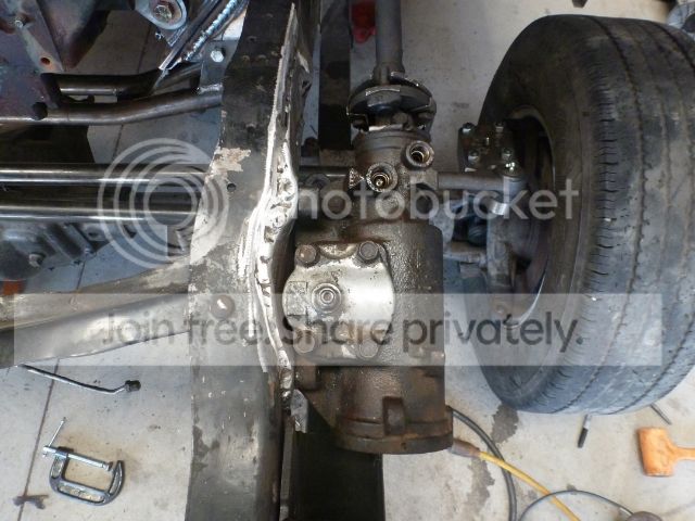

After one of my many phone calls to Kurt at DIY4x I decided to move the steering box forward one inch by placing my ORD backing plate forward and drilling the new holes.
Stacked washers between the backing plate and the steering box and welded it all up and ran a drill back through the holes.
Steering lines up much better now.

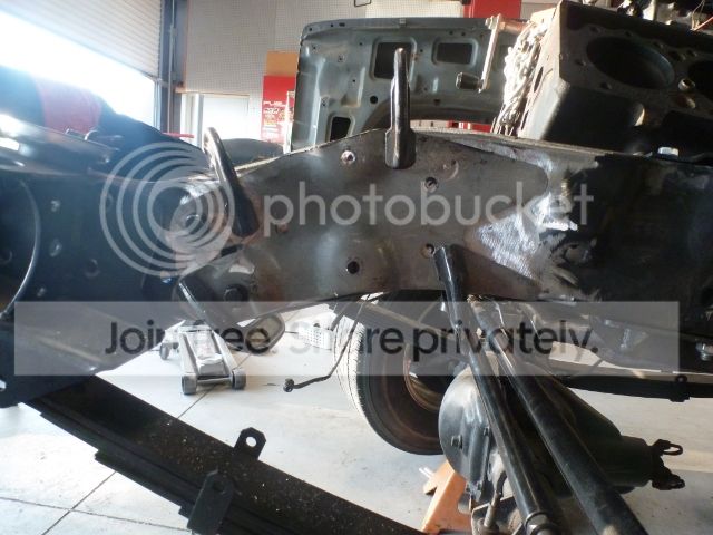

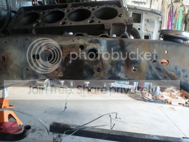

Reinstalled the radiator support, lined up the mounts and drilled all 16 bolt holes for the A bomb, one drawback that I have found with the 2wd frame.
I have the two inch holes drilled for the bushings and need to pull the tranny to drill out the 8 bolt holes.

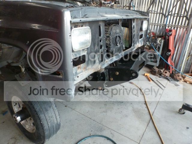

The front end is done for now.
Removed the running boards while I was at it, not only looks better but much safer for me.

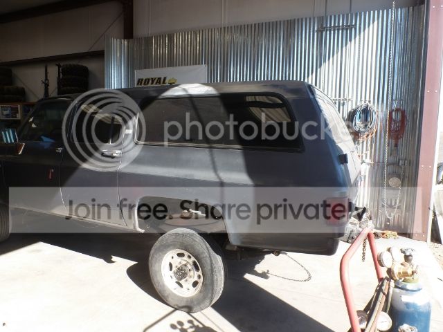

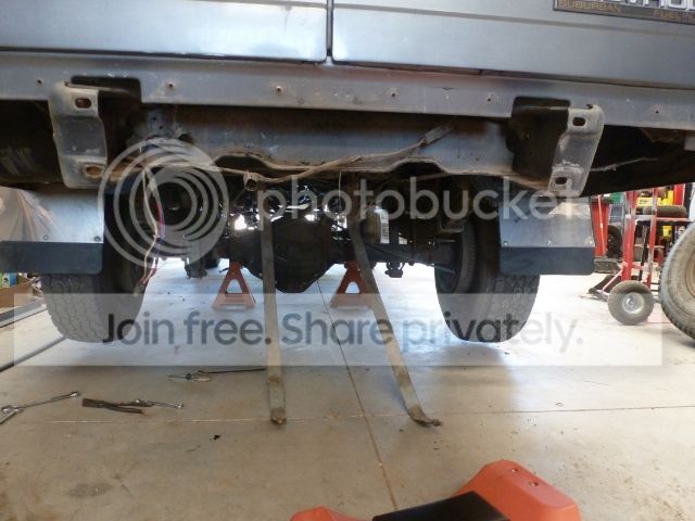

Having a removable bed when having to remove riveted spring mounts would be priceless right now.

The old brackets are out and the new ones are in along with the FF14 bolt with locker/

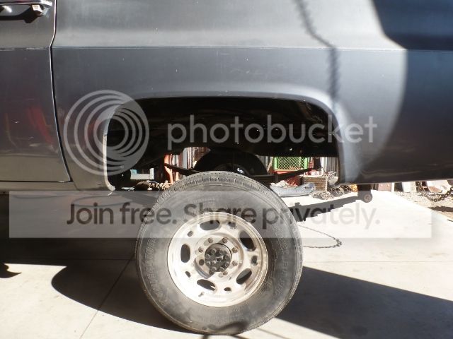

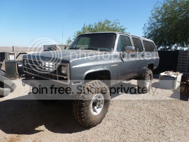

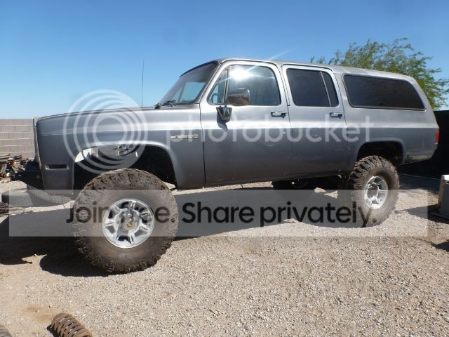

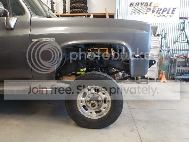

Looks much better now with the lift, it now sits 8" higher than a stock 2wd.
guess i'll have to watch this one too:D

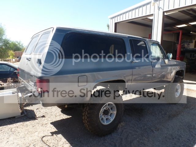

Couldn't help myself from slipping on my 40s to see how it looks with real rubber on it.
Now then what could I do about the departure angle.
