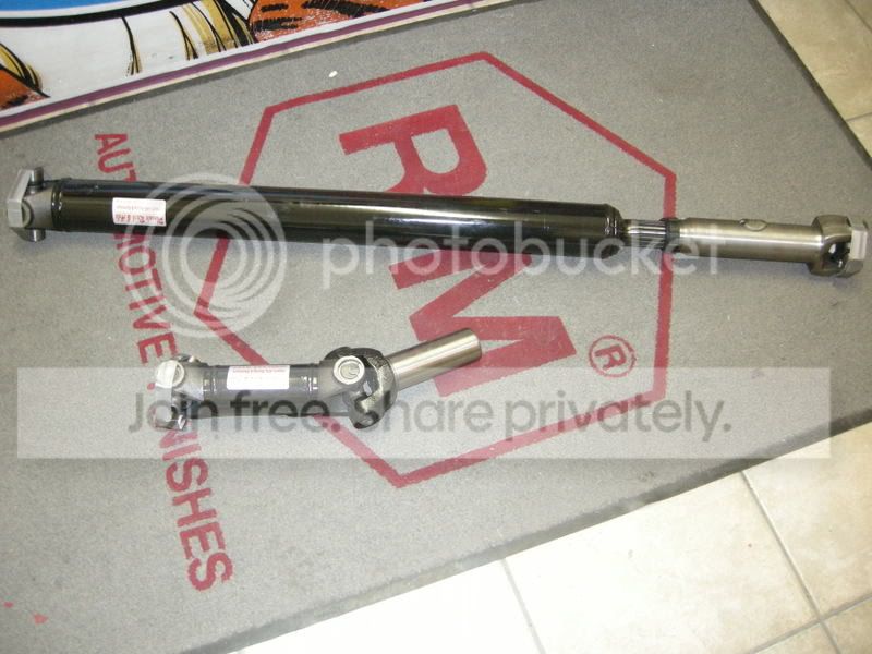

With the length of the crew cab they usually have a carrier bearing for the rear driveshaft. I am just going to swap it so the front will use the carrier bearing. The 205 will be mounted so the rear driveshaft can be one piece. I will just use a factory 1350 np208 shaft in between the cases. I figured it would end up a 2 foot long shaft.
I am also going to try make the front and rear 1480 shaft the same length.
I also have one of the 1480 yokes done. Just need to machine the other 9. 4 for the rear shaft, 4 for the front shaft, and 2 for the front carrier bearing shaft.
